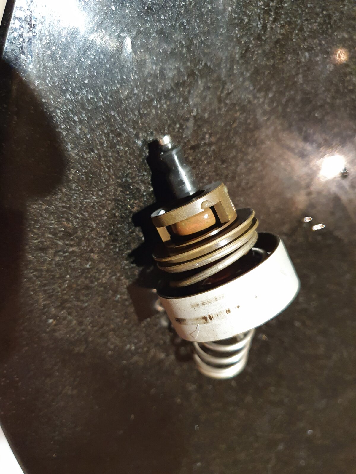

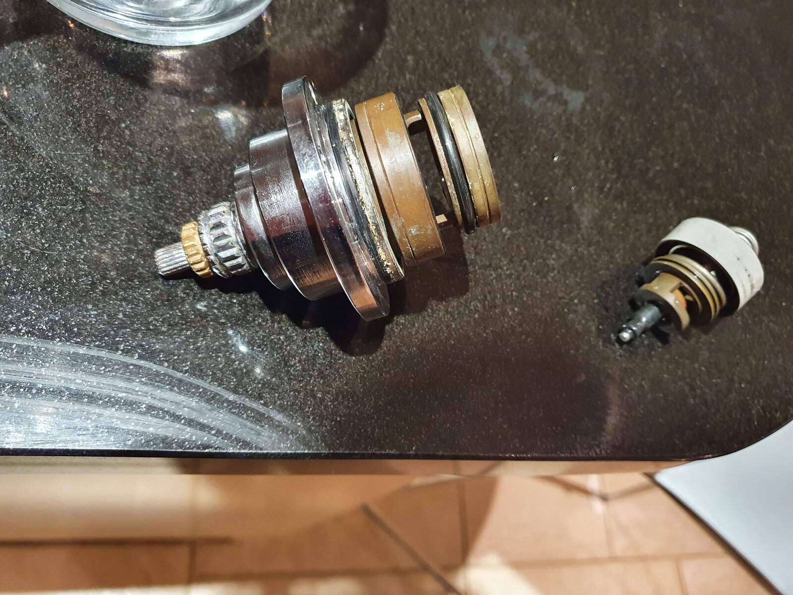

This didn't work unfortunately. Just very hot showers at the moment. The temperature doesn't seem to change at all so wondering if it could be a broken cartridge. Do you know how I can tell? It's a dual one so don't want to spend money on a replacement if it's not broken.

Just grasping a straws - might you have got the two cartridge mixed up?
Another guess - I would guess at the cartridges being similar to a waxstat, or a TRV head. A pin in the unit will change position as the unit is heated up, thus proving the unit is working. Popping the unit in a pan of very hot water should confirm proper operation.
These are the two parts of the cartridge with the one of the right going in the back of the one on the left. It's like a waxstat? Thinking about dunking it in lemon juice overnight to see if it helps any potential limescale. Regarding the pin changing position is it the one on the right picture you are referring to?
I cannot help you there - All I can say is that the general principle of wax cartridges in temperature control, is that the wax in the cartridge expands as it heats up. There pressure of the expansion is then used to operate a valve.
With lots of use, the cartridges can fail and the wax leak out.
On more observation before I give up. Both sides of the shower pump seem to be hot and the little screw valve bleeds hot water on both sides. Also without the cartridge in i just get hot water coming out the void. Could this be an issue with the inside of the pump?
