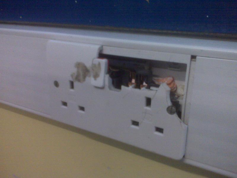

Dodgy Socket
7 Oct 2007
1,043
15
Yorkshire
Couldn't work out the problem at first, but then I saw the sweet wrapper!
Seriously though, found this in a classroom today, teacher says its been like that for months
:rolleyes: :evil:
And that teacher is responsible for children's education ? :eek:
Scary isn't it.
Almost as scary as when i found 110V between the cases of two PC's
On enquiry the teacher told me that the kids had been saying that if they touched them both together they would get a tingle
:eek:
Turned out the CPC for the ring was broken, so the combined earth leakage was there for all to touch.
