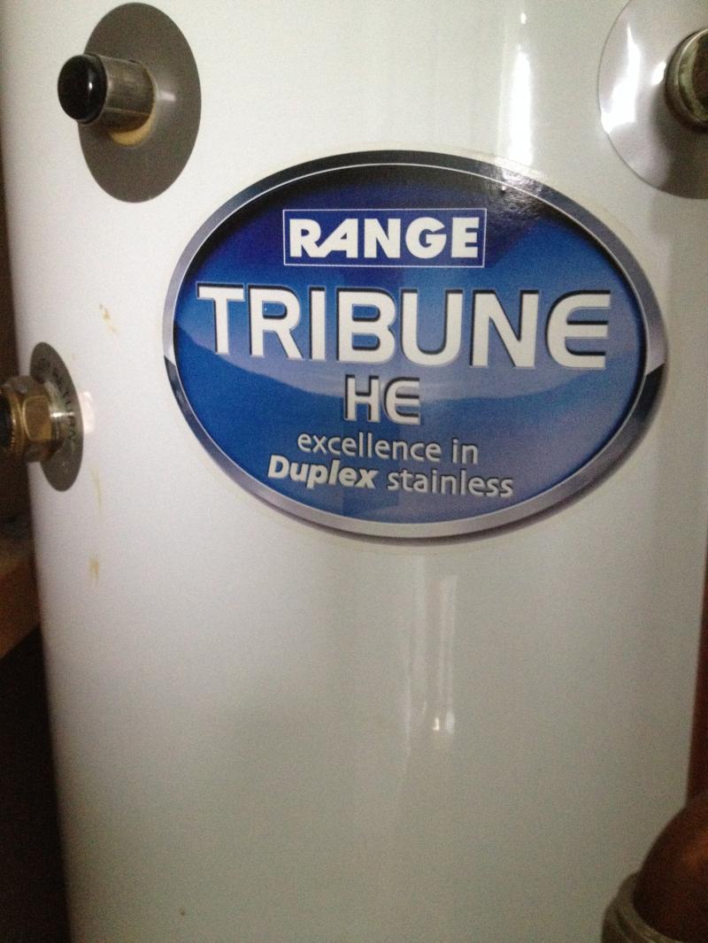

Does anybody understand this, Tribune HE
10 Jul 2014
Sussex
Does anybody understand this, Range Tribune HE.

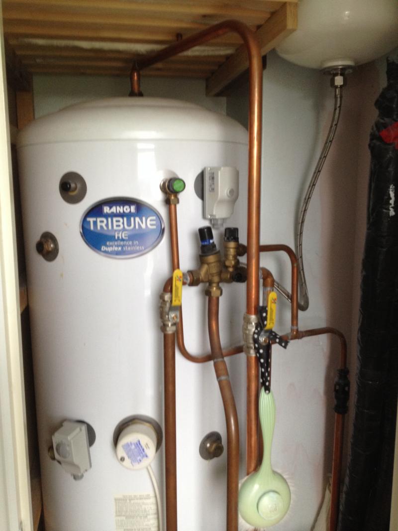

Turn on hot bath get hot water!
Turn on hot basin at same time get nothing, nada !
Expect to see pressure vessel needs topping up but........
no loop just braided line to back of pressure release valve from bottom of vessel, whole lot looks suspect?
Emersion wired but no socket etc, new to house just moved in

not enough flow rate sounds the problem,
could be caused by several things your professional can help you with (UV cylinders are very very dangerous DONT TOUCH)
Made a fair few mistakes in your description, it's clear to me what your thinking but your in the complete wrong area.
I recommend yell. Com. It's full of highly trained professionals with a wealth of knowledge and eager to assist you
Quite apart from the regulations that say that only qualified people should work on unventeds!
Tony
Flow problem of some sort or maybe it's been installed on an inadequate water supply (frustratingly common).
