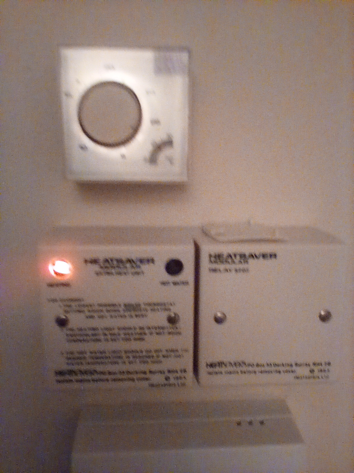

Has anyone come across these units before they seem to be very similar to what are being described above. We have recently moved home and we now have these and the heating only gets luke warm at best all the rads get luke warm no cold spots etc.
