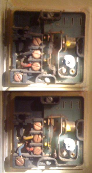

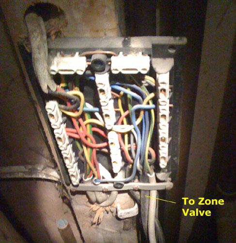

I have just started investigating anew the heating setup at my girlfriend's flat. The heating system is currently bodged to use the hot water channel only of the CH controller, using the controller's timer. The zone valve does not work and is permanently in a "hot water plus CH" mode and the hot water tank stat has been removed from the tank. Thus the boiler and pump just come on when commanded to do so by the controller, heating both water and radiators.

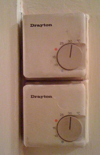

She has two currently disused room thermostats in her hall, mounted adjacent to each other. I would like to get them working again.
Thermostat #1 has one red and one black wire connected.
Thermostat #2 has three wire connections, maybe green yellow and red if I remember correctly.
The thermostats do appear to be powered from the CH mains supply, and are still powered even if I remove the CH controller from the wall.
My initial investigation suggests that the "CH on" pin of the controller wall panel goes to 240V when both stats are turned on. When both are turned off (i.e. down) it goes to 0V. And it seemed to me to be floating around 130V when one or the other was switched on.
My best guess is that these are intended to be "day" and "night" stats with the night one overriding the timer.

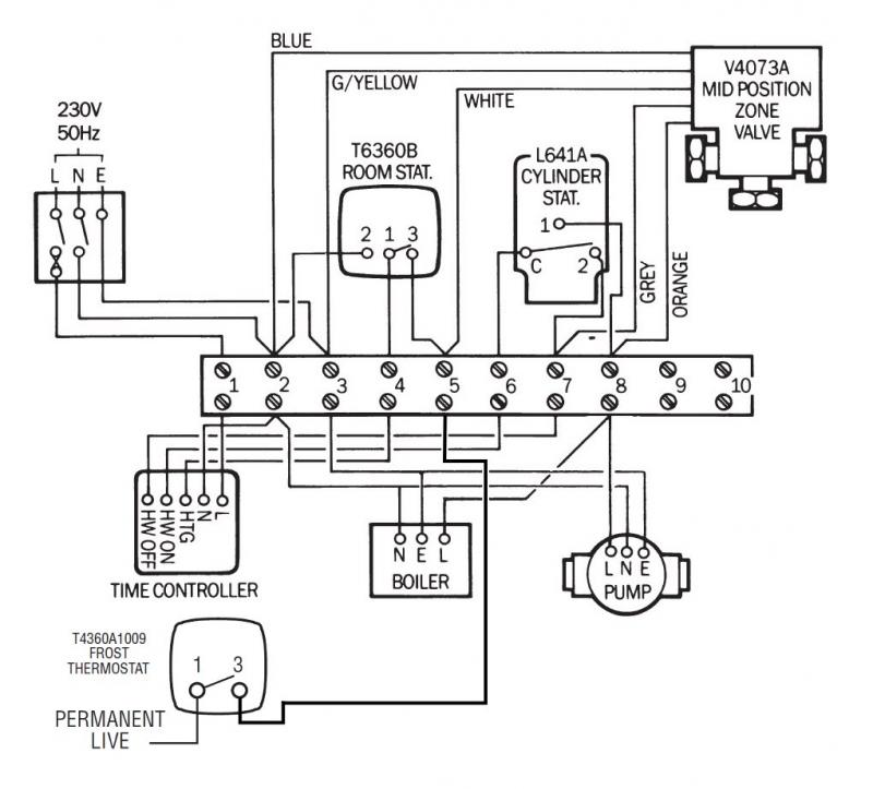

Can anyone suggest a wiring diagram that may have been used here?
Thanks!
Alan
