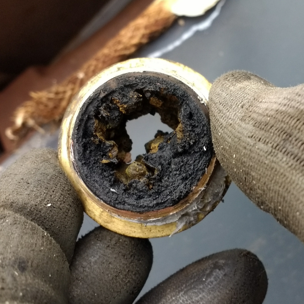

This is one of the connectors from my glowworm spacesaver MK2, which I removed a few years ago. It was still working but I think would have benefited from a bit of a clean out! We had a primatic? hot water cylinder which I think prevented the use of certain chemical treatments. I think heating up the crud will have affected efficiency.
You have a high mass, high water content boiler with little control of air flow, no modulation, simple working options, flat out or stop.
If stopped it will lose any heat from that big lump of cast and water because it will have an open flue or balanced flue that still works when the boiler is off but takes heat away with it.
What else? How is it controlled? Does it work in a co-ordinated way with the system and prevailing demand adapting to changing heating loads.
Can it adjust temperature to extract maximum heat potential from the fuel?
The gaskets in the two part cast exchanger have done 30 years and there is 30 years of deposits in the waterways which may be negligible or substantial.
If you pay a monthly insurance premium for breakdown cover it's likely to be classified as BER or parts unavailable if it did breakdown so that's a cost to be balanced against a long warranty on a new boiler that will need attention in all likelihood and will definitely need an annual service to maintain the guarantee.
