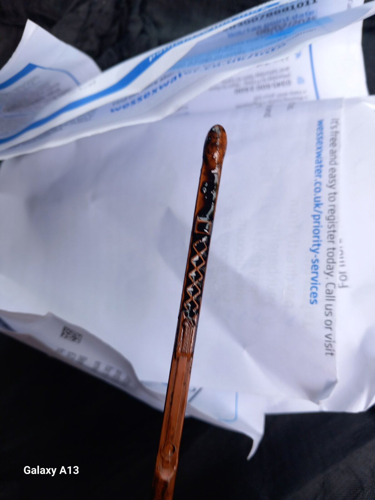

Does the oil look ok?
You can't tell the quality of the oil by looking at a discoloured dipstick - especially on the older diesels.
Maintain the oil level at all times and have it changed, with a filter, every 6k miles.
