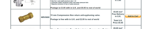

Does such a thing exist?
Scratch that - Just had another look - their 'anti syphoning valve' is simply a non return valve - so it isn't even a check valve - so does not even provide CAT2 protection
The rules don't suit muslims! If you put "muslim" in a search you will find fittings, Cat 5 backflow protection valve, etc. etc.

Islam requires followers to wash after Toileting, the problem in the UK is People want the facility to wash themselves with a Douche, but the issue then arises as many of the installations do not comply with the rules regarding backflow. (Backflow is the possibility of, under fault conditions, water being drawn back into the supply network.)
The Water Fittings Regs classify the risk of backflow from fluids in contact with ablutionary showers as Fluid Category 5 – the highest risk level – because of the likelihood of faecal matter, urine and other bodily fluids being present. Any Douche supplied via a Combi Boiler or Instantaneous Water Heater for example is likely to be directly connected to the mains supply without the required air gap, and so presents a risk of contaminating the Water Supply.
Unfortunately, most want the cheapest option, which is unlikely to comply with UK Water Regs.

Muslims very often ask for a spray head to be plumbed in to the supply to the WC for their particular Quranic ablution requirements, and basically, you can't. Maybe unless there's a high level cistern which you'd think would be OK as there's the required air gap, but I have a feeling it's not, because theoretically bugs could go back up the hose into the cistern, which they can't from the loo pan..
