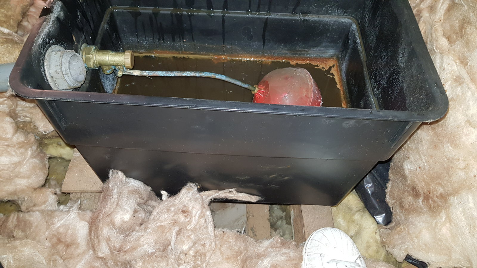

Does the fill level of this f&e tank look about right?
30 Sep 2013
304
6
Lanarkshire
Hi all
As per advice from a previous post I had, I'm going to dose a cleanser through my open vented heating system to see if it improves the water circulation/flow.
I was in the loft today to suss out where the f&e tank was. I don't know much about these but when looking at it I expected to find it more filled with water, I know it needs space for water expansion so may be fine but thought it worth checking.
I had some work done on the system earlier in the year so I'm just checking incase the inlet to the tank was isolated for this but never turned back on.
So basically does the level this f&e tank is filled to look about right?
Thanks in advance
Yes that's fine and as it should be. The water doesn't get used, unless there is a leak and it will be replenished then anyway. As you have figured out there is space for expansion.
But bail/aquavac the water out of it and give it a good clean before you allow that water down into your CH circuit.
