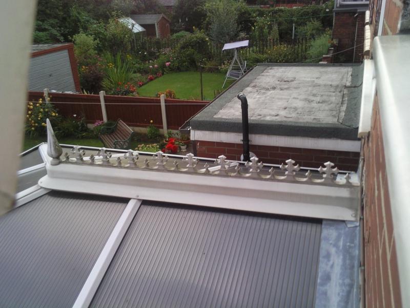

Next door had a new boiler fitted. Its in the flat roof part of the house. The old one was there, fitted before our conservatory.
Our conservatory was built, but this then made their flue contrary to regs (theres a window opener directly opposite where the flue comes out, a 10 inch gap seperates the two extensions - we never opened the window)
So the guy who fitted the boiler has tried to do something about it by extending the flue exhaust upwards as shown in the photo. Clearly this is an improvement, but something about it just doesn't look right. All the windows up top are openers, both next door and our house.
Cheers.
My opinion only; if the flue is on his land it is OK as you have shown it to me. Apure vertical flue through the roof would have been preferable but more expensive.
absolutely fine and very thoughtful I'd say as they've clearly made sure the plume doesn't cause you a nuisance.
btw its called a plume management kit.
Looks absolutely fine. I think you should be grateful your neighbour did not give you a lot of hassle for building your conservatory in such a way that it caused problems for him

It's only since steamers became mandatory that it's not permissable to terminate over a boundary. The flue in the photo is absolutely fine.
