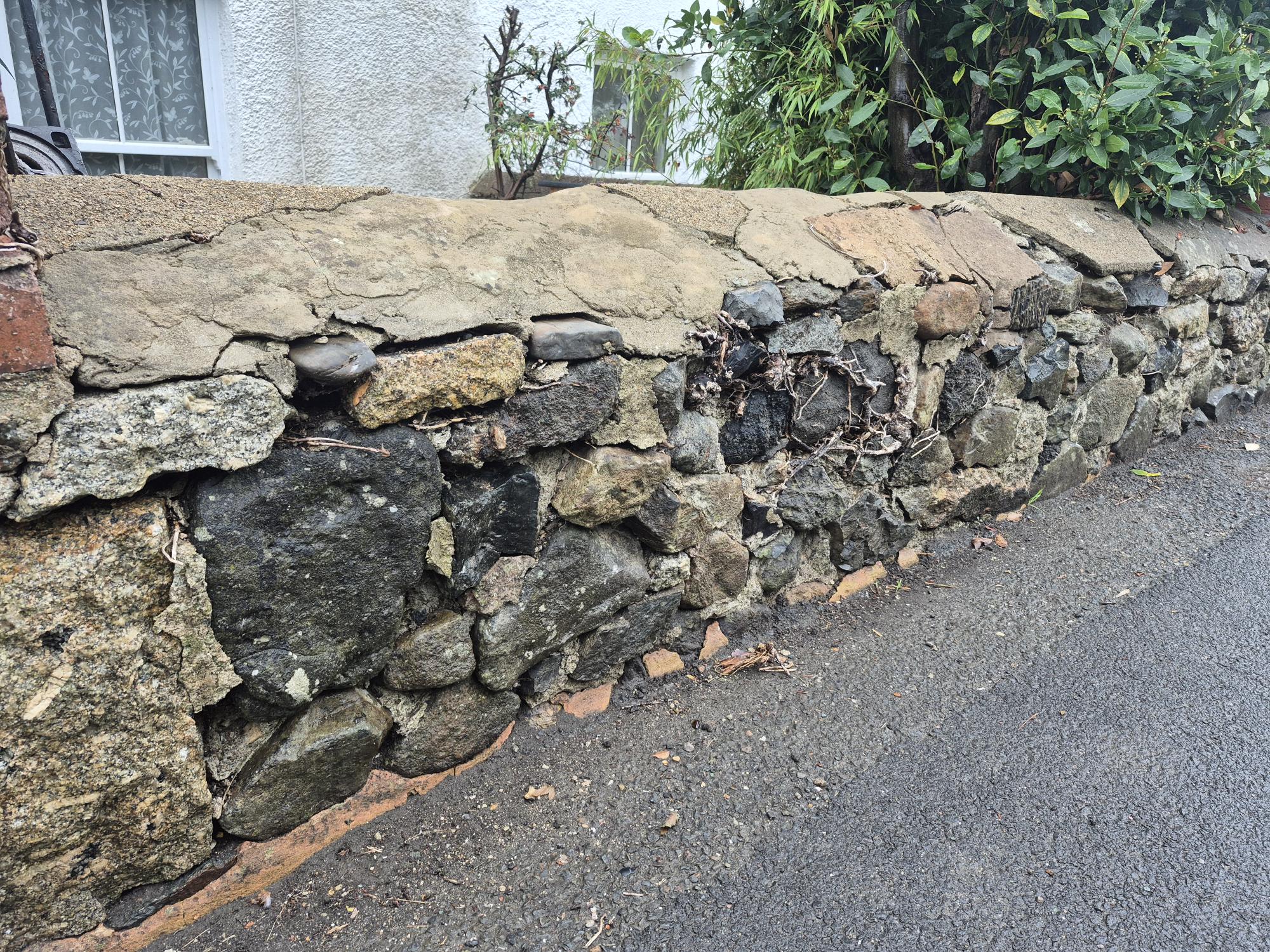

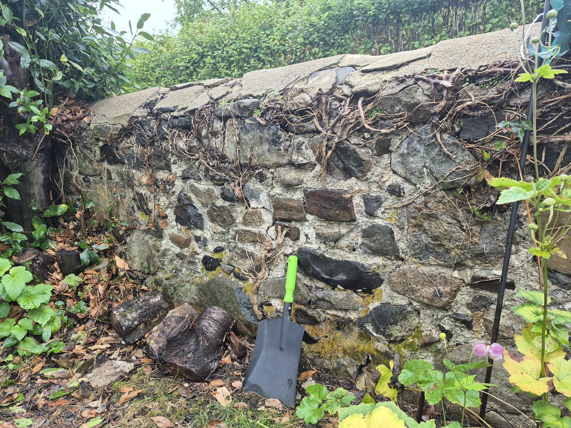

Hi all,
This is my wall which is 4m x 3ft high. It obviously needs some TLC.
Ive been quoted £800 for dismantling/rebuilding damaged areas, and reset stone
Repointing both sides of the wall: £500
Cement capping: £200
Would you say it needs dismantling/rebuilding? And is this a fair quote?
Unless it is leaning or bulging in different areas I would say just re-cap it. It will probably out live you.
Look along it from each end. Check if it's in a straight line and whether it's tipping at all.
If all looks OK then it just needs a tidy-up.
The capping looks bad though. Are there other options? E.g. stone?
Thanks, I dont see any bulging or leaning.
Yes, capping very bad. Unfortunately it will need campping like the orginial otherwise will look odd with neighbouring wall (IMHO)
