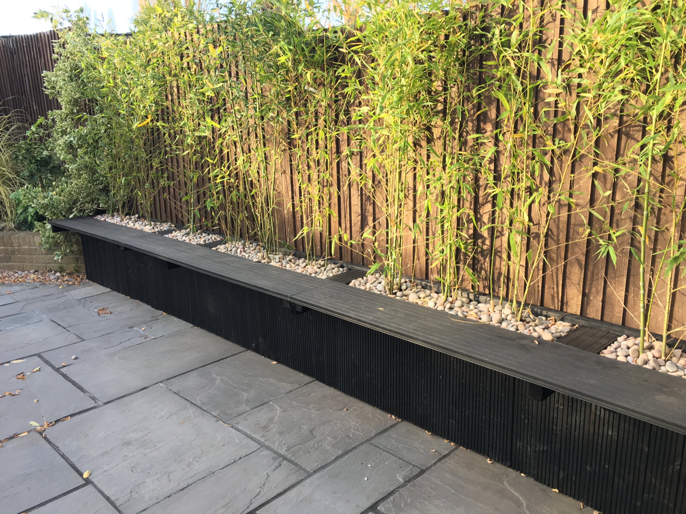

I lined my seat area after using cement boards where contact with soil to slow rot.
that looks brilliant mate. might steal your design with the seating, im making it for my disabled mum so would be ideal for her. question is the cement board the same stuff you use typically for tiling or is it something else?
Yes , standard cement board, 6mm is thick enough. My seat is plastic decking boards, got a few cheap.
