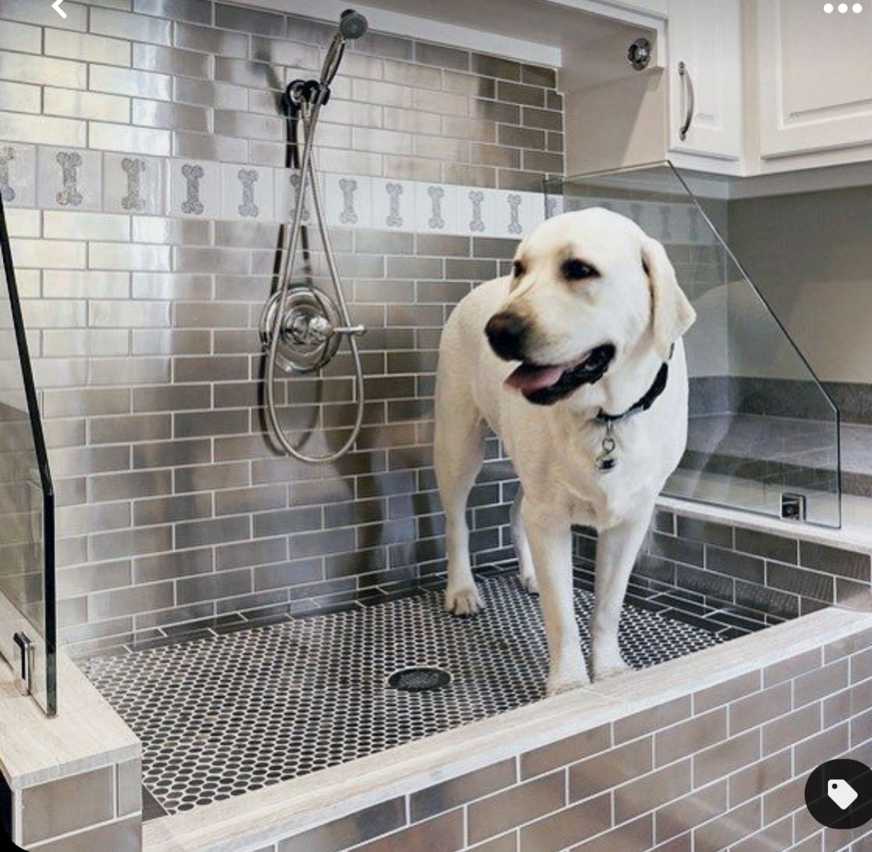

We have had a genius idea to turn our old toilet room into a dog washing station. I thought I had cracked it by finding a fibreglass caravan shower tray but the smallest is around 530mm which won't fit so hoping you might be able to offer some advice?
We have decided to build a purpose made raised tiled 'shower' area (about 45 x 80cm about 400mm off the floor). For the base would you use Wedi board over wood frame construction (and would we really still need 40mm for a 10kg dog over such a small area), or would decent thickness well supported ply be better? If we can't buy a small panel of the right thickness Wedi could I double up thinner sheets using construction glue? Or is there something better that we could use? We will have to pop a drain in it too so not sure ply would work even if thoroughly sealed, and looks like wetroom undertile boards are made of Wedi or similar tile backer board?
I might be over thinking such a tiny area but would like to do a decent job that won't crack and need maintenance or replacing 6 months later :)! Thanks in advance!

Would love anyones advice for the base of the dog shower...particularly with reference to the idea of doubling up thinner Wedi Board (as can only find 40mm in massive sheets which will mean tonnes of wastage).
This is very similar to what we are making...
