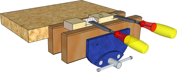

Are there any tips for cutting a good housing joint? I find it hard to measure exactly half of wood's thickness. The wood has a curve on edges which I find tricky to measure.
Sometimes the wood was rocking up and down in the joint. Does this mean chipping a bit out of other side?
That's a cross halving joint, not a housing joint AFAIK. The trick for setting out is to use a marking gauge and check that you have the centre point from both sides adjusting once or twice until you hit the centre. As you've discovered it's all but impossible to measure to the centre

I have one. Forgot about it. Thxs. When cutting the grooves with a saw before chiselling out is it just the case of checking both sides so the saw doesn't go below the gauged centre line?
Yes. The initial chiselling cuts should b made in an upwards direction from the outside to the middle from both sides to remove the bulk of the waste.
The "hump" in the middle is then pared out flat with a good, sharp chisel. Use a combi squere to check the depth for consistency. As an alternative the joint can be easily worked with an electric router and decent-size (12 to 20mm, depending on the router) straight cutter
