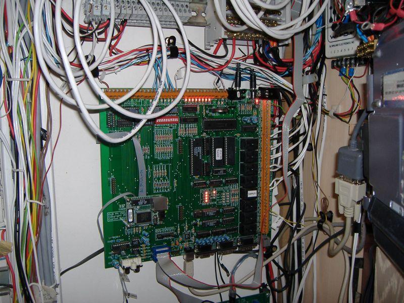

A few years ago I found myself working briefly in an apartment in Monaco - no, it really really wasn't as glamourous as it sounds. 3 days including early start & late return for travelling from/back to UK, and didn't set foot outside between arriving and leaving.
The owner has 'made a bit of cash' from selling a software startup, and this was his toy (well one of them). Basically, everything was electronically controlled - lights, roller shutters, sliding doors, ...
Pretty well every switch simply went back to a central controller, which was a dedicated device sold for the job :
You can just see on the far right the bottom of a small laptop which is only folded down and used for programming the controller.
Then all the lights, doors, roller shutters, even the (magnetic) bathroom door locks are controlled by a large bank of control devices (apologies, but the camera really didn't do a very good job on this one) :
All this lot, and some more, is hidden behind the false back of a large cupboard (the back is itself a pair of doors that open to reveal this).
There is a LOT of star wiring here :rolleyes:
