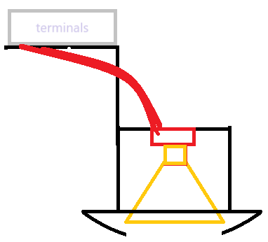

But the voltage to earth can be 230 volt so insulation must be able to stand that voltage.
That's a perfectly valid point as I did measure 230V between the metal of the fitting and the bulb contacts.But the voltage to earth can be 230 volt so insulation must be able to stand that voltage.
Only if each individual light 'knows something about earth', which they won't if they ae Class II.But the voltage to earth can be 230 volt so insulation must be able to stand that voltage.
Exactly - but it is now seemingly being said that lights were probably Class I, with ';metal parts' that were connected to earth. If that is the case then eric would be right in saying that the insulation between the functional parts of the light and anything earthed would have to be able to withstand something approaching 230V for some of the lights.what John means Eric that the voltage difference to each light is about 12v it is just their references that are different, like the xmas tree lights we`ve used since the year dot. just a volt or three across each one or whatever, the two ends that are 240v apart would not know it, just the number that can be simultaneously touch, and if the insulation holds then nobody would know. ... If you stacked a thousand button cells up in a tower fashion, one hand would not know it, two hands a distance apart might get a message ... If nothing is earth referenced then who would know?
But then do a squarewave ac test at 1KV and see what happensMind you, I tend to laugh a bit about the excitement that often exists about 'voltage ratings', since almost any credible thickness of the sort of materials we use as insulators will withstand very high voltages - for example, things like 'signal cables' that are 'rated' at, say, "50 V" will usually show unmeasurably high IRs even when tested at 1,000 V
Kind Regards, John
I don't have the means of doing that - but what do you think would 'happen' (and why?) - and what sort of frequency did you have in mind?But then do a square wave ac test at 1KV and see what happens
That's would certainly be my expectation, which is why I look forward to hearing what he thinks might 'happen'!Nowt would happen, unless the cable were faulty.
Indeed. Although 'assuming' is always dangerous, I would think such to be by far the most likely situation - so, as I've said, if they are designed to run off 12 V and if there is no 'earth' (nor any LV live connector) present at the lights, then there would be no need for insulation in the lights to be able to withstand more than about 12 V (although, as I've also said, I'm sure that, in practice, it could 'stand' and awful lot more than that!).I‘d assume the lights were designed to be class 3 run by a 12 V safety transformer.
