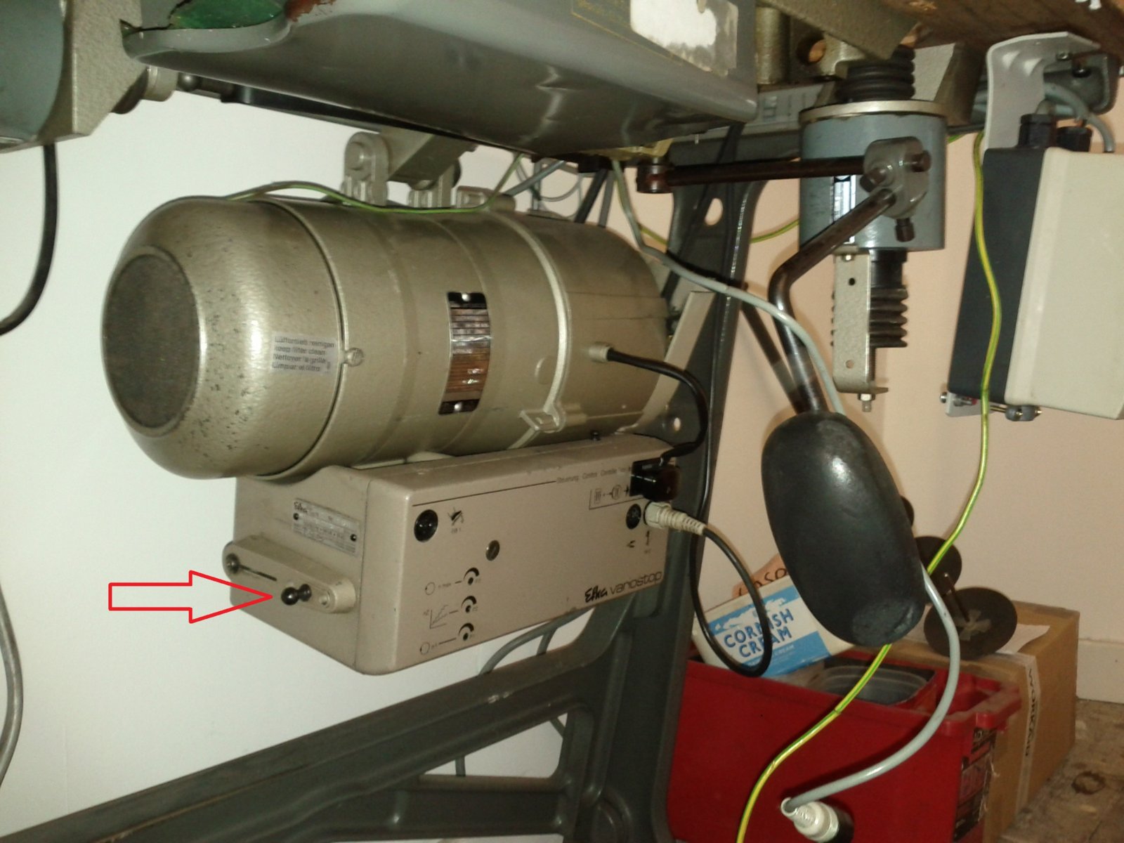

How do I determine this? The machine speed must me controlled by the existing foot pedal which is connected to the lever on the end of the rectangular box under the motor (see photo – nb. the connecting rod is missing).
If you are thinking about directly controlling this existing motor with a new inverter, make sure the insulation class of the motor windings is adequate for the voltage stresses a new inverter will impose, caused by the rapid switching of the drive outputs.
No, I want to retain the existing speed control box and control the machine speed with this via the foot pedal so can I discount this comment? If not, how do I determine whether or not the motor windings are up to the job?
Bernard reckons the motor has an electromagnetic brake. Is that a separate supply? Or is it taken from the motor winding connections?
I don’t know I’m afraid. How do I tell? As far as I can see, there is just one cable going into the motor and that is from the speed controller. All I currently have to go on is the what’s on the data plate above. I'll take a photo of the other data plate shown in the red star above but I'm afraid I won't be able to do that until next Tuesday (nb. that data plate is on the speed controller unit).

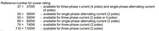

Here is a technical sheet on the motor https://www.efka.net/fileadmin/downloads/VarioStop-Antriebe/5G82BV2304/EN_TY_5G82BV2304_140600.pdf I'm not sure if this helps much.
There was a firm that specialised in used machines called Rossendale Sewing Machines a guy called Terry used to run it, very clued up, might still be around
That was my interpretation of the info on the sheet but my motor is a VD552 with the 'D' indicating 3-phase and the '2' indicating 2-pole. There's no chance of me finding a single-phase like for like replacement (a VE552).
The motor is only part of the system, it works under the control of the box underneath it. Together they provide some or all of the following functions

SPEED RANGE: 70 RPM up to 9900 RPM (depending on machine). suggests the control box has a variable speed motor controller / driver built into it.
If this machine was originally installed as one of many in a large sewing room then a three phase supply may have been used to ensure the electrical load was spread evenly over the three phase no matter how many machines were being used. There is a small chance that the motor and control box could run on just one phase if the AC input is rectified to a DC supply for the control box's variable speed motor controller / driver .

You're absolutely right. The functions you list are set and controlled from yet another box of tricks which is under the left side of the table. This is disconnected at the moment and I'm not to worried if it didn't work as a result of fitting an inverter. These functions are far more sophisticated than I need for my purposes eg upholstery, car seats, boat canopy.

I think that's how this one works. As soon as I switch the power on I can hear the motor running. It's surprisingly quiet.

I would be very reluctant to connect a motor inverter directly to that motor, it's old and very unlikely it's insulation is suitable for inverter operation, and it will fail.
Similarly I would be equally very reluctant to connect a motor inverter to the controller. I doubt those old electronics are going to enjoy the high frequency switching outputs of the inverter.
If you can find a pure sine wave single to three phase converter then that would be the way to go.
