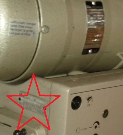

Apologies for the delay. Here is the data plate on the speed controller...
Does the power cable for the motor come from the speed controller box or direct from the starter (red and green buttons). I'm guessing the latter with a piece of grey YY cable.
The motor is off the machine now but both are at the workshop so I'll take some more photos when I'm back in there. From memory though, the cable from the on/off switch goes into the back of the box under the motor.
Could it be that the motor is driven by 3-phase but the speed controller is running on 240V single? Is the speed controlled by an electrically operated clutch? I'm going to have to strip it down to find out. I'll post up photos when it's all apart.
What I'm accustomed to is the speed controller and motor being bolted together as one unit. The power goes from the starter to the speed controller (as you describe) and from there to the motor internally, so it may not be visible.
The clutch unit (being the unit which is more likely to be removed for repair) has an easier method of disconnection, in this case a plug.
The box will most likely be running on a single phase but it's just as likely all 3 phases are routed there for the motor.

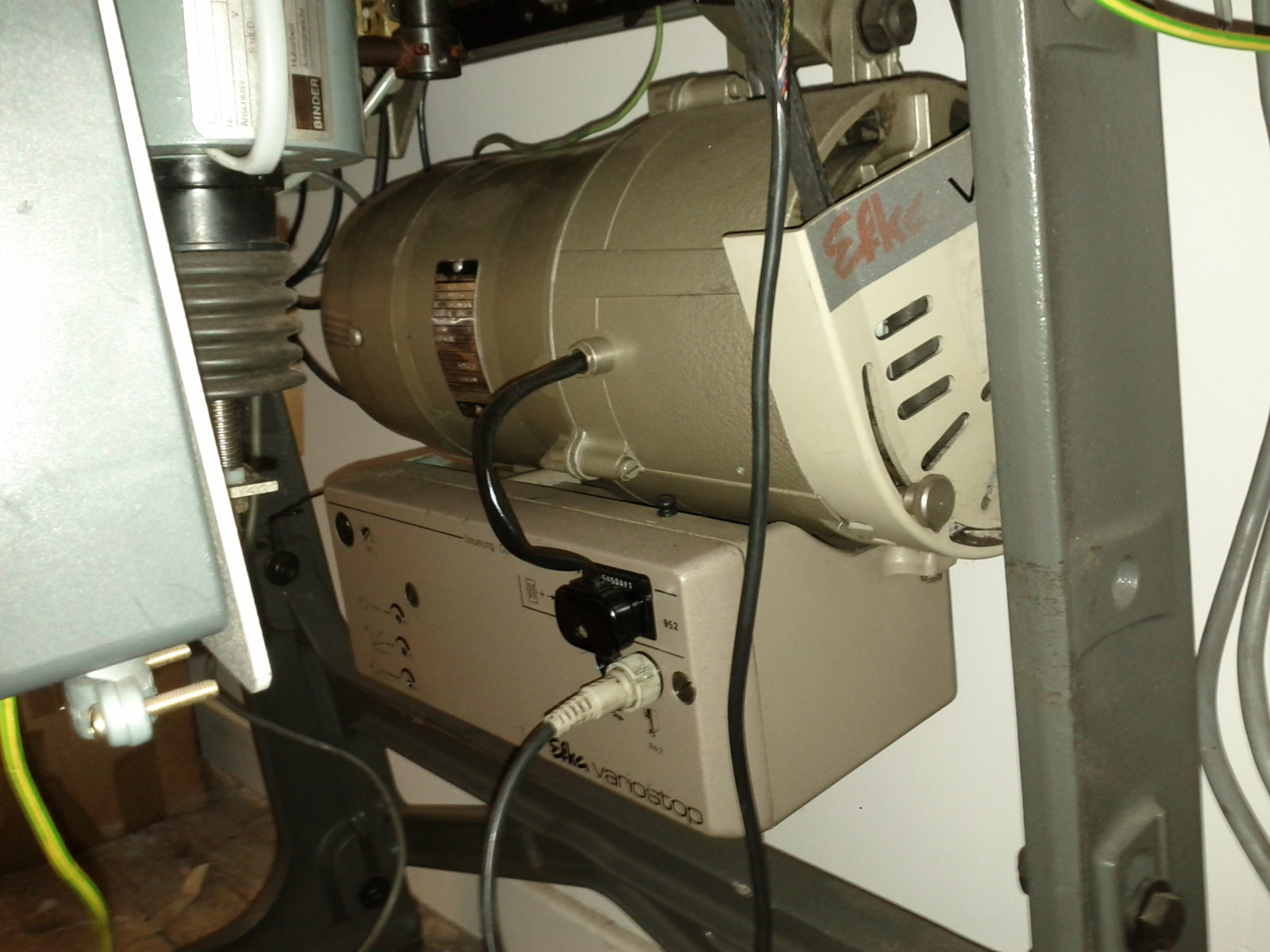

Here's a photo showing a black cable coming from the control box to the clutch area of the motor. There was a thicker grey cable from the on/off box to the back of the motor/box but I haven't got a photo showing whether that goes into the rear of the box or the rear of the motor. My memory tells me it goes into the connection box on the motor.
Can you see the grey cylinder with the bellows (top left in the photo)? This is connected electrically to another control box (not the one in the photo) which is in turn connected to the box you can see in this photo. It looks like a solenoid powered ram. Have you any idea what it's for? There is an identical unit mounted horizontally underneath the table to the front of the sewing machine but that's not connected to anything mechanically either.
Looks like the rod coming out of the unit is threaded, so maybe a motor driven screwjack (powerjack) for adjusting table height? Dont know if that adjustment is a thing on sewing machines?
That cable up the centre of the photo is damaged.
