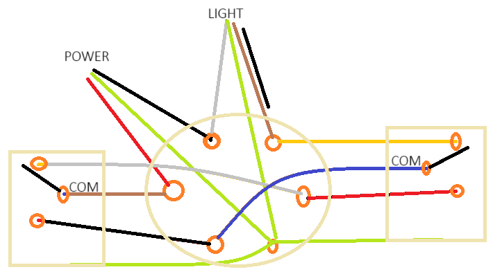

A smaller black burn mark on the ceiling each side of the chrome MR16x3 halogen/toroid fitting which I knew to be left by previous occupants. I removed the fitting and switch but had never seen so much damage on a lighting circuit before. the cable at both was too badly melted to re-use and badly blackened, giving the switchdrop a tug it felt like it was loose in the metal capping.
Just inside the loft I found three 6 terminal JB's and traced the light cable to the one wired like this:
And quickly able to disconnect the feed from the adjacent JB so power could be restored to the rest of the property and added a strand from 7/0.2mm wire for the lighting fuse. I was able to readily grab an offcut of 3C&E and a used batten holder from home, still containing the CFL. I was able to pull the new cable into the wall and wired the switch and more easily replace the cable to the light (again with 3C&E).

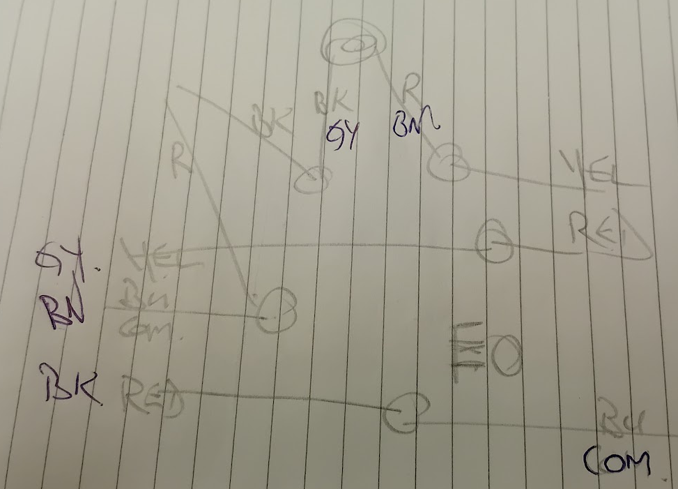

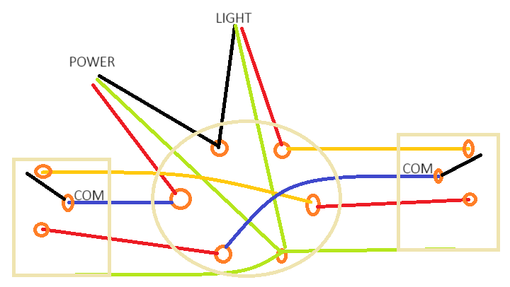

Sunray scratched his head for a few moments Wondering what I'd done wrong as only one combination of switch positions worked, my led screwdriver soon told me yellow and blue required swapping.
Getting home, my rough sketch convinced me it was wired incorrectly before I got there.
