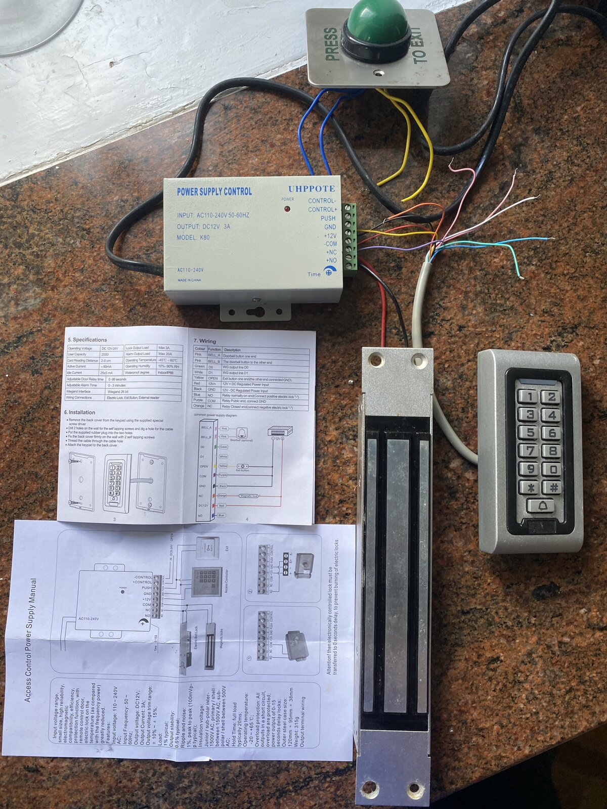

Hi guys
I’m getting really confused setting up this system, I’ve got two guides which are in the photo.
Can anyone please help me wire this up with which wire goes where ?
I had it all set up a year ago when I was first testing it and it worked great but over the last year it was all pulled apart by my 2 year old daughter and I can’t for the life of me work it out again…kids
Any help much appreciated
Great thanks Sparky
Which wires do I use on the green push button, there is 4 wires which is confusing me ‍
If I don’t need any other outputs from the cream ACU box apart from the 12v could I just use any 12v PSU and discard the ACU box?
Thanks again
Two wires will be closed going open , two will be open going closed , you will use open going closed , I normally use a psu with battery back up as the mag lock will be open in a power fail …
