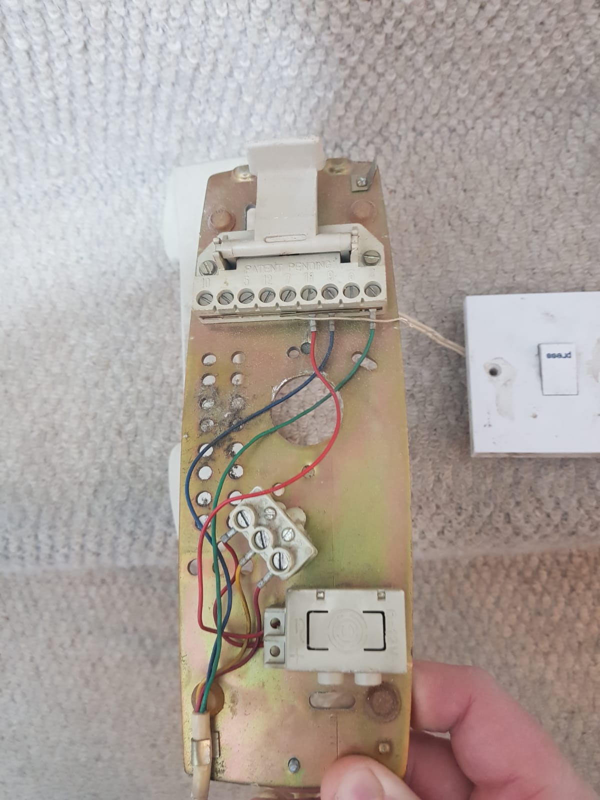

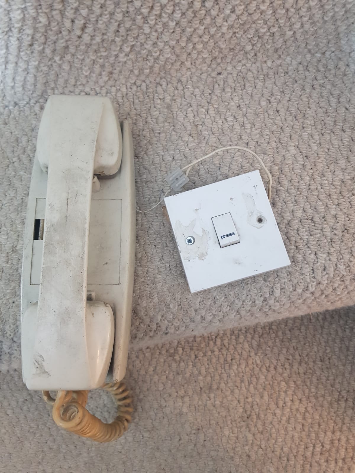

One of my client is having Seko LT Handset in his flat. Could someone please suggest new handset compatible with Seko LT handset?
Regards
Many thanks

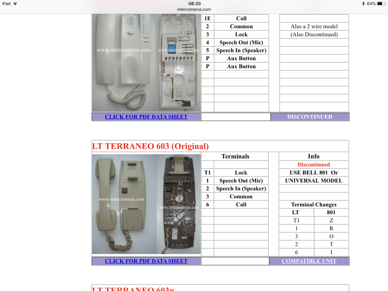

40E6FE8D-43E6-484B-85DF-61002D4E34B0.png Look on “intercoms r us “ they have a very handy handset finder section
I believe they are Legrand branded now
