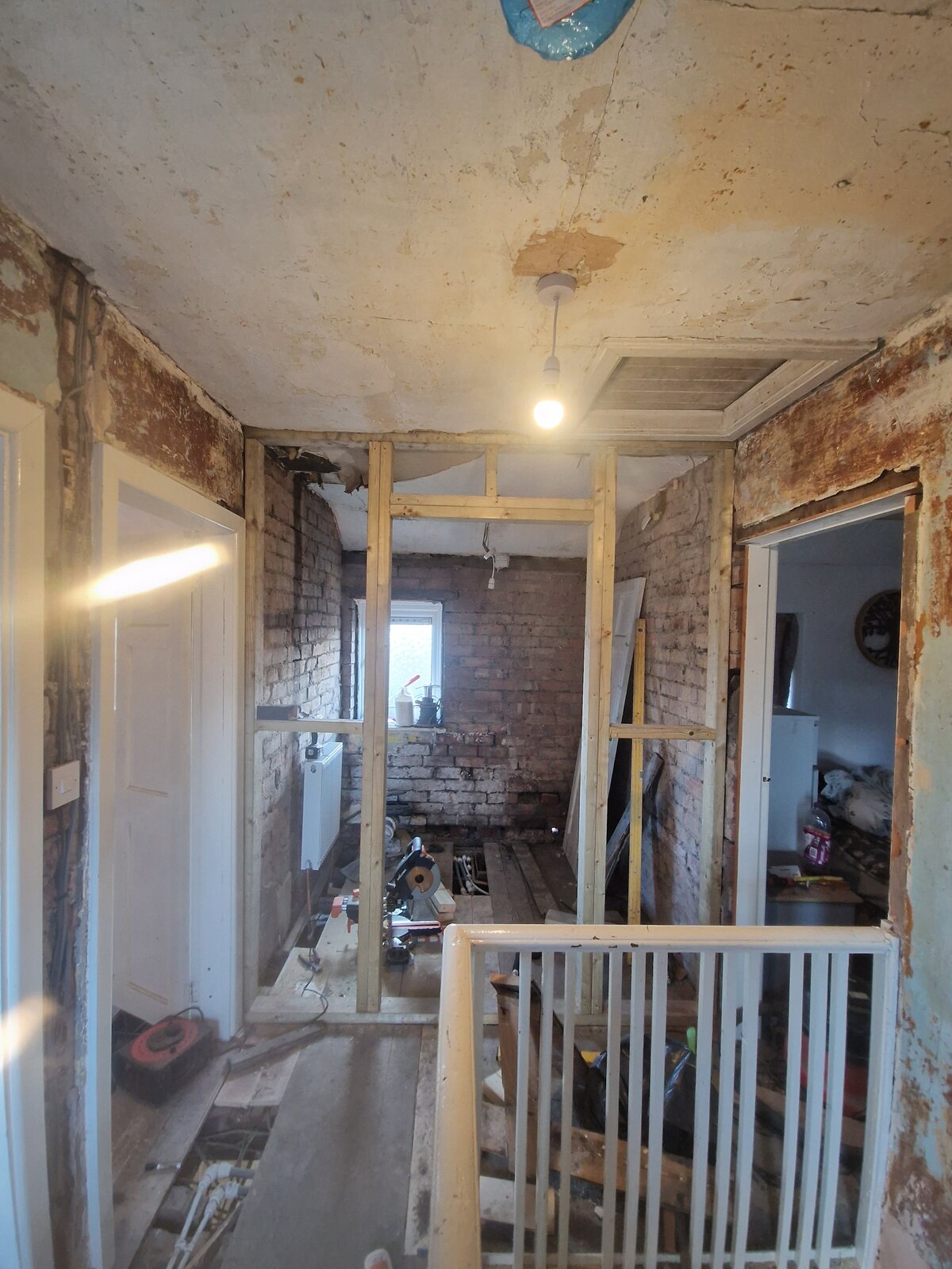

I have built a door frame for my stud wall and doubled the header. I've made a rookie mistake and measured the door height before cutting out the bottom plate...
Will I be okay to add a 3rd header as the way I have screwed it together would take longer than necessary..

Judging by the other door head heights you will be ok - but dont guess: measure.
You need the FFL height and the height & width of your door - you cut & fix the lining to suit.
