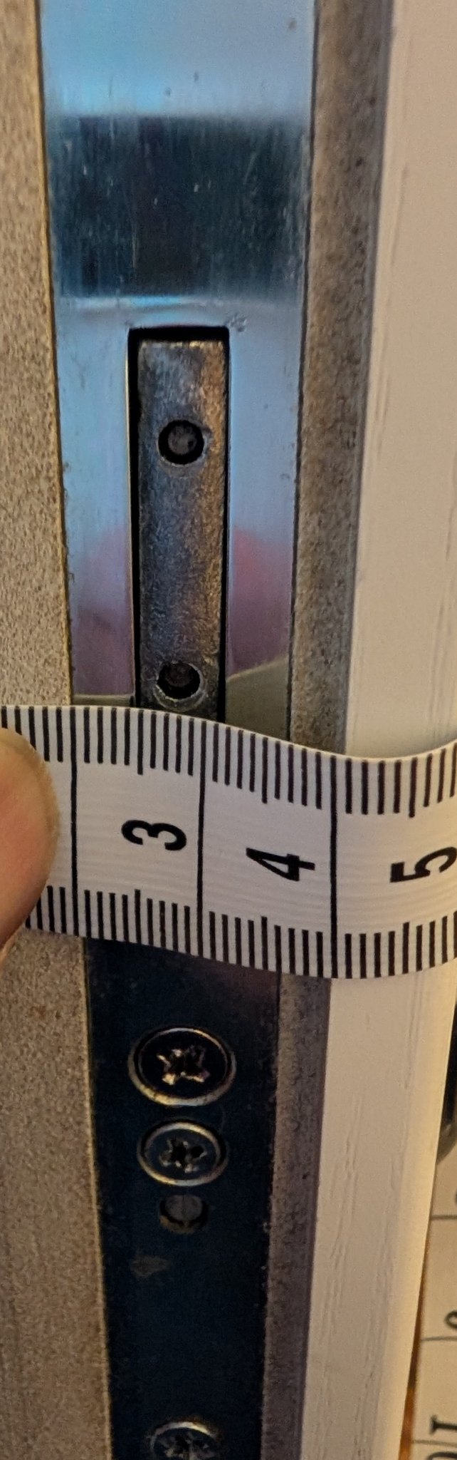

Yes dead easy but you'll need to identify the make of the mechanism first, look up and down the strip for any makers names, the only head start I can give you are the dimensions, backset is 45mm and PZ is 92mm

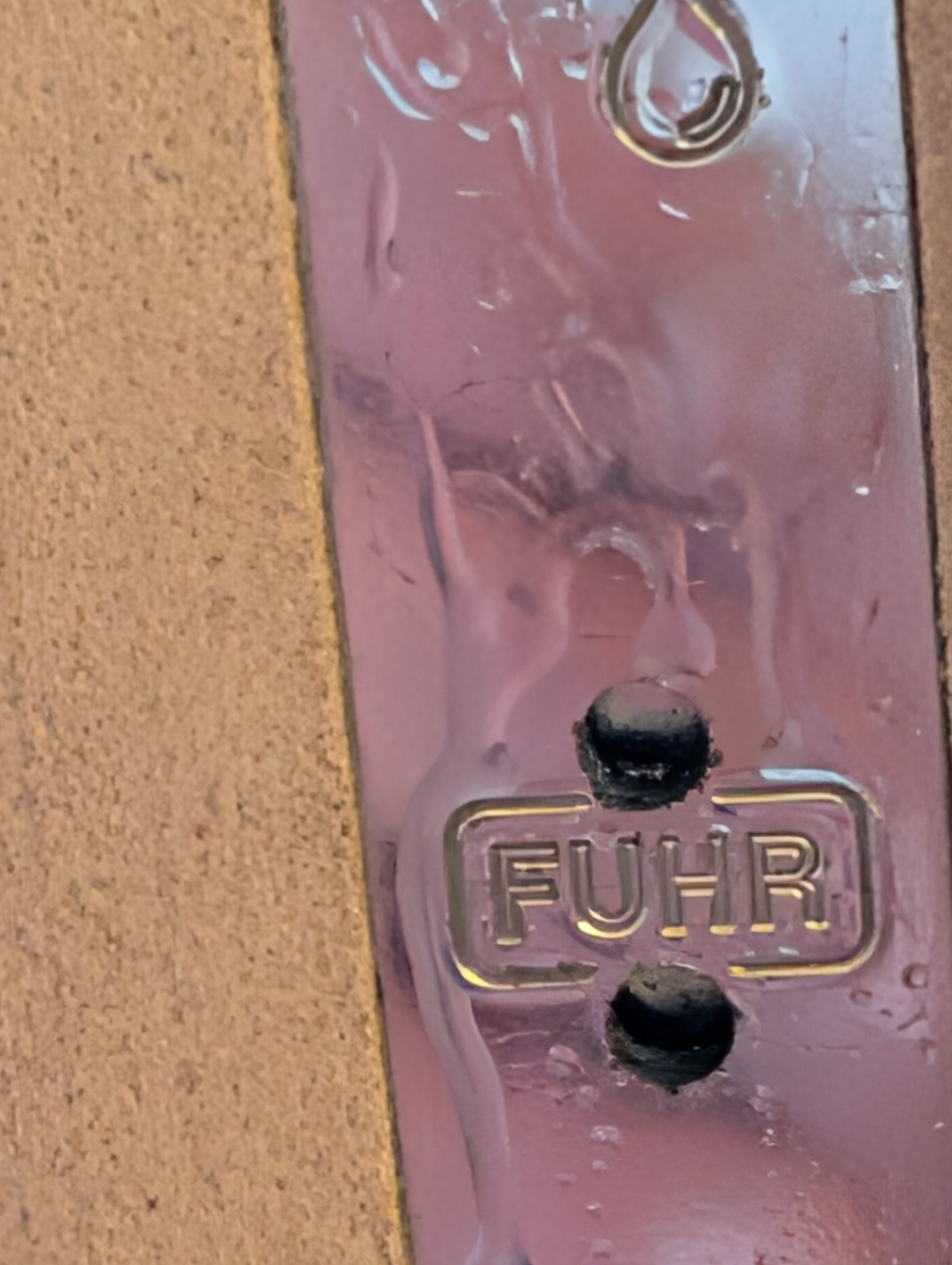

Thank you. It is a FUHR. Is the offset 45mm or 35mm? Pic below.

Ok so it's a FUHR. The tape measure is irrelevant as we don't need the complete locking strip, just the gearbox and as I've said will be 45mm backset and the PZ will be 92mm, with those measurements you can Google for FUHR gearbox, there are a few versions so best to remove your mechanism from the door and match it up online
