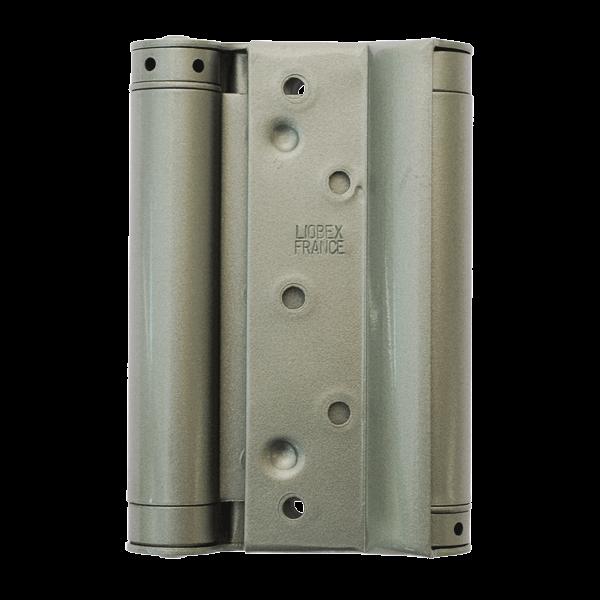

I need to fit a wooden internal door in the centre of the frame.
Can anyone please advise on some sort of hinge that allows mounting of the door in the middle of the frame.
Cheers
Paul
the frame thickness is 80mm. The door thickness is 40mm. I need a hinge that allows a gap of 20mm from the edge of the frame to the door, then the door of 40mm then a gap of 20mm from the edge of the door to the back of the frame

Standard doors are always fitted to one edge or the other of a frame because that works. Trying to get a door to fix into the middle of a casing with butt hinges would be an exercise in frustration - or more likely madness.
The only time I can think of where you'd centre a door a casing is on doors such as double swing doors (i.e. they open either way), as used in places like restaurant kitchens. These doors are hung on what are colloqially known as "bomber door hinges" (actually incorrect - they are double-action sprung hinges) in this part of the world:
To prepare the door casing for these a 1-1/2 to 2in thick timber batten must be fixed to the hinge side of the frame/casing which is approximately the same thickness as the door. There are a number of other things you need to do to install them, including radiusing the front edge of the door because the clearances are generally not all that tight and the knuckles will have to be chopped back into both the door and the batten. In general you install these as 2-door sets, and as B-A says, they will hit the casing/frame at the end of travel so you need to install door stops on both sides to limit the travel to about 90 degrees and so prevent this. Was that what you were after?
thanks very mych for your help people. I may in fact go for the bomber hinges. It is quite a difficult situation I have to engineer around and these may just help. thanks very much indeed
All I can say is be prepared to hack big bits out if the door - oh and watch your fingers when you are tensioning them. Good luck
i would expect the need for a good solid door not a hollow core door but j&k will correct me if my thoughts are wrong :D
Good point! No, you are quite right. I've only ever used these on solid core doors (chipboard, laminboard core, etc, i.e 30 minute fire doors and better) or solid wood (frame and panel) doors. The spring pressure in them means that a hollow core door would just get ripped apart in short order IMHO, as I suspect would the thinnest B&Q 4-panel cheapies
