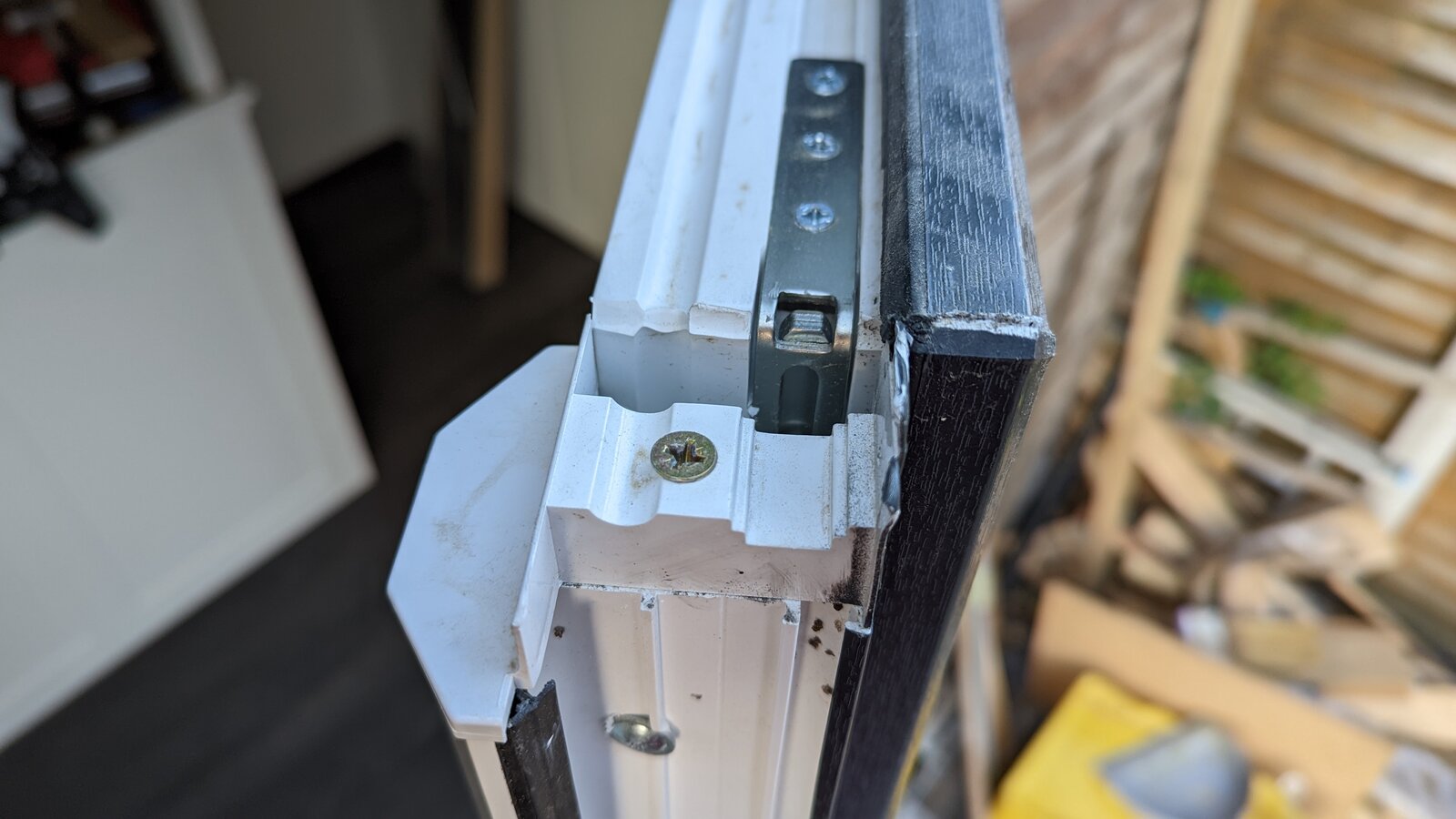

Hi
Just wondering what this is and can you buy them? See pic thing with screw in it you have one top and bottom of door
Its called a shootbolt extension for a door, windows versions are different
Unless you mean the white thing then its called a mullion end cap, these are specific to the pvc profile so they aren't one size fits all, you need to know what system you have, using my spidey super powers to me that looks very much like eurocell profile
Yes it is a eurocell door and yes it is the white thing it also has a coloured front to it that does seal a little gap, do you know if they sell them?
Eurocell themselves won't sell them to you but rather point you in the direction of their approved network of fabricators. I guess one of yours has snapped and is letting draught in? Also pretty sure they just paint the outermost part to suit as well
Yeah you can see a tiny bit of daylight through the bottom of the door, I might try and repair it
