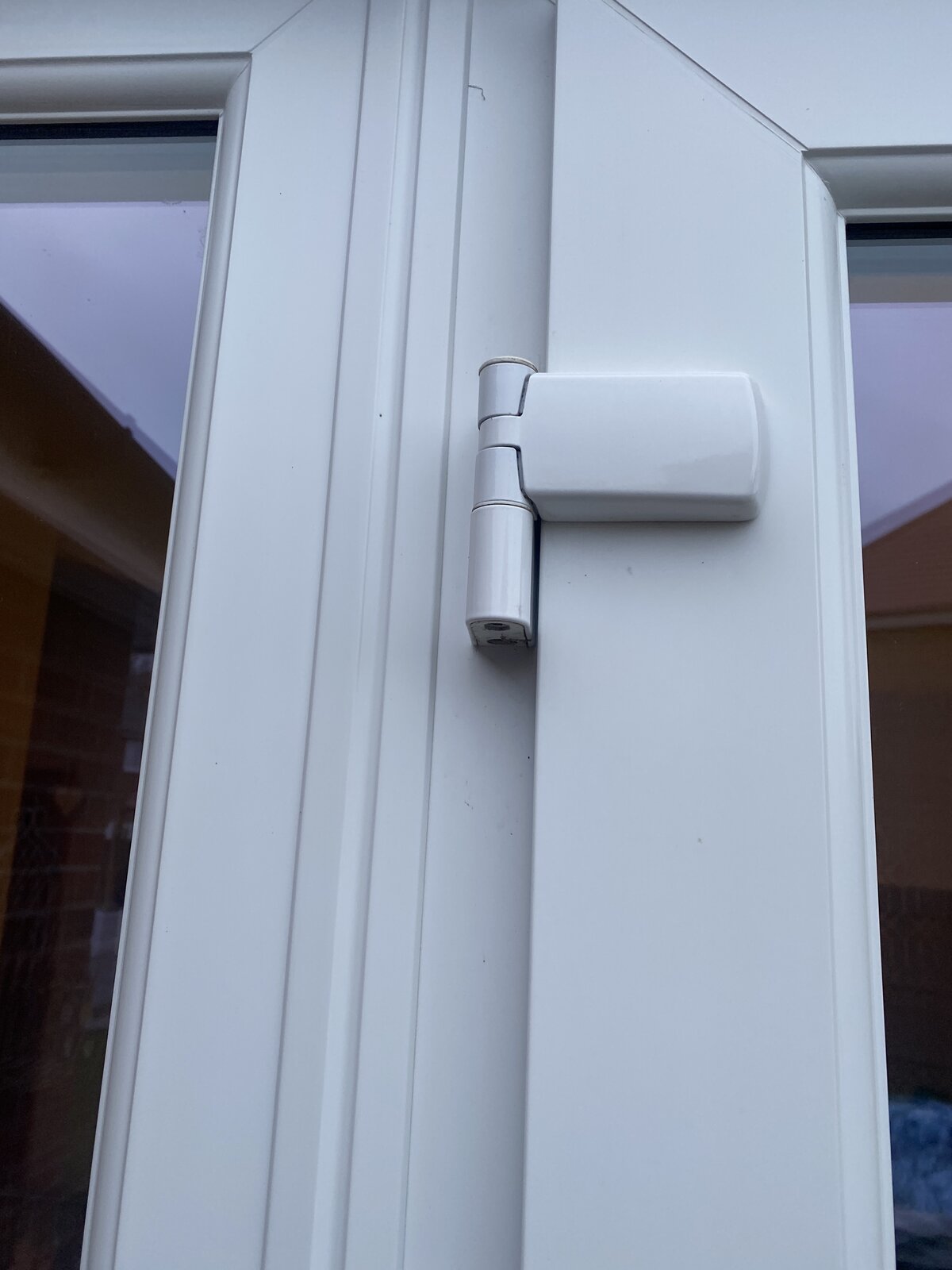

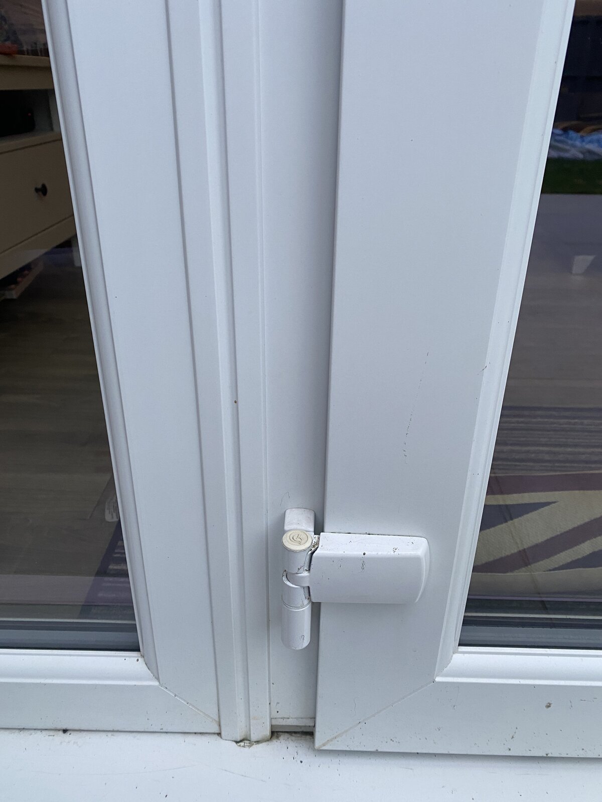

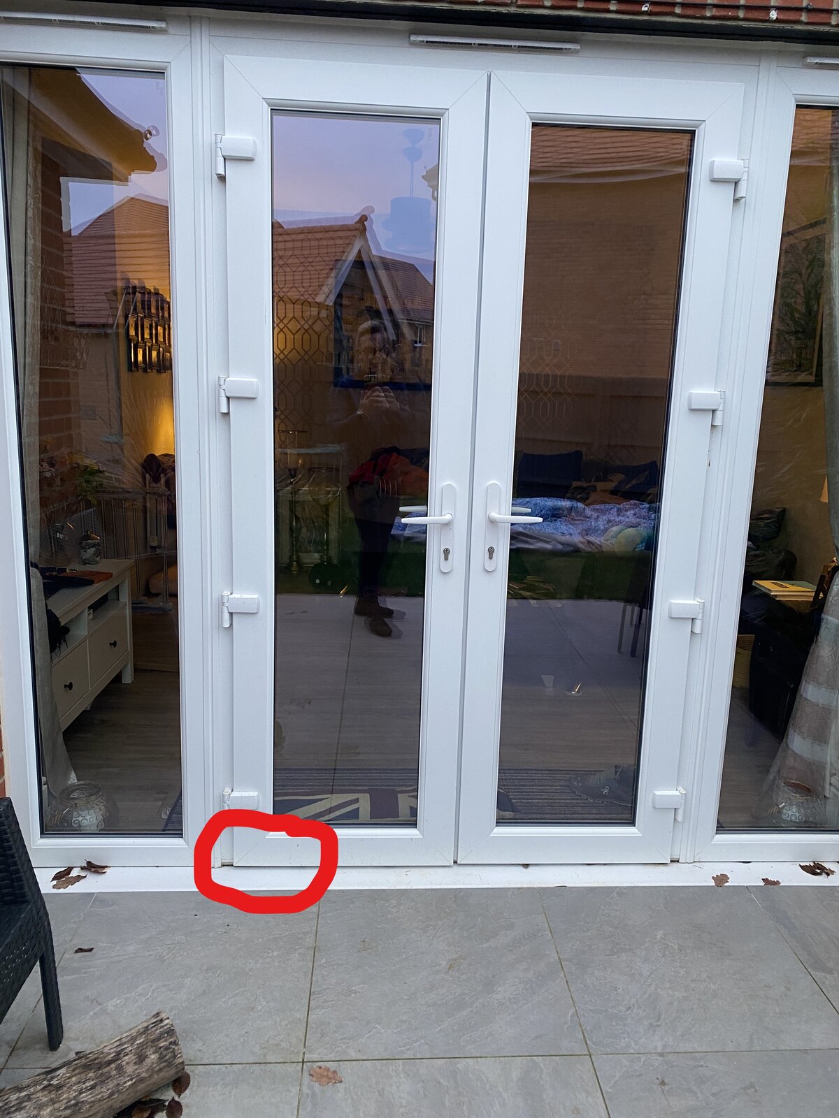

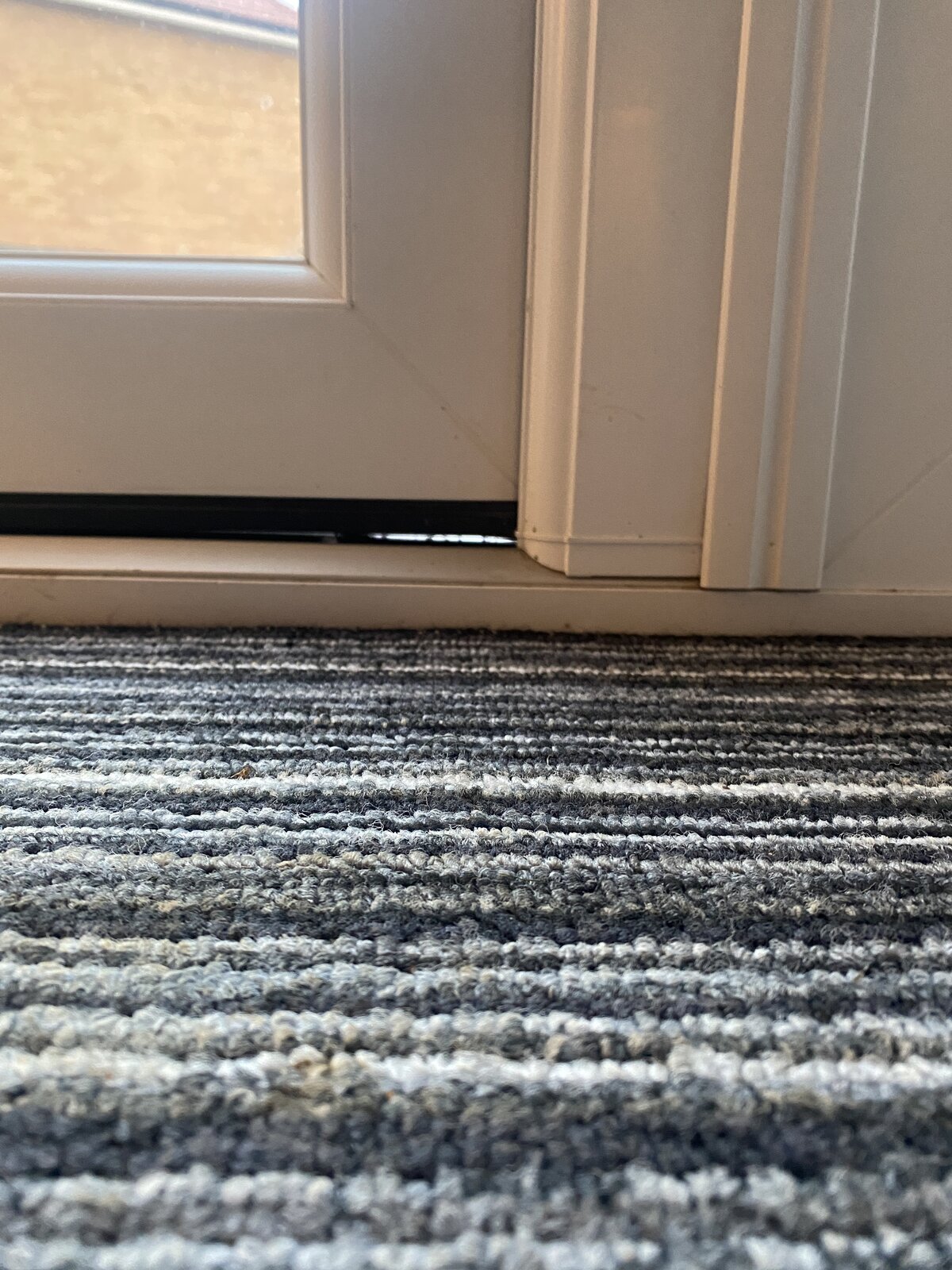

My 6 year old patio doors have a gap at the bottom as seen in the pic below, can I adjust using the various things like hinges and door cams or has the door just been fitted badly? I'm in a new build and it was generally badly put together

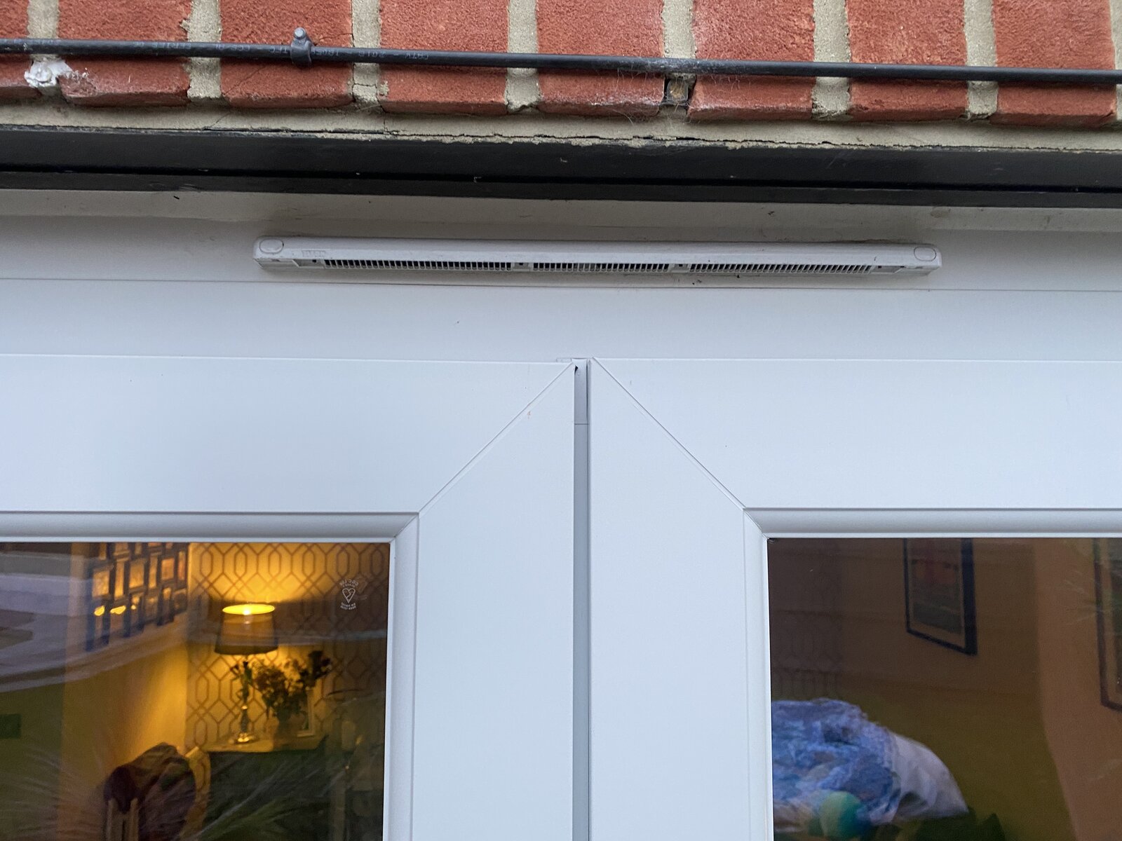

I've attached more pics. The doors do not line up at the top, is that my main problem? The red ring is the area on the door with the gap, the hinges look like they have already been adjusted to pull the top left of the door close in and push the bottom out, if that makes sense!

Check the diagonals of the door and see if the door is out of square.
maybe the glass hasn’t been shimmed properly.
the cill may not have been packed properly abd when screwed down has pulled down a bit.
or frame is fitted out of square.
You can try altering doors to see if the hinges alter enough to close air gap
As a service engineer I can already see a few tale tale signs the door frame is fitted out of square, on new builds thats going to happen 9 times out of 10
