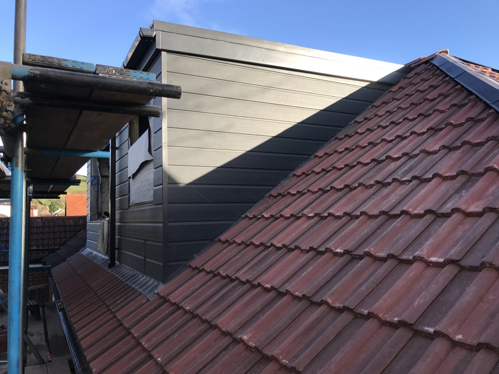

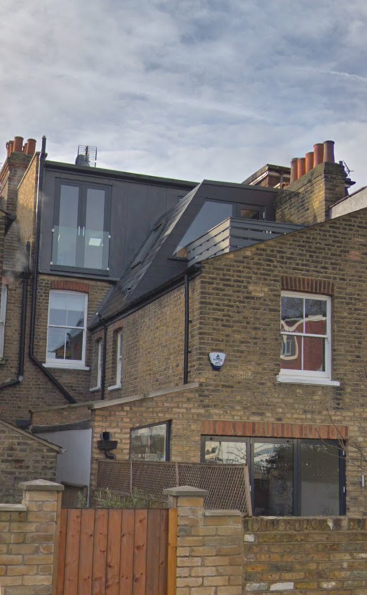

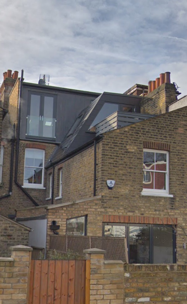

From a looks perspective a setback is better.
We had similar done, the room inside is massive and the dormer from the back garden looks like a tower although with yours being a bungalow that might not be the same.
Couple of pics:
Thanks. With the single storey extension i think it would hide the set back to some degree in anycase. My main objective is to create space. Aesthetics are important but not priority so we are looking for a compromise.
FWIW, here's one without the set back. I think it looks just fine.
