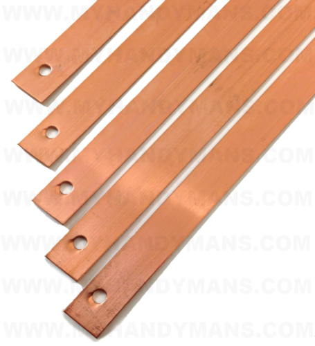

Hello,
Got woken up last night by a crash. Discovered this morning, a tile had fallen from the side of the dormer. No idea how or why. You can see the nails came out with it and everything.
Any suggestions about how to repair / fill the gap without having to remove the fascia?
I would think you would have to remove the facia to see what you are going to fix new one to. May be tile batten under neath has split. I think you might also need better fixings than the old one had, it looks as though it will be really exposed to wind in that particular position.
Looks like it was fixed at one hole. The excessive load resulted in that hole failing.
more likely the tile was wacked while nailing , or the fascia fixings might have made contact.
Its either fascia off, or a good dose of CT1 and a neat tingle.
data, I get that you're a time served roofer, multiskilled in what you do, evidently a bit arrogant but why do you post these cryptic messages? It's not the first time you've posted such messages, how does your post help the OP? CT1 is obviously adhesive, WTF is a neat tingle?
Tingle- bit of copper strip, used to fix slates (didn't know they worked with tiles as well) when you can't get to the fixing holes (cos slates or tiles in the way).
Not sure I'd trust them on a vertical but add good glue & prob be ok.
No visible batten there so have to bend the top ends into Us and drop them on the tile behind.
