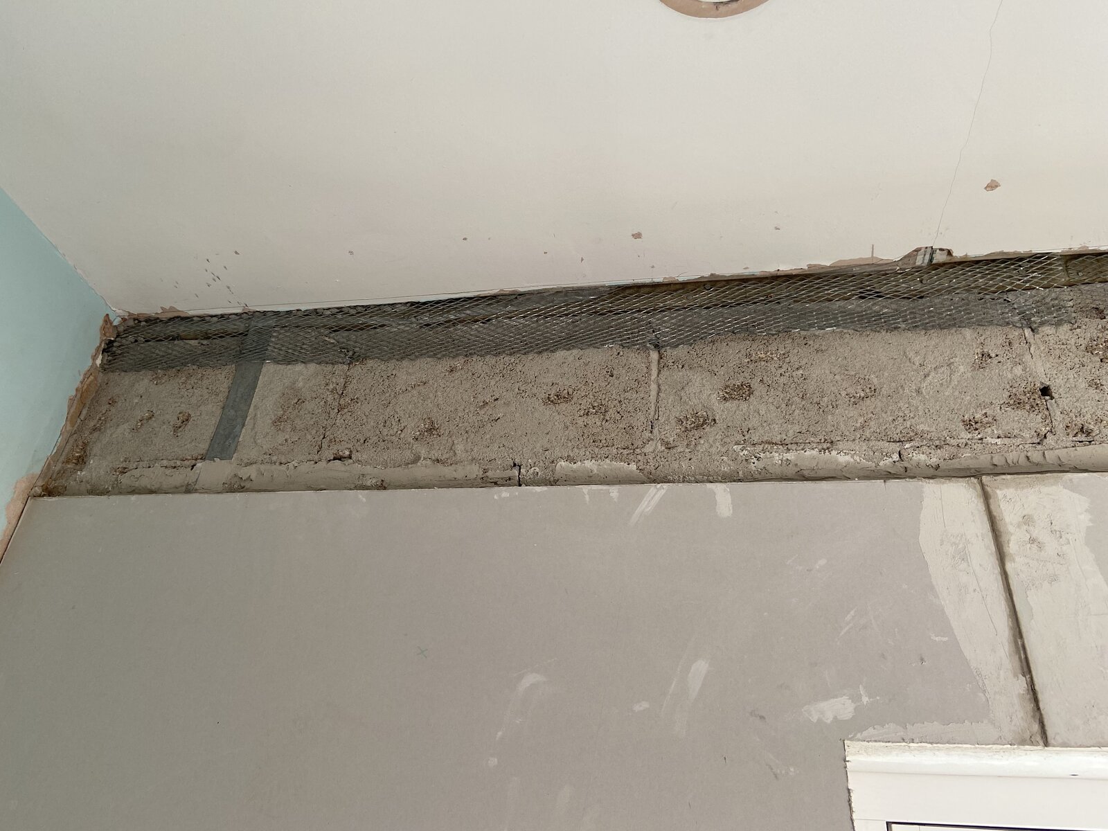

Dot and dab over metal mesh?
31 Mar 2021
27
Can I dot and dab over the metal mesh in the photo? Behind the mesh is half block wall and half timber. If I can't dot and dab over this what would I need to do so I can?
Hi,
The metal mesh is designed to be rendered or plastered over.
However, it is usually mechanically fixed first.
If you are not happy with the mesh being there, and you are happy with the substrate, just cut it out!
If you are not happy with the substrate, 'plasterboard expanding foam' is a good alternative to dot and dab.
...and even a grab adhesive like Pink Grip would do for a small area! :)
