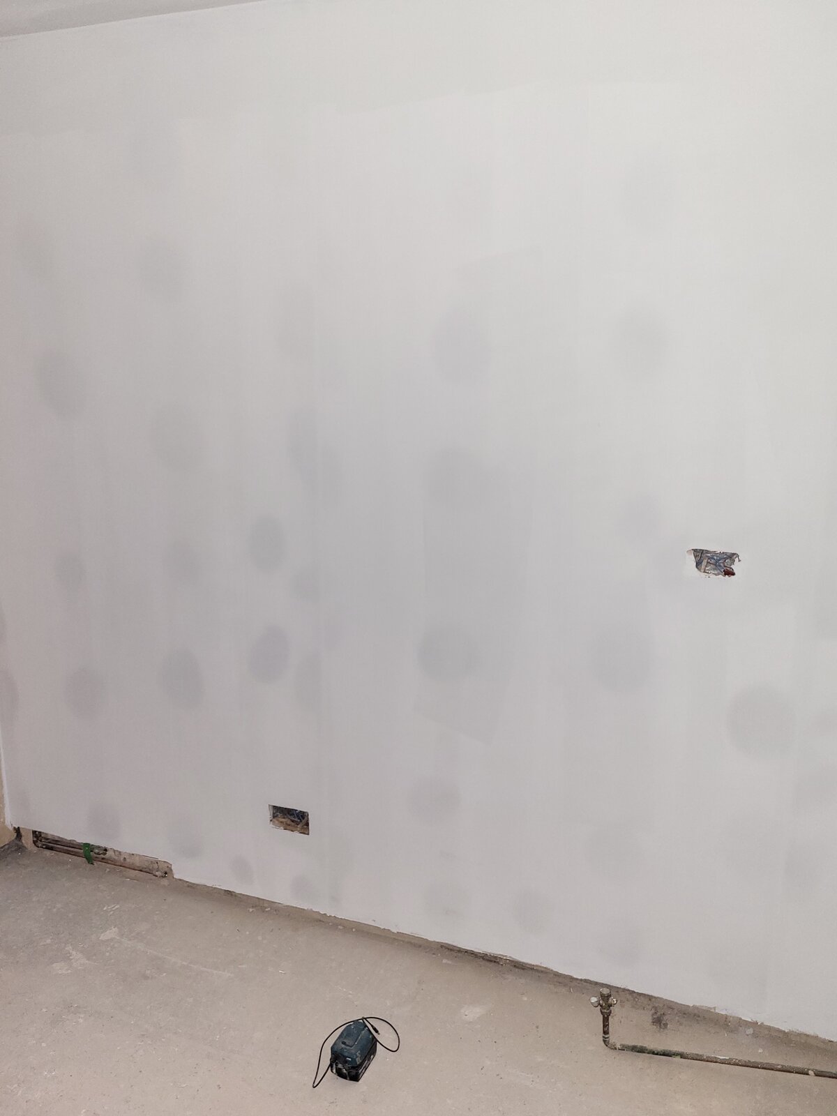

Probably been discussed a thousand times, but I'd rather ask the question than try and find someone in the exact same situation as me...
Kitchen plastered about a week ago, and all looked dry - so I did the mist coat. After doing this I stood back and noticed the dot and dab marks showing through the paint (photo attached). It seems me painting, and breathing/sweating has increased humidity in the air and the wall I hadn't yet painted I could see the dots showing up there too - so it obviously wasn't all dry despite it looking like it was.
I've stopped painting now to leave it to dry for longer - but just want to check I haven't completely f**ked up here, have I? It's will dry evenly eventually? I'm not now stuck with a polkadot wall?

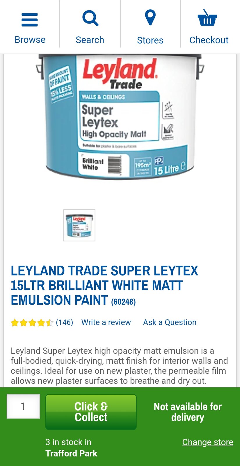

I've always used Leyland Trade Super Leytex Brilliant White Matt Emulsion Paintand has always been very good.
The description says "Ideal for use on new plaster, the permeable film allows new plaster surfaces to breathe and dry out." - so I'm hoping the dot and dab can still dry through it. But, if somebody who knows what they're talking about can confirm to put my mind at ease?

Any insulation behind that plasterboard or is it just straight onto a cold wall?
This time of year one week drying is not enough. Damp adhesive..
Put a summer fan on during the day to move air about will help.
Next few days will be dryer weather as well. No harm done. Wait for it to dry out
Phew! Thank you. So not a fan heater? Just a normal fan!?
Just a normal summer fan. Like the wind drying washing. Open window and get the air moving. You don't need heat

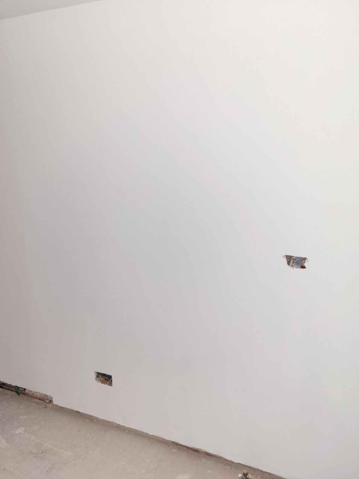

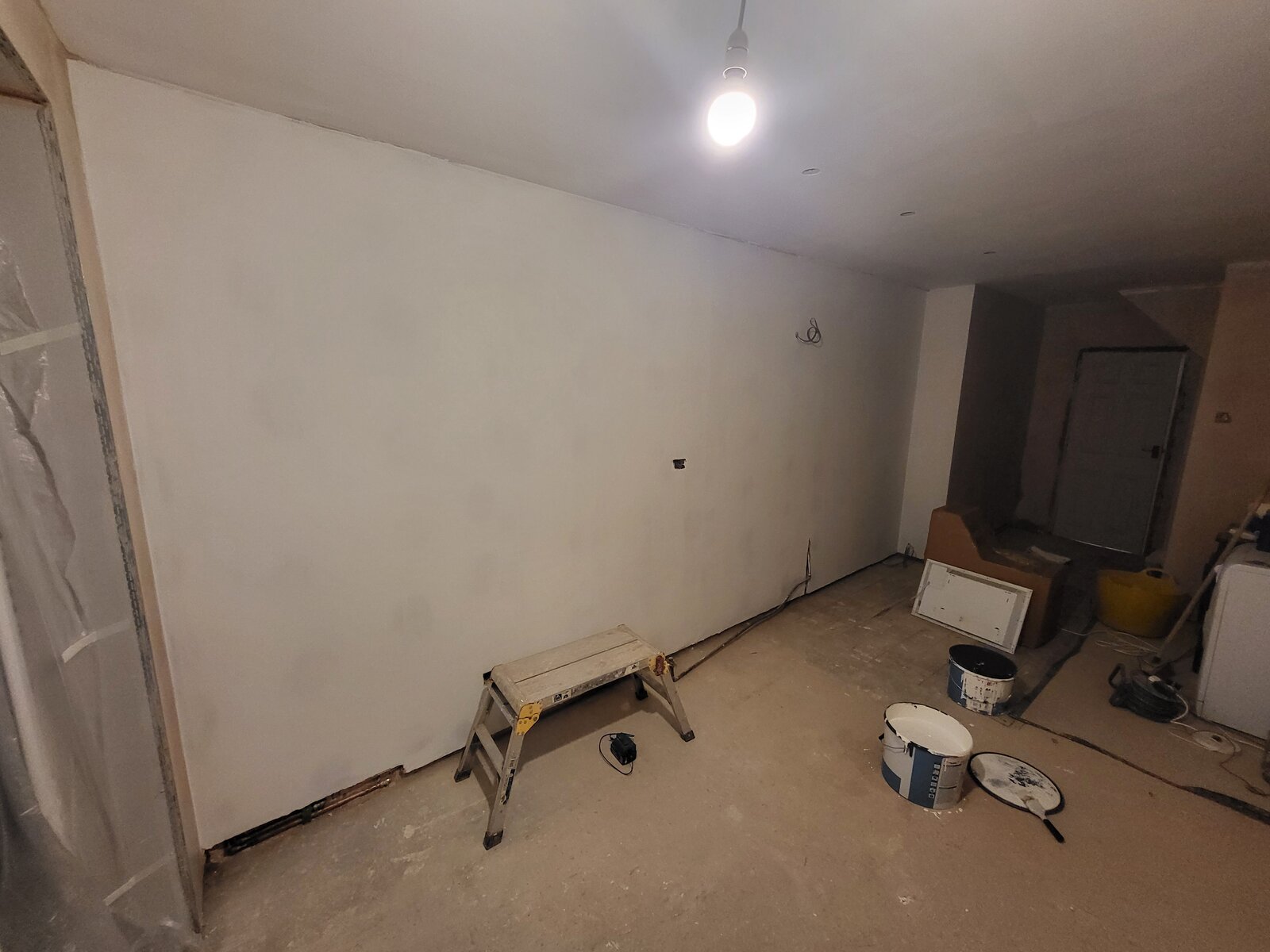

Update: I've not done anymore painting, but this is how it looks tonight, compared to last night.
Bit confused now. Is it dry? Or is it misleading me? Should I continue painting or leave it till weekend just to be sure?

If you put some cling film over the dots it will show as getting wet if any moisture still there.
