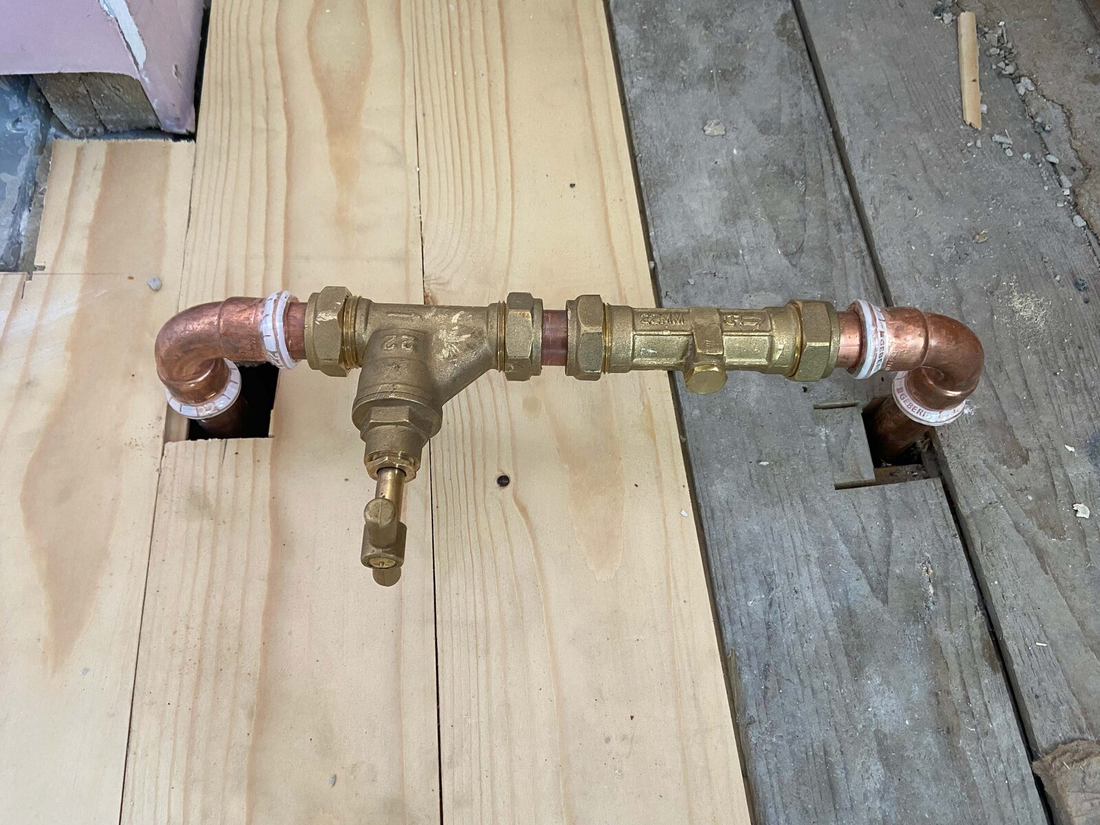

I've had my old stop cock repositioned. When I had a look at the work, a double check valve has been installed directly after the stop cock. Is this normal?
I ask as it's making quite an annoying vibrating sound whenever any tap is on in the house. So I'm wondering if the plumber needs to replace with a better quality valve, or is it even necessary in the first place?
Cheers
Can fall under local bylaws, certain boards require a double check valve after the stop tap to protect the mains, especially in flats or premises on a shared main. It's good practice to have them fitted IMO, especially as there are now more and more 'illegal' fittings/outlets being attached to the mains in some properties.
If it's chattering then time to replace, the valves/channels inside do wear.
If it’s recent then ask the installer why it’s required, as above, could be a regulation set by the local water undertaker. Make sure the arrow is pointing the correct way, as valve could be faulty and fitted incorrectly.
As post #2, can cause problems with combi boilers, especially if they have a preheat function and can cause the PHE to fail due to over pressure, some maunufactrers stipulate that a expansion vessel be installed.
Ah! Yes it's an old 1920s ex-council house with shared mains. So that sounds like the likely reason.
However - It's brand new, so it won't be worn out yet.
Could be the stopcock then?
Well I mean - Both stop cock and check valve are brand new. And I presume the check valve has moving parts and more likely to make sound. Plumber will be having a look anyway, I just wanted a little more information to arm myself incase he fobs me off with "they all do that".
With no mention of it being new :ROFLMAO:
