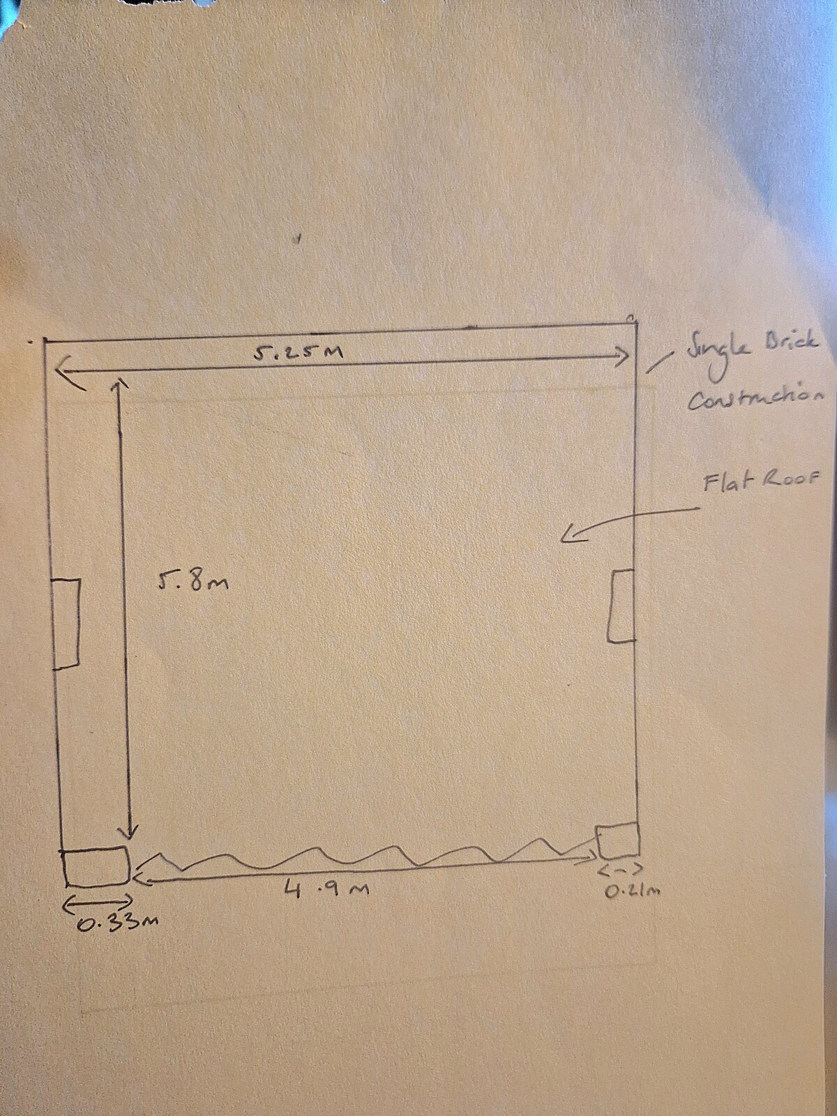

I've a 203x133UB25 beam ready to be installed across a double garage opening, it will have a wall plate fitted and hold one end of the timbers of a flat roof, may also hold the double garage door later
2 questions
1. Is it undersized? Ive been doing some reading and seen people are using 203 x 203 x 46 or 60 in these cases
2. What size padstone is best?
Thanks guys

What did your SE say?
Yes via the phone in a verbal discussion "I think UB will be okay, a 233*133, let me double check but should be good"; and was meant to return to me with calcs and document, 3 weeks ago. Now radio silence
Alarm bells me thinks.
Ask your BCO?
Without dimensions we can't say for sure but a 203x133 is a pretty chunky beam so I'd not be worying for a garage without BRA; worst case global warmimg is cancelled and you get several feet of snow. Might bend a bit too far then
What is BRA?
I have an opportunity to swap it out for 203 x 203 x 46. Would that be more appropriate?
Building Regulation Approval (you said no BCOs involved)
Put some dimensions up and, if I can work up a bit of enthusiasm, I'll crank up Superbeam and see what the numbers actually say.

Other correspondence states it's 6m wide 5.1m deep, so roof load above beam about 2.5x (0.75+ 0.25) kn/m run??

Will get the proper dimensions shortly, and very much appreciated!

Dimensions above. Ideally also I'd like to have roof joists running front to back across that 5.8m span but I can have them across the 5.25m span (though it would change plans in the visible garden - which is the side of the garage); flat roof, EPDM. May do insulation inside at later date, no plasterboard.
