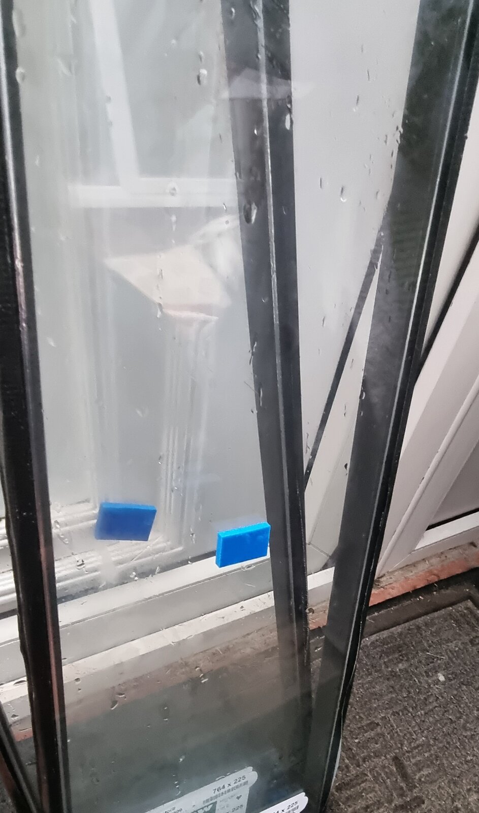

Example, tell me what's wrong with these, Ronnie will spot it
View attachment 286008View attachment 286009
Come on crank39. I've been retired for 31 years and have been very busy doing absolutely nothing. Consequently, or therefore or so, I don't want to spend the next 31years, coming back here and trying to work out what or where the fault in your image lies. I am not implying that there is a fault in the image of you of course, that is not for me to say. No, I am referring to the fault in the image of the door you have posted in your reply. : )
ps: complete the following sentencE. And the fault is....................................
Don't know about the door as wasn't there to look at that but there is a fault with the glass units, come on guys anymore takers?
