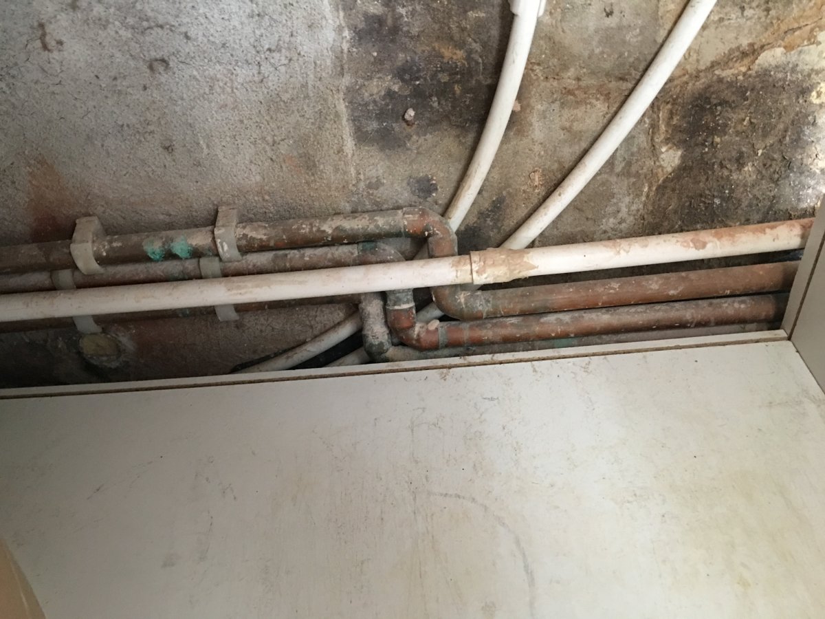

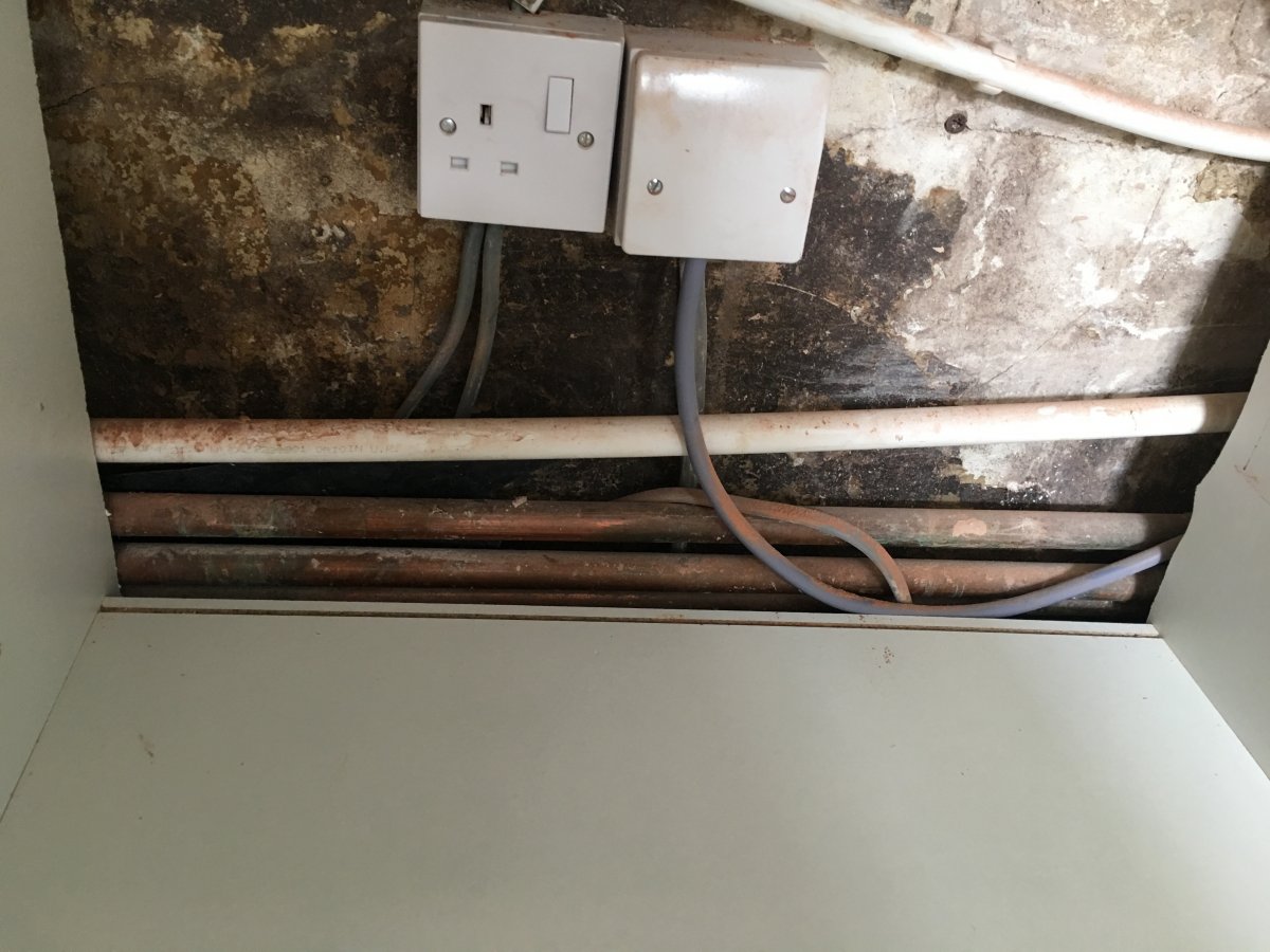

Our oven went pop yesterday, element failed again and Mrs was sick of it and always wanted a double built under oven so I ordered her one for delivery this morning.
Pulled the old single oven out and discovered that there was pipework in the way.
I have a 22mm ch feed, return and gas pipe running accross the bottom of the cabinet right where the back of the oven needs to be. By the look of it they all need moving down the wall about 6". Not being an expert I'm assuming that this could be done by putting some elbows in before and after the oven so it clears it.
Realistically what should I look at paying in London to get this done?
You make a very good point!
On the right hand side of the oven unit the pipes are the required 550mm from the front of the cabinet but they move away from the wall by the left side by about 20mm. Top one is the return, middle is feed and bottom is gas.
Edit: should add that they move about 4cm closer to the wall in the second picture where they bend.

Just thinking this through - if I moved the plastic water pipes could I heat up those central heating bends and just push them into the wall (I.e. So they rotate)?
There is movement on the pipes So it looks like they would go closer to the wall. Have measured and wouldn't need to do anything with gas because it's below the oven.
Or I could just cut them and join back up in plastic.

Kitchen cabinets are normally at least 570 deep, that will give you 20mm for pipes at the back of oven, once you take the old carcass out you might be able to get a bit more clearance.

From the picture the electrical boxes stick out further than the pipes do, so they are likely to be the problem. The pipes almost certainly are not.
The electrical items can be recessed into the wall.
If you can't get a double connection plate, get a dual backbox and two single connection plates.
Not ideal to have cables draped over heating pipes either.

Previous oven was only single and didn't go down that far. Only exposed the pipework this morning when I took the bottom off the oven unit carcass.
The part of the oven that needs to go into the unit is 55cm deep. The pipe is 53cm (at best) to the front. There is a cut out at the back but for some reason the oven has bits that stick out on either side of the cut out.
Electrical boxes are going to be moved.
Managed to get it wired up last night and gained some space by pulling the unit out slightly.
Oven is however touching the central heating return pipe at the back. Since the case shouldn't get too hot I'm not too worried about heat but am worried about the pipe expanding and contracting against the oven and wearing through.
Can anyone suggest something thin I could wrap around the pipe to protect it?
