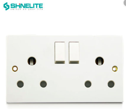

Has anyone seen a double 5 amp socket or a double 15 amp socket. ?
I don't recall every having personally seen one, and it's very possible that they were never available/used in the UK - but if you ask Mr Google about this, you'll find plenty, of which this was the first he told me about ...
