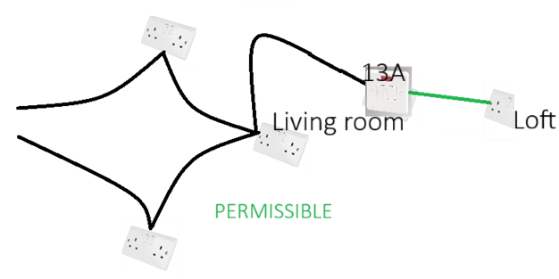

I believe you currently have thisView attachment 397264

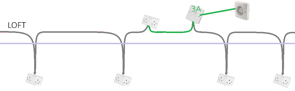

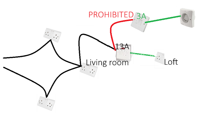

View attachment 397265View attachment 397266View attachment 397273
Essentially the simple rule is an unfused spur from a ring, be it from a socket or junction box etc may only be connected to one of these accessories: single socket or double socket or fused connexion unit. After the fuse in those accessories almost anything may be added.

Thanks alot for the advise yeah so basically once you have a fcu on you can basically connect anything to the load side of the fcu obv aslong as you have the correct fuse in the fcuI believe you currently have thisView attachment 397264
