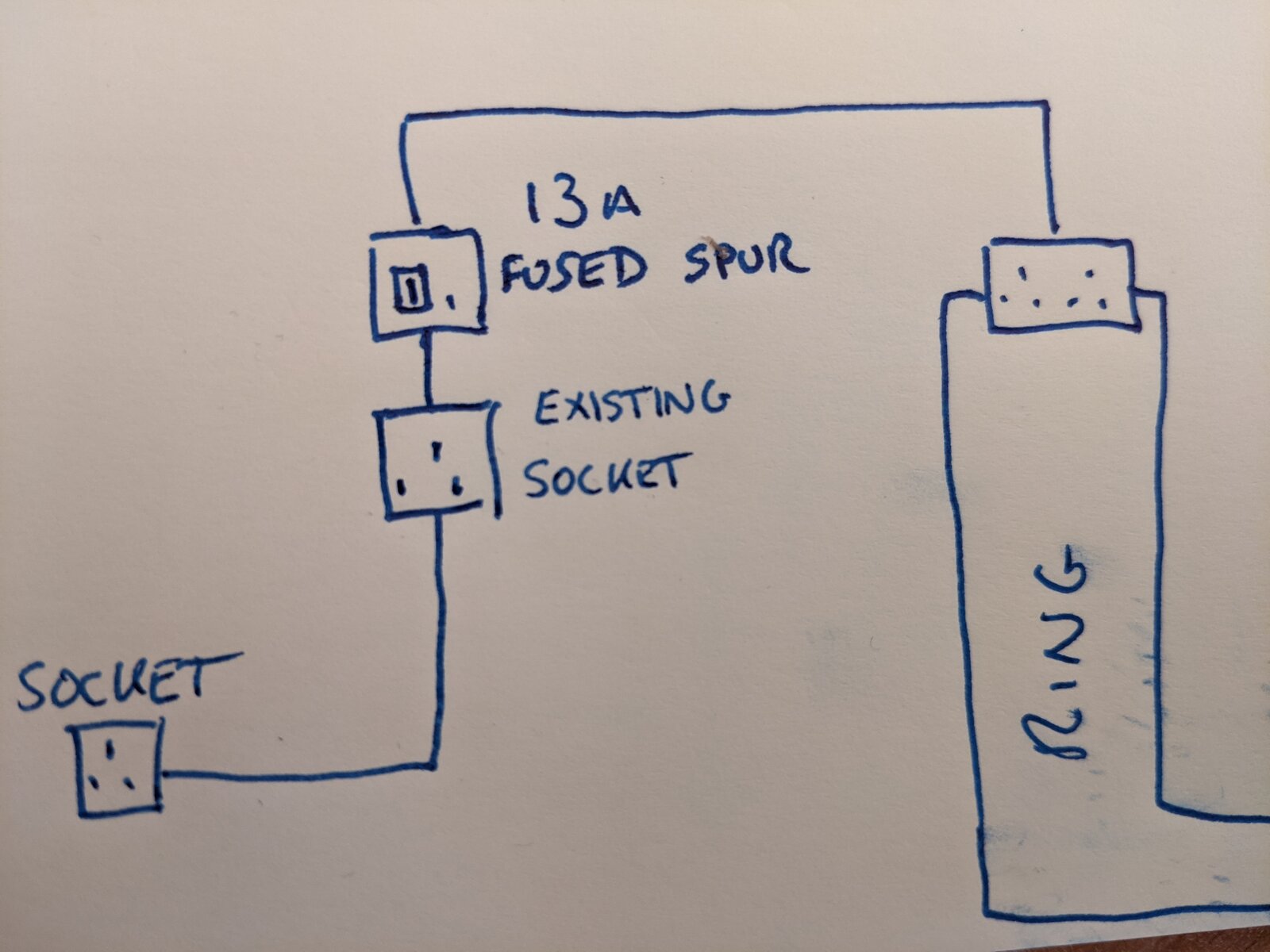

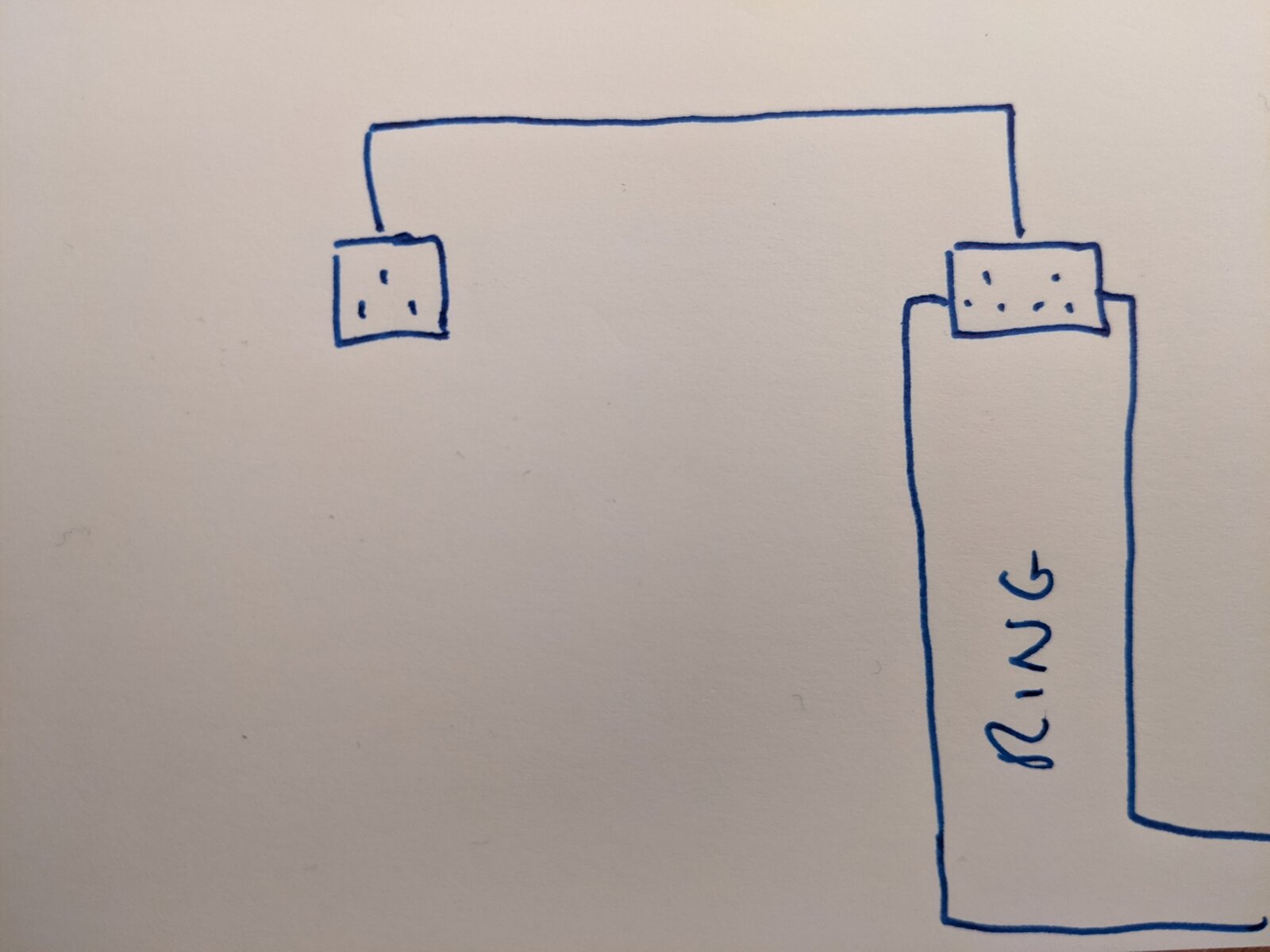

Hi folks,
I have a 13amp socket spur taken from the ring, if i insert a fused spur before the original spur socket can I then add a second spur 13amp socket by via cable from the first spur socket?
I appreciate total of both spur sockets would be limited to 13amp loading.

That's fine (easy) if the existing socket is a double one, but I suspect from what the OP has said is that it's only single - in which case adding a separate FCU, as he proposes, would not only be cheaper, but probably easire.

I assumed I need a fused spur before the first (existing) 13amp socket I have on my spur rather than the fuse being in the sockets I fit, so that everything after the fused spur is protected.
What eric showed was, in effect, something you could replace your existing socket with, to avoid having a separate FCU/"Fused Spur". The incoming (spur) supply would feed the switch and fuse (which therefore would be, functionally, an FCU/"Fused Sur") and the output side of the fuse would then feed that socket in the same box, and could also then feed any/all of your additional sockets (since all sockets, including the one in the same box would be downstream of the fuse).
[the switch module would only be necessary if you wanted the equivalent of a switched FCU ("switched Fused Spur"). If not, you could have just the fuse module, without the switch ]
