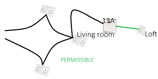

Sounds like you're talking about this:
a fixed double gang socket can only take 13amp ? across both its points not 13amp on each point

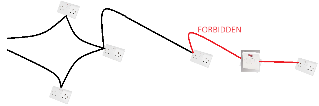

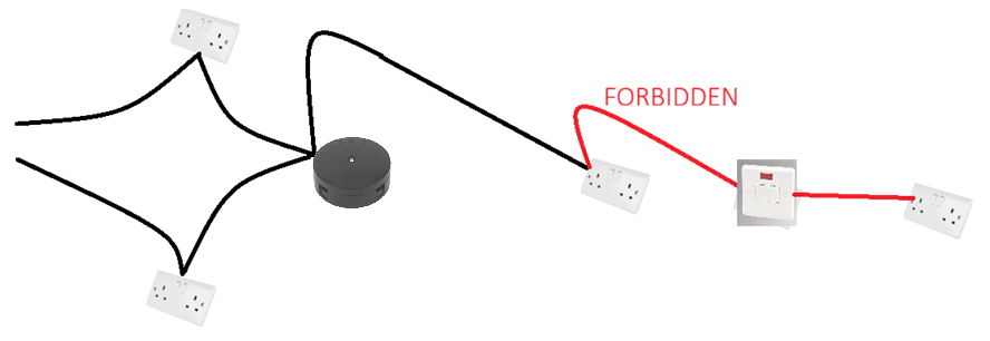

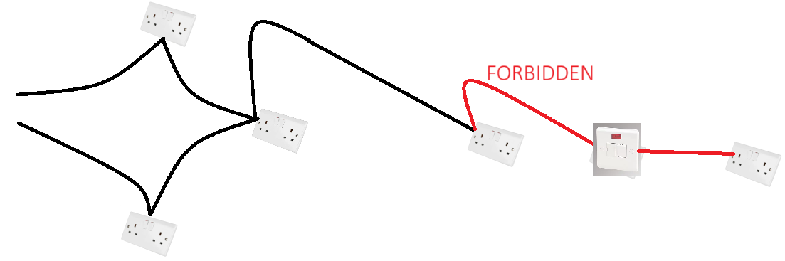

Yeah this one is kind of correct but its not coming out the back of a socket on the ring its coming from a break/juction box in the ring
So you cant break into a ring run a single lenght of 2.5mm to a new double socket the spur off that socket with fcu
No the fcu would need to be before the first socket, if you wanted more than one.
A double socket is a break in a ring/there is no difference between a JB and a socket

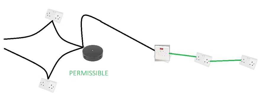

Come off the ring in 4mm, or to a fused outlet then put as many sockets as you want downstream of it (you keep talking about coming off to a socket; put a fused outlet where the socket is and put the socket downstream of it)
The whole idea is that you can't cook the wire.
* If you come off the ring in 4mm you won't succeed in cooking the 4mm before you blow the breaker for the entire ring.
* If you come off straight to a fuse you won't succeed in cooking the wire downstream of the fuse, before you blow the fuse.
* If you come off in 2.5mm with no fuse you may only have one double socket, which cannot accept enough appliances to cook the wire; even if you the plug two 4 way extension bars into it, and plug in 8 toasters and turn them all on, all you do is blow the fuses in the plugs of the extension bars
There always needs to be a fuse/protective device upstream of the load, that blows before the wire melts (the wire must always be able to carry more current than the protection device)

you can spur off any part of the ring with only 1x double socket
The "normative" part of the regs does not explicitly say how many sockets are allowed on a spur, but there is guidance in an appendix that specifies one single or double socket. There is an implied assumption here, that it is "unlikely" that both sides of a double socket will have large loads presented at the same time. The test requirements for sockets in BS1363 have a similar assumption.
however i believe its permitted that you can add a 13amp spur unit from the spurred socket and then run as many sockets as you want from that being protected by the 13amp unit
To comply with the guidance, the fused connection unit must be located such that it protects *all* the sockets on the spur.
Once the fuse is added, you are essentially no longer relying on the ring circuit dispensation. The 13A fuse protects the spur in the event of overloading.

Any point on the ring or any junction box on the ring should not be spurred to any more than 1 only of the following twin/single socket/fused connection unit (whether that FCU is switched or unswitched type).
ok i understand now so your not suppose to add a fcu to a socket that has already been just ran off on a single 2.5mm cable and is not part of the ring
the way to do it would be change the socket that has been ran off the single length of 2.5mm to a fcu then add further sockets after that

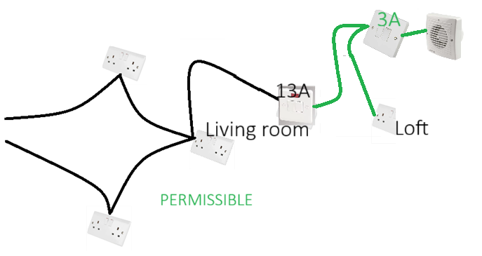

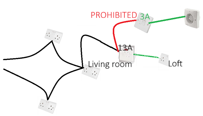

just another question i have single socket in my loft that is running off a fcu that is in my living room which come off from a socket
can i ask would i be able to change the socket in the loft to a double pole fcu with a 3a fuse to be able to run my extractor off
so it would be socket off the ring going to a 13amp fcu on 2.5mm which then would run to a second double pole fcu with a 3amp fuse which would then run to a pull cords and then to my extractor on 1mm twin and earth
Well yes but there is no point having two FCUs - and are they not all double pole nowadays?
Surely a socket ON the ring.
Such is what lead to confusion earlier.
Change the first FCU to 3A :?:
Correct.
Correct again.

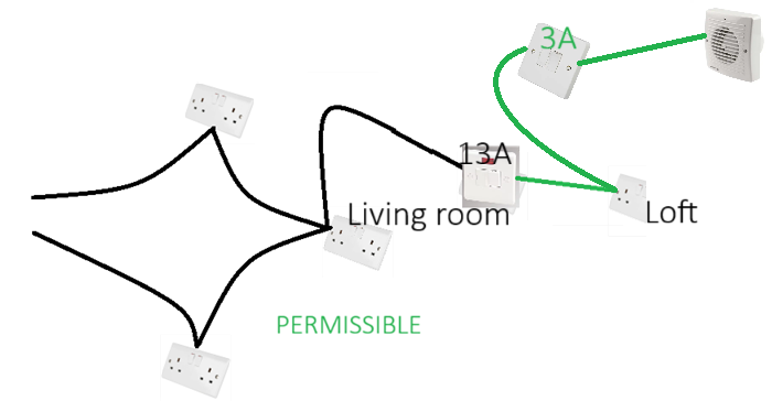

just another question i have single socket in my loft that is running off a fcu that is in my living room which come off from a socket ... can i ask would i be able to change the socket in the loft to a double pole fcu with a 3a fuse to be able to run my extractor off
Ifthe socket in the loft is fed from an FCU, you don't need a second one. Since that socket is already downstream of an FCU, you can connect any number of additional sockets (or anything else) to that socket.

I believe you currently have this
Essentially the simple rule is an unfused spur from a ring, be it from a socket or junction box etc may only be connected to one of these accessories: single socket or double socket or fused connexion unit. After the fuse in those accessories almost anything may be added.
