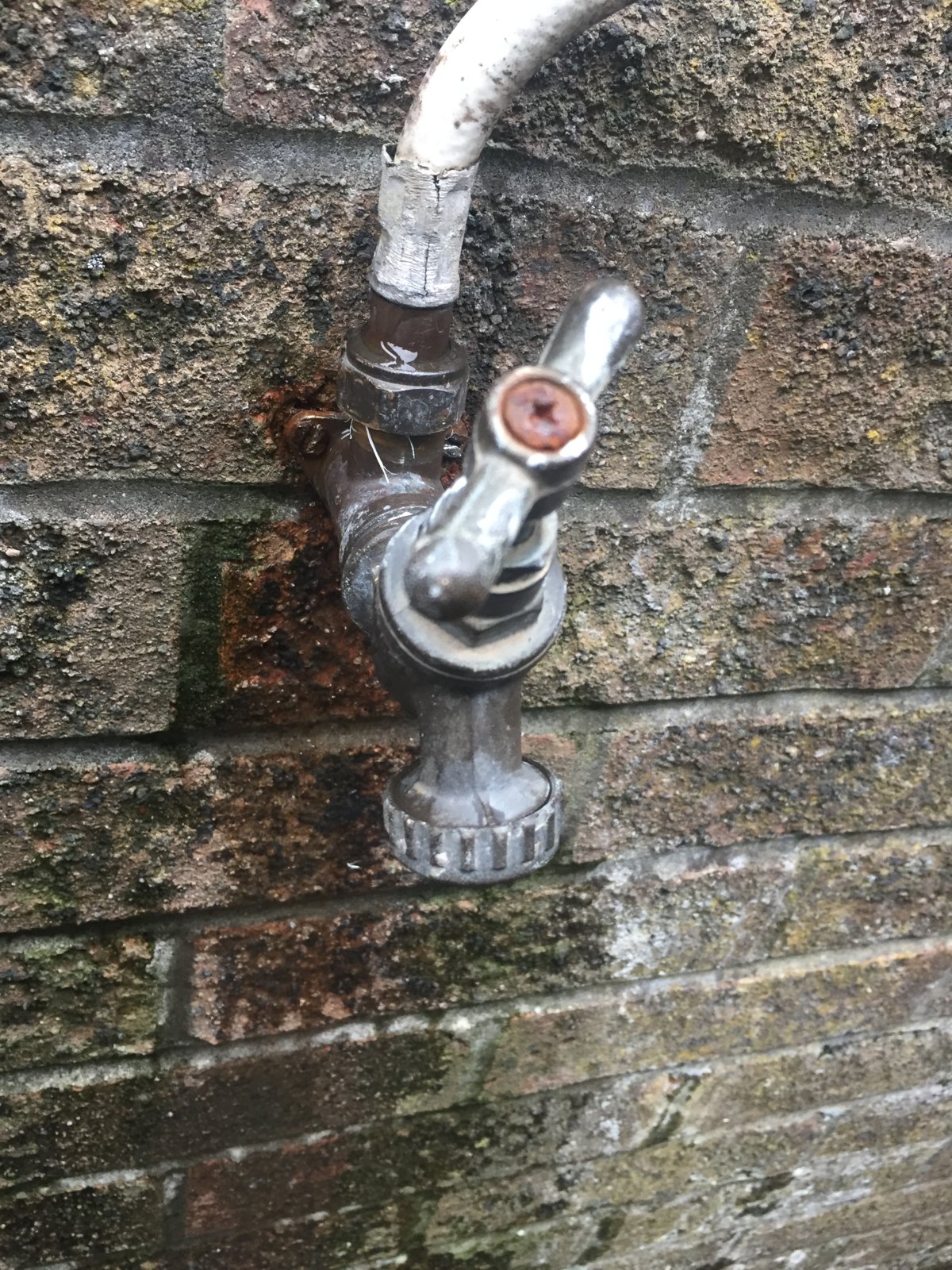

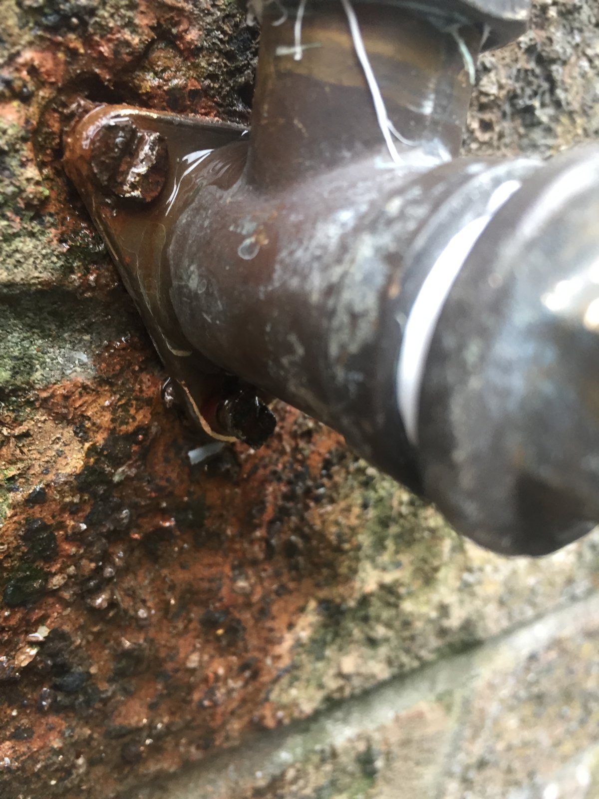

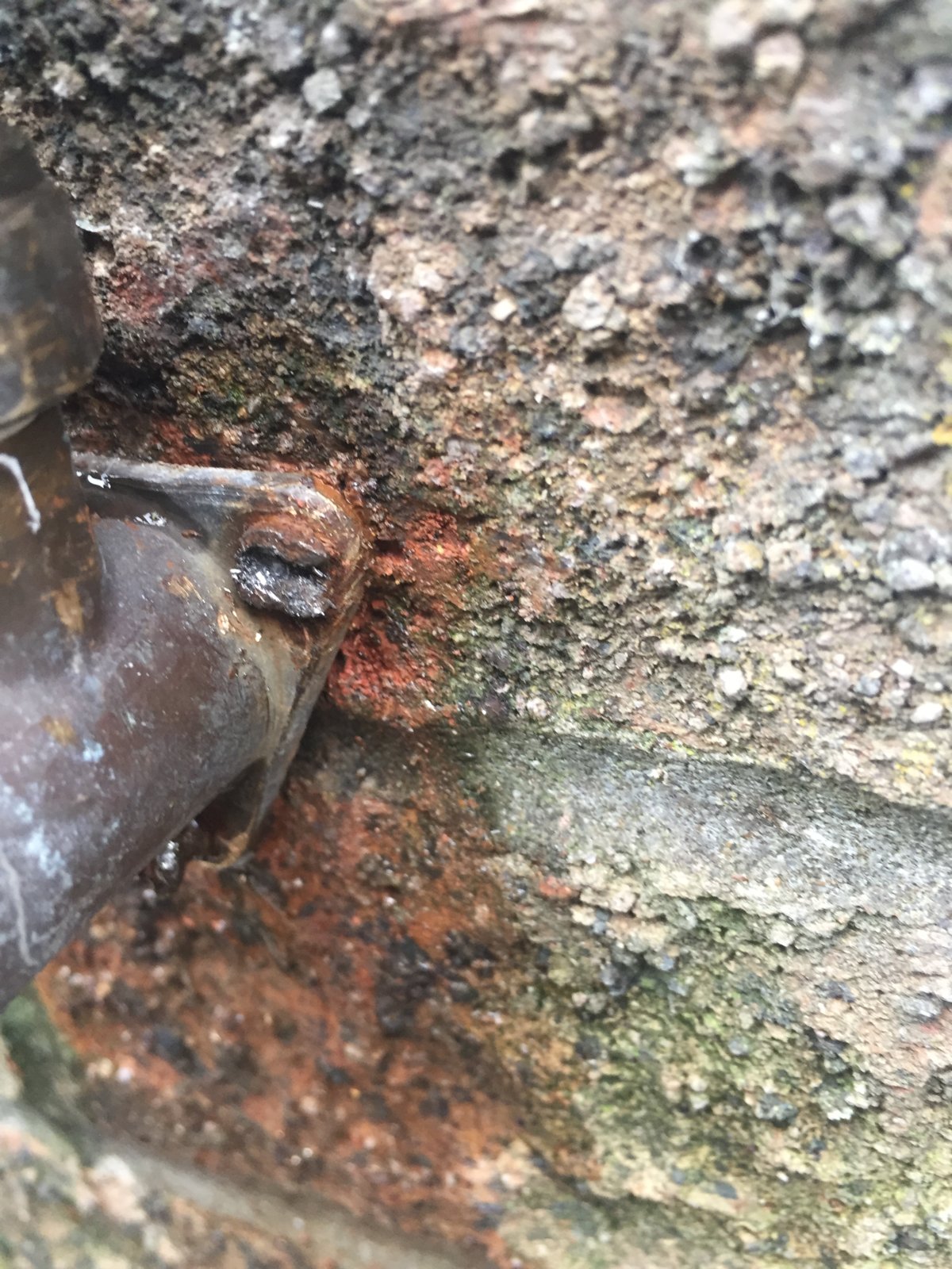

Hi
See image. Tried for two days to remove these screws supporting old garden tap.(leaking and need to replace) Tried mole grips, screw extractors pliers etc. Problem is confined space as much as condition of screws. V frustrating as were just bog standard. Any advice much appreciated.
(One underneath buggered as tried to twist with pliers)
Ta
Shear the heads off with a hammer and chisel. Screws wont be any good in any event. Remount the tap else where.
Thanks. Is there any other way which would allow me to keep same tap position?
Do as I suggested then try and back out what's left of the screw with mole grips. Replace screws with stainless. I'd spray plenty of WD40 on it a few hours before hand tho.
Maybe you could lever the whole thing off with a crowbar and it'll pull the screws and plugs out too. Depends on how well it was fitted in the first place I guess.
That'll either go well, or the heads will snap off and you'll be back to what Sammy has suggested anyway!

If you have, or can borrow, a soldering iron, heating the screws can help loosen them. Did it on an old door and it worked a treat
'Shock and Unlock' spray from Halfords is often sufficient to free siezed nuts and screws.

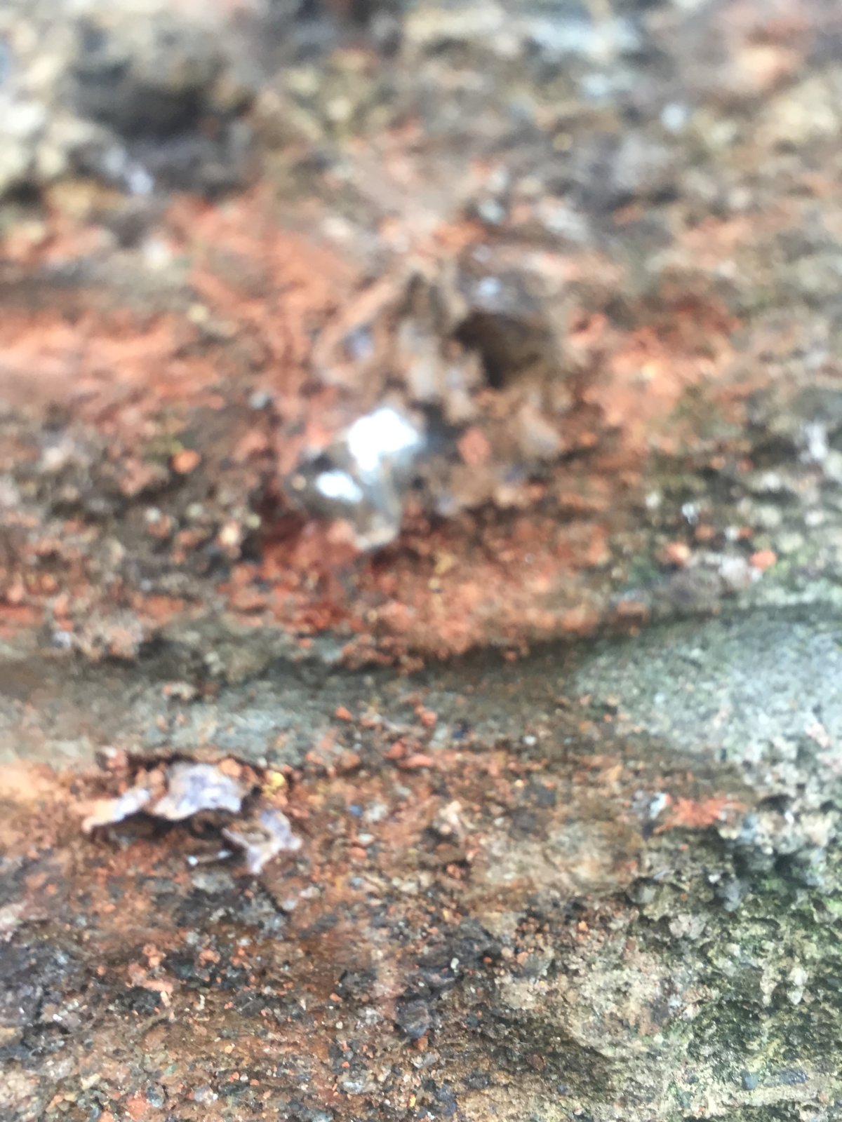

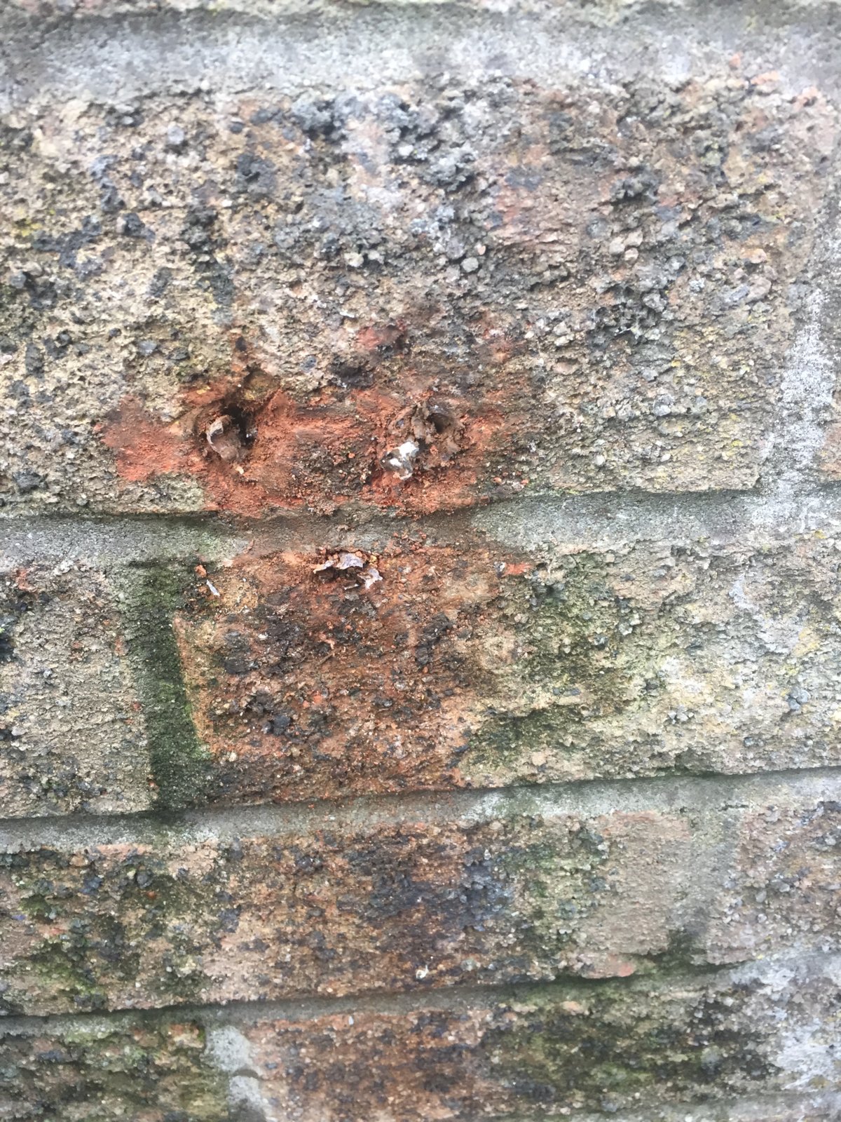

Checked olive, but seemed fine. Finally sheared screw ends of with chisel. Unfortunately, one would play ball and is now flush with surface. (Photo) Guess I’ll have to give up on that, short of damaging brickwork?

you are now in the right frame of mind to lay in a small stock of Stainless Steel screws for garden and outdoor work.
Screwfix and Aldi (no doubt others) often have assorted sets at modest price. When you find the size you use most, you can get a bigger pack.
They are usually poor-quality Chinese steel, so don't use them (for example) on the brakes of your car.
Only other thing you could try is a pair of needle nose pliers and try backing it out that way but at this point it'd start with fresh holes and just move the tap.
