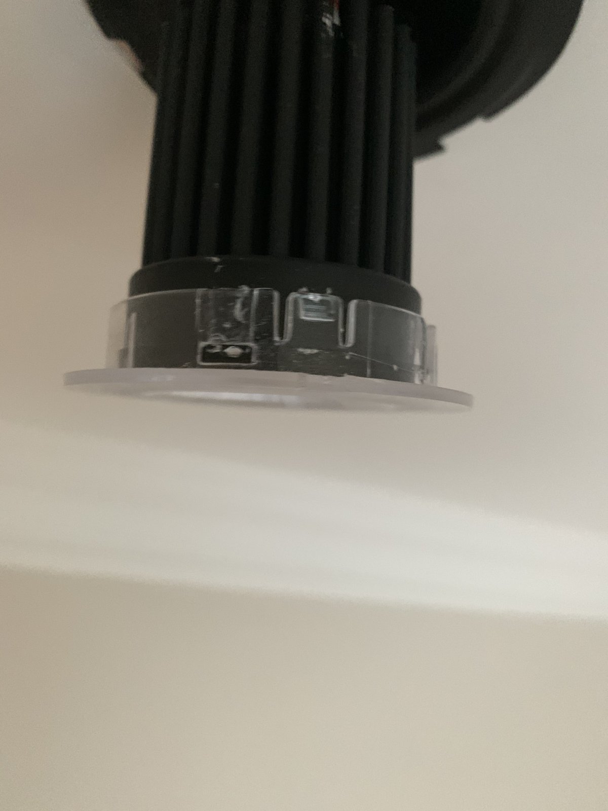

Hi, I am trying to change the bulb in my down light, as far as I am aware it is an ansell fire rated but that’s as far as my knowledge goes. It won’t twist off or be pried off, I’ve used that many things I’ve almost broken it! Any help welcome!!

I don't think there is a bulb to change.
I think it's a case of getting a whole new fitting.
Take it out of the ceiling (mind the spring clips don't bang your fingers) and look at the Ansell model number. Post it on here.
But, as above, it looks like an integrated fitting, no lamp to change, you probably need to buy a whole new fitting...
Similar problem Model AARGD/WW did you ever figure this out?
From advert "The Ansell Argo AARGD/WW is a 5W LED Downlight which delivers 85Lm/W of warm white light." can't give the wattage and lumen output of a bulb holder, has to be an integral unit.
As above, it is a complete unit. You cannot change the bulb, you replace the whole unit (ie fixed bulb).
You just need a replacement one
