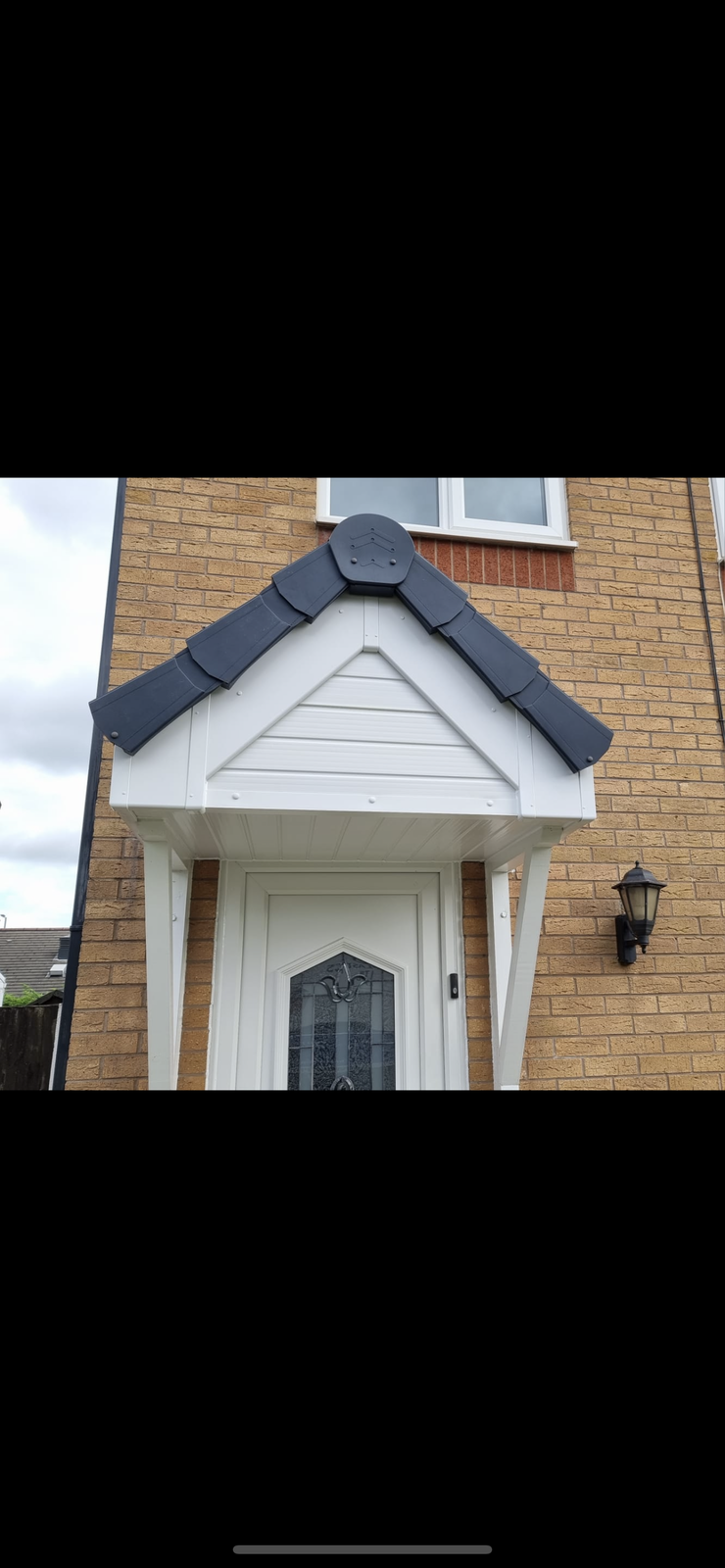

I’m having this canopy installed and want to have two downlights and a PIR.
Do I need any special downlights for outdoors or any indoor downlight such as the Ansell Prism that I use indoors is fine ?

Something with a Higher IP rating just in case they are exposed to the weather. You could use a PIR that is recessed similar to the downlight(s)
A downlight that is suitable for a bathroom would be fine. Look for one with a rating of IP44 or higher.
