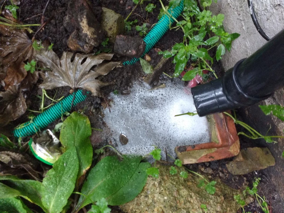

The drain for my front gutter downpipe is blocked right up to ground level, and the brick surround broken in half. I dug it out 6 inches or so and the mix of largish lumps of rock and brick in the soil makes it look like it was blocked deliberately. I have various health problems which make it hard for me to dig any further down myself.
There is no pooling of water in the front garden, except on top of the drain (see pic).
There is a water drain running under the house from the back which I assume this drain should be connected to.
Presumably I should get someone to see if they can clear it out? If that's not possible, what should I do? Stick an elbow on the bottom of the downpipe and run an extension 4m to the bottom of my front garden? Or put the extension right through a hole in my garden wall onto the pavement, to drain down into the street gutter (some houses in the area have done this but is it legal?)?

The first ploy has to be to find someone with some Marigolds and get stuck in there.......there's usually no problem reaching down to the bend and that's where most of the problems lie.
A wet vacuum cleaner can also play its part!

I've now cleared it out with marigolds as far round the bend as I can reach. From what I can feel with my fingertips it still seems totally blocked with soil and rocks beyond that. What do you reckon?
Hopefully that gulley will terminate in a manhole fairly close by? I have to say, blockages as bad as this are a little unusual, so have you considered having your drain jetted?

I have no idea where the gulley terminates. No manhole obviously linked to it. I had a drain guy out today to clear it but he couldn't jet it without a manhole for access at the other end. He recommended getting the gully dug up and replaced for £750+VAT (+ a lot more if they find a faulty soakaway or pipe at the other end). Does that sound reasonable?
I'm pretty annoyed the surveyor missed this before I bought the house. I can't believe the problem is new in the past year.
I'm a little troubled that this problem hasn't been particularly noticed before.....the fact that there seems to be rubble after the gulley bend would indicate either a long term problem or a drain collapse.
Time for a little investigation perhaps, concerning an investigation onto neighbours property - it would be great to find out where the pipe actually runs to. If it heads to a soak away then there's no guarantee that it is any good now, and replacing the gulley alone will achieve nothing. If the gulley is heading for a soak away then there's no need to be another inspection chamber - feeling down the gulley will indicate the immediate direction that the pipe heads off to.
Have you looked for an inspection chamber lid, maybe covered up with garden by now?
It could be tempting to run the rainwater onto the pavement, but like you I don't know if it's legal - but it's common enough.

An update...
I spoke to Thames Water today and they say there should be a connection to the main surface water drain in the street. They also told me which three other houses on my side of the street have a surface water drain connection. Interestingly, they all have downpipes which extend below ground level, whereas mine terminates just above the gully. Thames Water can't tell me where the relevant access manhole is though. I'm guessing it must be the one about 10 yards along the road, beyond a neighbour whose house doesn't have a connection to the main surface water drain.
I also spoke to another drain clearing guy. He said that if my gully is connected to the main surface water drain, he should be able to jet it from the house end even if there isn't a useful access manhole.
Finally, I've had my arm down the hole (now full of water) again. Not sure I learnt anything new but before I spend any more money I think I might wait until it's dried out and then (a) get a smaller hand tool down there to scrape away more of the blockage round the bend then (b) get my phone camera down there to have a look at it. Whatever the problem, it's been there for months if not years so a few more days shouldn't be the end of the world.
Sounds like a good plan - let us know how you get on - it may be possible to make a hole in the top of the pipe after the gulley with a diamond holesaw for access IF it isn't encased in hard concrete.
Rather than waiting for the gully to dry out, I got my spade out today and dug around the exit pipe.
As I'd started to suspect, the reason I couldn't dig to the end of the "blockage" with my hand was that the gully isn't connected to anything! There are just a few cracked remains of the bottom half of an old ceramic pipe coming from it. The water is being carried a foot or so from the wall in total.

Personally I'd consider (3) and say absolutely nothing (it was like this when I moved in, guv'nor) - in any case, I wouldn't want a blocked gulley soaking my house wall!
