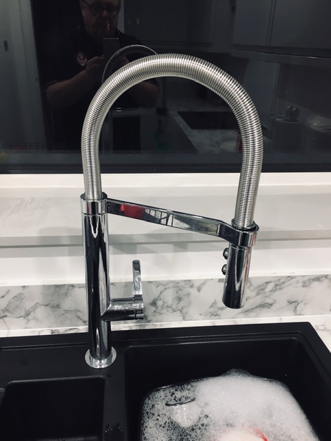

Downstairs hot tap not firing up boiler.

Turn off the isolater to the cold side of the tap try it then. Faulty tap if the boiler then fires up.
I haven't FULLY turned the cold tap off, but I've restricted it so that the flow is now less than the hot tap (where before it was stronger) and now the boiler seems to kick in every time! Faulty tap do ya think maybe?
You mentioned that the tap you've had fitted is for low pressure, but looking at that type would suggest to me it should be high?
If you have a combi boiler and the cold runs from the mains then the pressure should be equalised therefore there shouldn't be a pressure imbalance (cold stopping the hot). It could be a duff cartridge that isn't mixing properly.
Is it a branded make of tap or is it from our one of the online plumbing wondersheds?
Hi, I'm not exactly sure where the tap was purchased from, but on my invoice the description is "ELO045 Shower mixer twin lever tap, brushed" and I've uploaded a pic of it. if you recognise it and know of any common faults then I'd be grateful to pick your brains on it1 Thanks.

If that bendy spout can reach the water in that basin then it won't be WRSA approved and more likely than not from China.
Don't really need to say much more than that TBH.
I've found the problem. There is a flexible metal hose feeding the hot tap and it was kinked, but this was hard to see because it is hidden behind the sink waste. 6 litres/min + now, firing the boiler every time.
