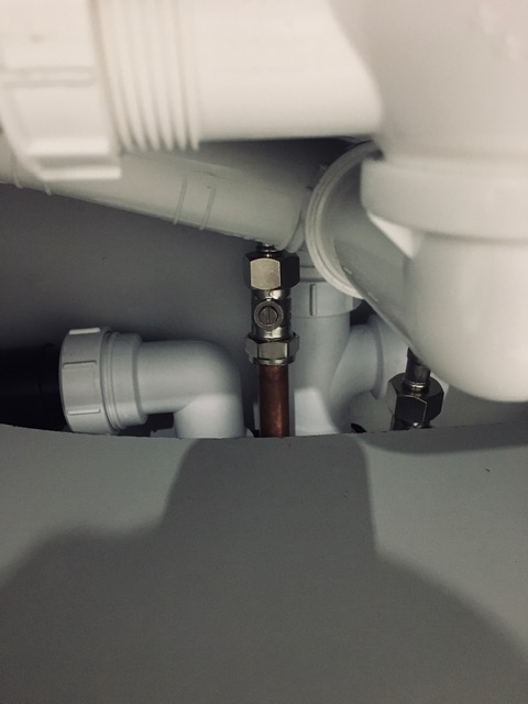

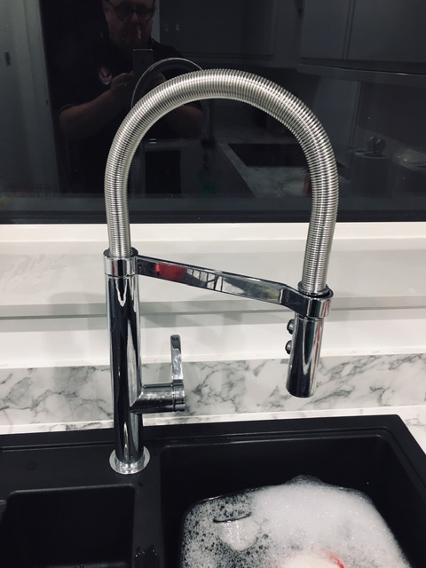

Downstairs hot tap not firing up boiler.
I wanted to rule out a faulty new sink mixer tap...ie. when you open the hot tap they could be a possibility that water is drawn across the mixer from the cold side and an insufficient amount from the hot pipe.
The manual indicates the boiler should come on with a flowrate exceeding 3 litres/min.
I would check the cold inlet valve under the boiler is fully open and if so check the turbine and the combined filter and flow limiter in the turbine inlet connection. Probably worth pulling out the flow limiter and blowing through the turbine to check it spins freely.
I've uploaded pics of the tap and the pipes feeding the tap chaps. However, I've made my mind up that I'm getting a new boiler. I've had a few problems with this one over the last few years to be honest - expansion vessel has gone, twice. PRV has gone. Condensate pipe has cracked underneath and the flue outside is dripping water outside directly above the kitchen door, which often drips on my head and freezes up on the step in the winter, and I've almost broken my neck slipping on it. Enough is Enough. This latest leak i've had has caused me to put a hole in the ceiling in order to find the leak.
What I need to know is whether a new boiler will be triggered by this tap at a flow rate of 4 litres/min? If you guys have any recommendations for which model I should go for then I'd appreciate the advice. Although it's tempting to just carry on with this boiler, I have a strong feeling that I'm just delaying the inevitable.
One thing I have just discovered though is that if I restrict the cold tap flow using the isolator then this has improved the flow rate on the hot side of the mixer slightly? Does this sound feasible?
Thanks in advance guys, all your advice is much appreciated!

I don't know any combi boiler that needs 4 l/ min + to trigger a demand for DHW .
You need to establish ....
1. Why your flow is so poor.
2. Why your boiler doesn't fire up with the flow you have ,when clearly it should .
As Gasguru and I have pointed out ,the parts within the boiler that can affect the flow to the taps ,and their correct functioning to activate the boiler ,need investigation.

Altering the flow on the cold to the tap ,without any pressure change ,can't really make any difference to the boiler firing up. Are you really Anti the idea of getting an engineer to visit ?
Not at all! I'd welcome a good engineer! I'm not sure if I mentioned it, but I've actually had an emergency boiler engineer out who diagnosed a leak on my boiler which was coming from the PRV valve, but instead of dumping it outside out of the little copper pipe, it was leaking inside and has leaked that much that i now have a hole in the kitchen ceiling. He's coming back to fit a new expansion vessel on tuesday as well as a new PRV valve and he's going to replace a piece of cracked condensate pipe, which was also leaking. I asked him about the tap downstairs and he blamed the flowrate even though he hadn't measured it, and suggested I should get a 'large bore' isolator on the hot supply. He wasn't really interested to be honest.

Turn off the isolater to the cold side of the tap try it then. Faulty tap if the boiler then fires up.
