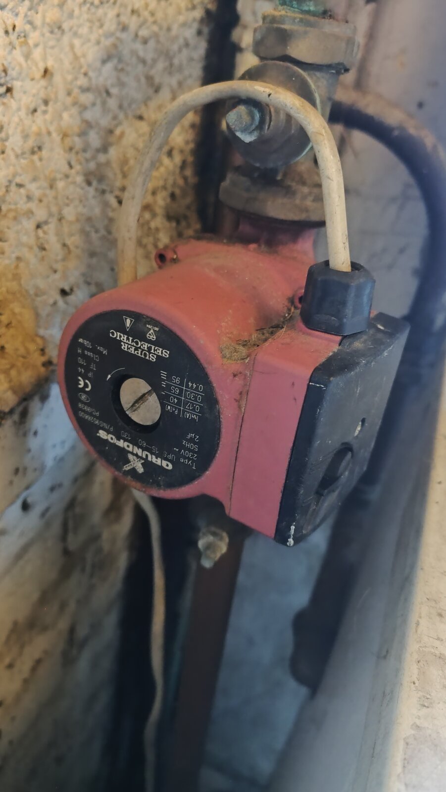

Parents house, heating was fine for a month. Suddenly, all the downstairs rads (five) were stone cold in the morning while the upstairs (six) ones were nice and hot. This happened two mornings in a row. While this happened, the circulation pump was not running and I thought ok I'll replace the pump (tried spinning the impeller and it moved easily). The third morning all was normal, upstairs and downstairs worked and continued for four more days.
This morning, downstairs were stone cold again.
Could it still be the pump ? I read somewhere online someone said they changed the room thermostat and all was working again but I'm dubious.
Boiler is old on/off style, no Honeywell diverter valves at all, digital HW/CH timer and an oooold EKCO room thermostat.
Thanks for any and all help in advance.
Is the pump running or not when upstairs rads are hot and downstairs cold ?
Definitely no zone valves ?
No, pump not running when upstairs rads are hot
Definitely no zone valves. Boiler is an Ideal E-Type.
If the pump isn’t working, then something isn’t telling it to run
That's what I thought but not knowing what actually activates the pump when the timer clicks on I don't know what to check/replace.
The pump is either receiving voltage and not running ,or it's not receiving voltage. The next time it should be running and isn't,check voltage at the pump. Is there a wiring centre / junction box on the system? What provides your domestic hot water ?

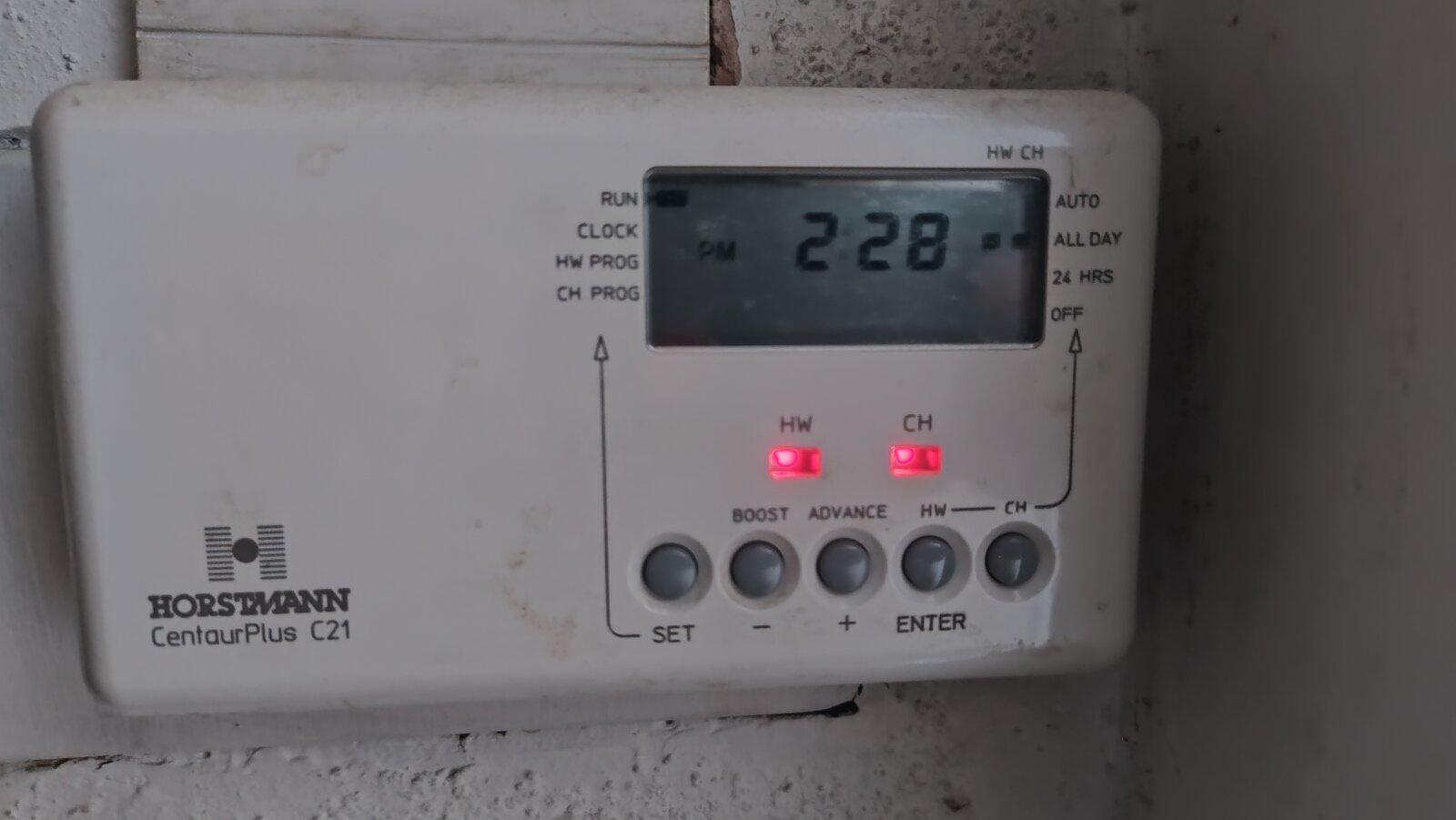

There's wires everywhere in the garage where the boiler and pump is. There's a set of wires that go through the wall in a plastic pipe, under the concrete conservatory floor, under the kitchen floor and up the wall in the breakfast groom into the timer that calls for heat or (used to) hot water.

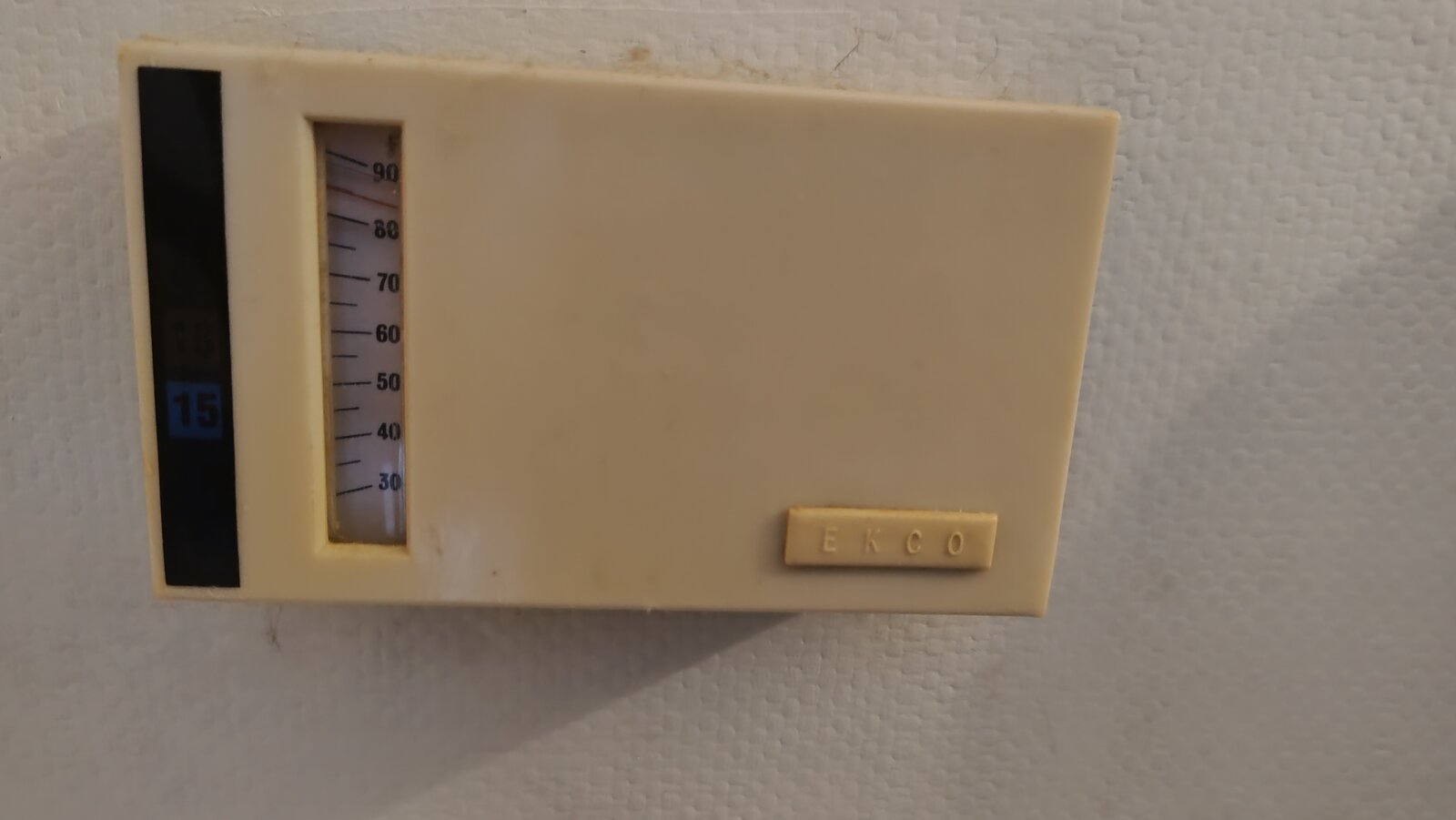

The EKCO room stat is on the wall in the hallway with wires that go into the wall. Nothing is surface mounted in the house.

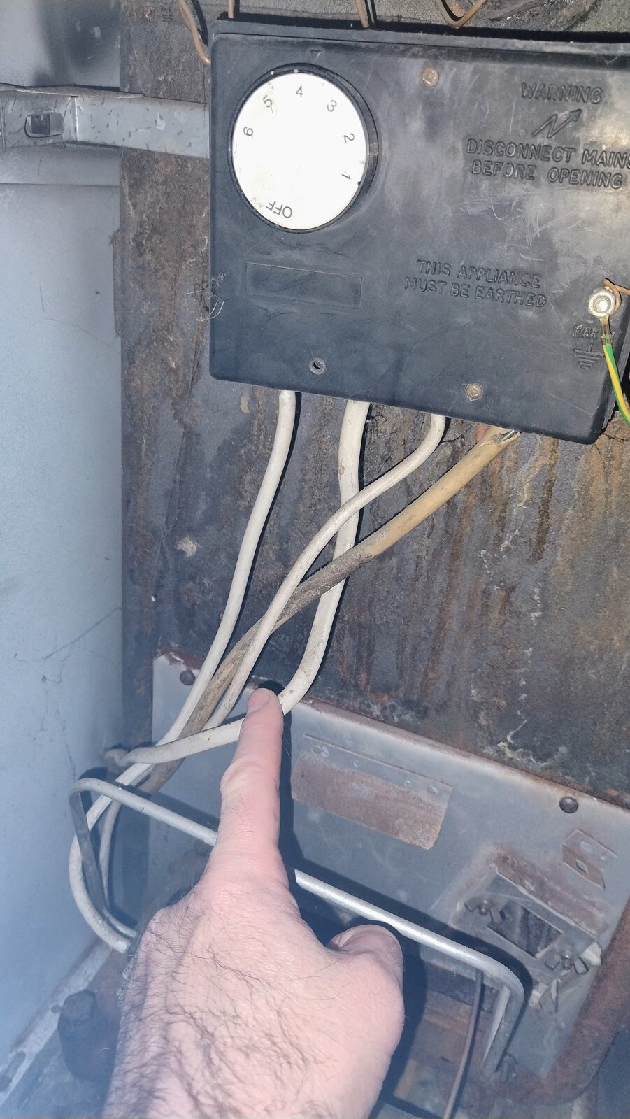

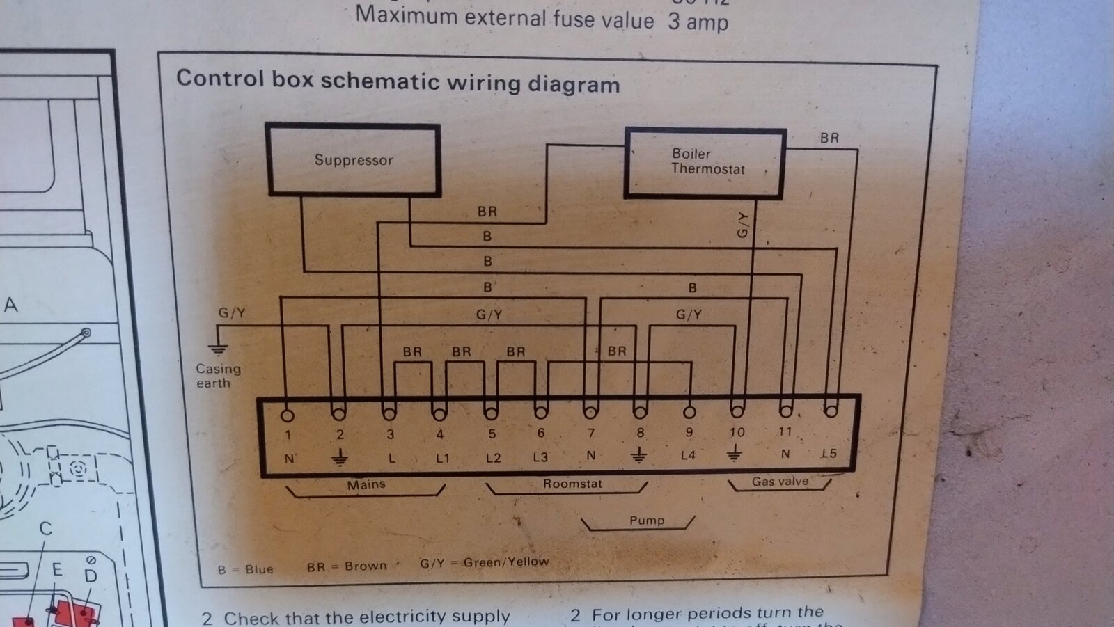

The cable for the pump goes into the boiler, disappears but I think it comes back up the front and into the box where the temp dial is, second from left.

Ok the thermostat box is where the pump gets voltage from,but you still need to establish if it's getting voltage when it doesn't run. A non contact voltage sensor would at least give an indication ,although it wouldn't of course tell you if the neutral was intact.
Show us a pic of wiring connections inside pump.

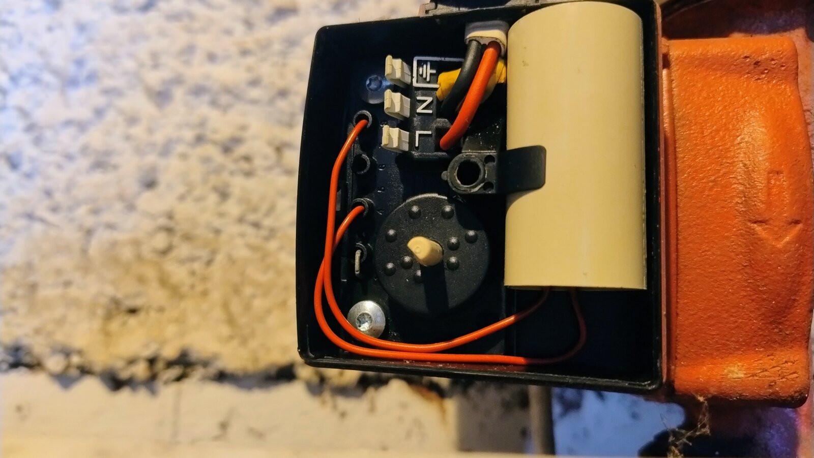

Ok, had to wait in for a delivery yesterday so didn't get a chance to go to mum's.
Here's the wiring inside the pump. Couldn't find my thinner probes, no idea where they are.
Wiring appears ok, apart from the earth/CPC, but afaik shouldn't really affect it running.
Get two short pieces of insulated cable, and two insulated connector blocks,turn mains power off. Release the live and neutral conductors from the pump, put them into separate connectors and add the short lengths into the pump. You can then test on the connector blocks terminals.
