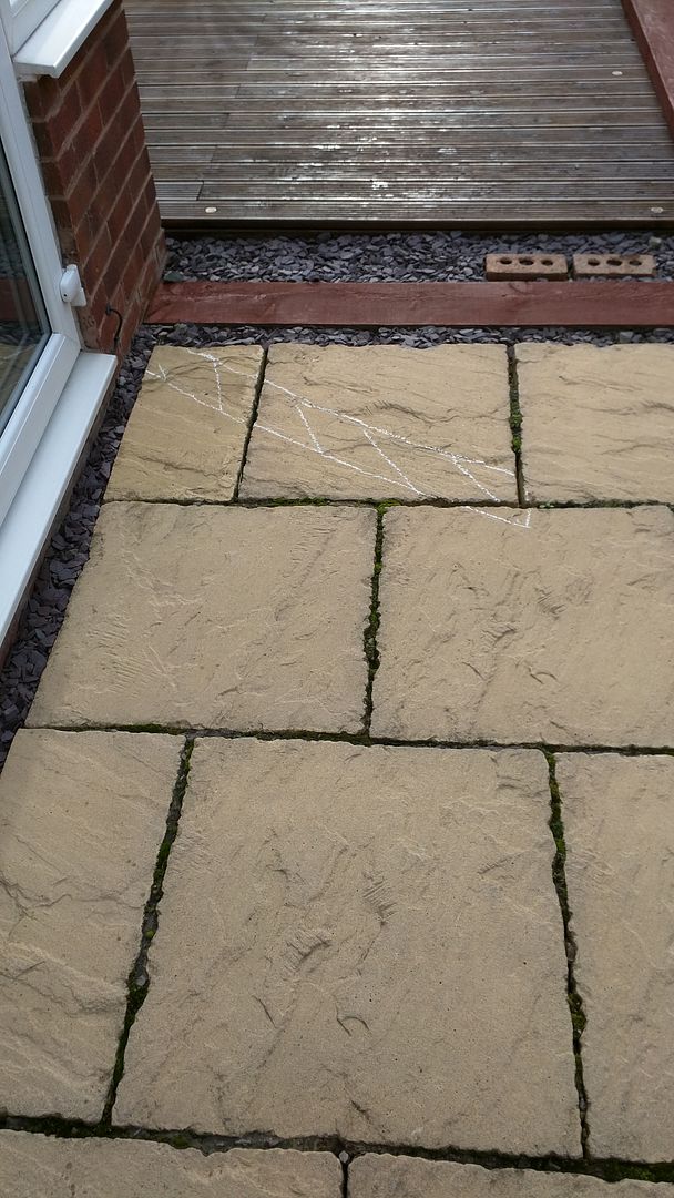

Got another question please, before i place a small log cabin 3 x 2.3m log cabin near to where the extension will hopefully go in the future, i want to make sure we can fit a T piece fitting into the existing clay pipe running through my garden from the neighbours house, this is 1 of 3 that links to a man hole cover in my garden.
So here is a picture from when i dug the foundation for the conservatory to show the angle of the clay soil pipe leading of to the neighbours house.
This is the area in chalk where the clay pipe is currently lying, from left (conservatory side) and it needs to end where the right chalk line stops as this is where the log cabin room will be sitting, do you think there is a enough room to fit a t-piece 2 some small pipe to each end then the 2 flexi adaptors in or can anyone see a problem i think it might just about be ok to work round the length is measuring 900 mm.
Thanks for your time
Anyone Could do with reassurance before the Cabin is coming next week, can anyone see a problem here before the cabiin is set down on the slabs and it been to late , would not want to remove cabin in the future to install the toilet waste once its all built. Cant really lay the cabin any where else but here.
Thanks you
If you are planning on joining in a WC to that existing sewer, I think you will need to install a chamber there, the B.C.O. may not allow a junction. Drains, (particularly from a WC), must run in a straight line, although bends are permitted immediately outside a manhole. Not entirely sure what you're hoping to put in, but
All drain runs need to be accessible for rodding in the event of a blockage.
Right mmmmmm, it will be a shower room and toilet 3 meteres away this could be tricky iam not to sure how big the chamber is i get to install if the is the case.
Thanks for info
Thanks for info
Could someone link me a picture to one of these chambers please so i can measure up thank you
How deep is the existing drain? 250mm diameter chamber can be used up to 600mm deep, 300 for max 900mm deep, up to 3m deep you need the 500mm chamber.
If i remember correctly its no more than 1000 mm deep 110 claypipe. thanks for the quick response.
I think i am buggered if i got 900 mm length to play between conervatory and log house with the 500 mm chamber needed then the 300 -600 mm rocker pipes each side it will not fit.
Can the rockers be slightly smaller than 300 or is this a rule that should be followed?
