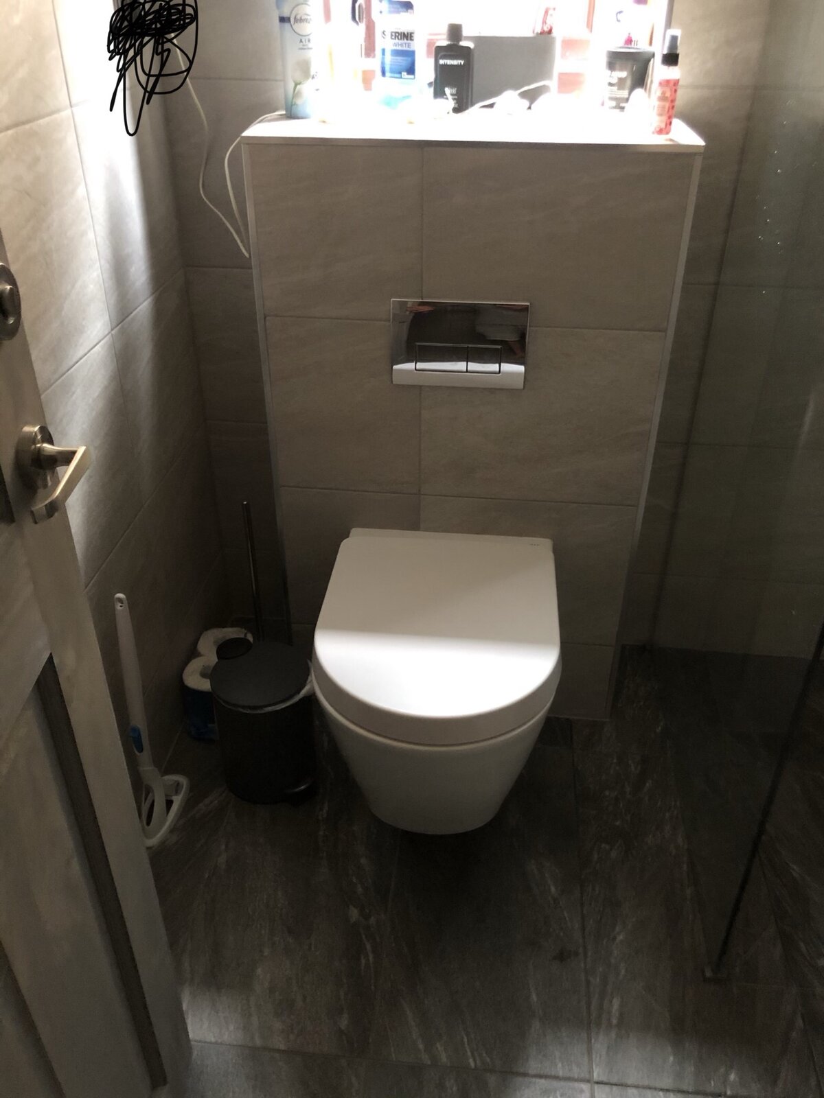

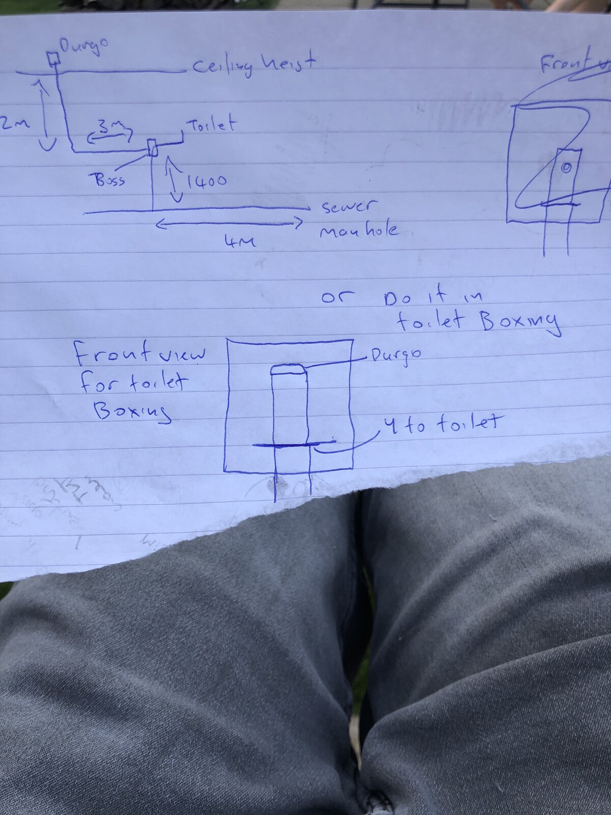

is there enough ventilation in a boxed in floating toilet frame for the durgo which would be through the floor boards only. I could probably add a hatch to access it As this would be the rodding point, if not it’s going to be a good distance away to use for rodding.
Ventilation- probably tho you may need to put an air vent in the floorboards. Not a fan of durgos tbh.
Rodding point- what are you going to rod with a transition from vertical to horizontal & then vertical and then hit the bottom of your interesting connection?
Good point. I guess just that section of pipe.
The horizontal section can be rodded from the man hole 4m away I guess.
my builder just told me they are happy with everything he just told me I need a rodding point under the floor.
There would be no floor boards where the boxing is it would be a big hole 250mm by 800mm pretty much.
My rods won't go round a 90 degree bend, unless i've misunderstood yr layout you'll have an inaccessible section in there. Rodding point in the floor in your wetroom is going to look attractive....

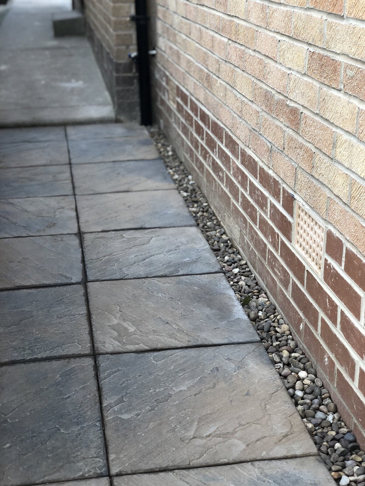

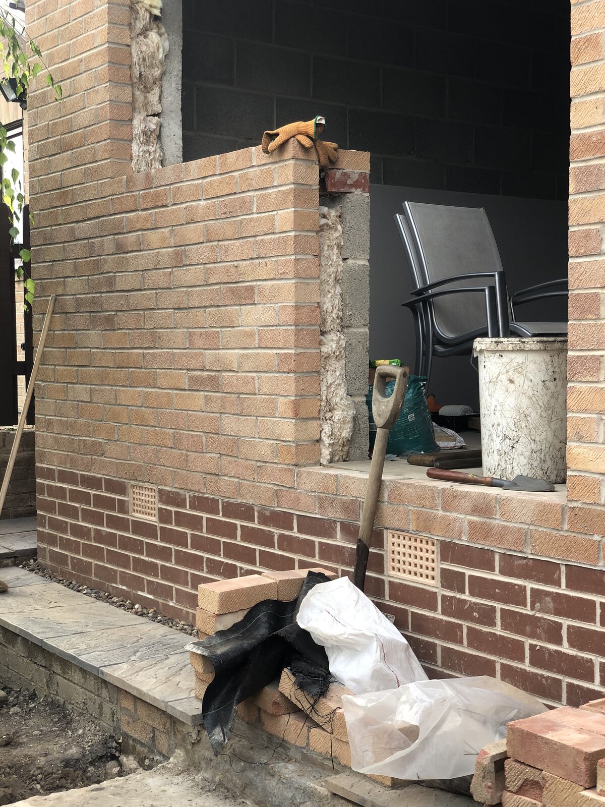

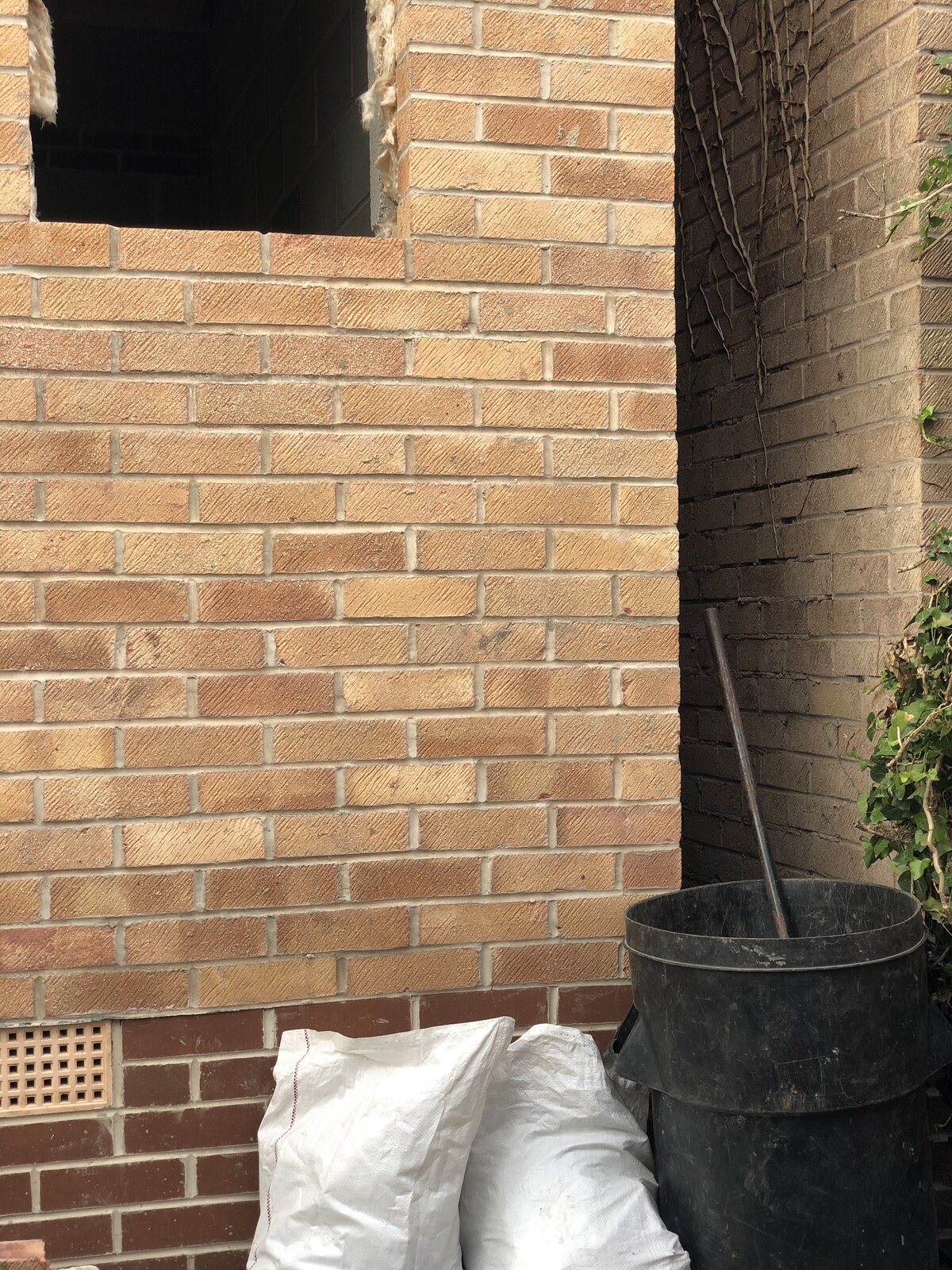

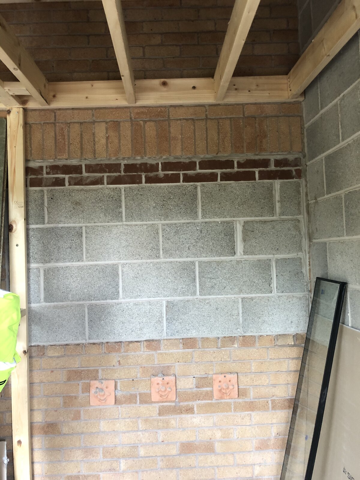

Let’s say I wanted to put in a 100mm to my sewer which drops under the floor void through the lower bricks in my extension and into the side of the man hole from the pics how hard of a job is that, I’ve about 300mm from finished floor to top of man hole cover, how for down into that does it need to penetrate.
Man hole is under the tiles (liftable) on the pic of side of house.
and finally. From my pics I’ve put up two ways for my durgo to fit, on each one where would I put a rodding point. I’m told it has to be under the floor which is fine but getting to it would mean laminate up in the next room.
Pics are best I can do really hope they help.

Your straight vertical drop into a clay pipe is iffy- as others, you'll get solids splattering, separating from the water and potentially building up a restriction or blockage. Situation will be improved if the shower, basin etc use the same vertical drop but it is still iffy.
Usual deal when entering an existing manhole is your new pipe must be at invert level (ie bottom of new pipe level with bottom channel in manhole). On new placcie manholes the side entries tend to be 50mm above invert, if you had one of them then obvs you go for the side entries.
So with your sketch you'd be sensible having your drop from the bog hitting a rest bend then onwards to your manhole. You've still got an unroddable vertical from loo to rest bend...a manhole under the patio is tolerable as long as the slabs are loose laid (do yourself/future owners a favour, write the measurements for manhole position down, laminate them & hang them from the stop tap), rodding point under a laminate floor (which would take a certain amount of effort and potentially damage) isn't really on.
No idea about the durgo, don't like them, never used them

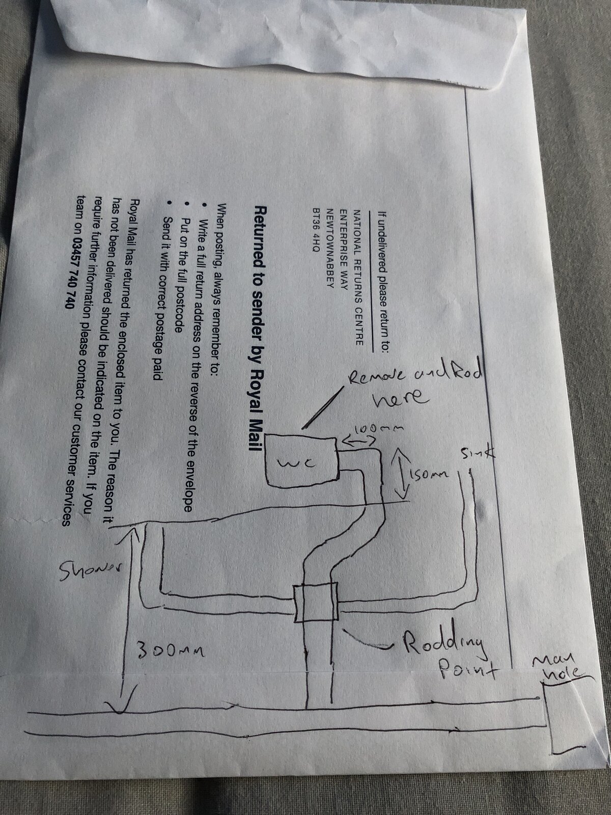

Hi thanks for the quick reply. Just looked at the regs and couldn’t see any note on having have to have a sweep into the sewer (I’ll be happily proven wrong I can read regs ok but these aren’t in my trade)
I understand the issue with the drop and possible build up to be honest given it’s a downstairs toilet and shower it’s not going to get used for the lumpy stuff, it’s mostly for the shower so it will get flushed out down there, I’d happily take the risk as
changing the waste pipe is not something I’m keen on doing it seems like a massive job, and either way it’s all done under the floor space which will make digging down very tricky if I have to get low down in the man hole.
I’m just confused as to where I should put a rodding point I mean as far as I’m aware there isn’t one upstairs and if there is it’s definitely underneath tile.
As I’ve no idea how a rod works is it not possible for me to remove the toilet and rod that way too the bottom of the clay then rod horizontally from the man hole, I mean if needed.
On this pic if I fit a rodding point where the sink and shower connect (if that’s possible) then it’s there to unblock the vertical pipe but Ye I’d have to lift my laminate.
with the man hole luckily there is one direct beside it on the neighbours path so hopefully my tiles shouldn’t need to come up but it’s a risk I don’t mind taking given they only cost a few quid.
Aah, if your loo is reasonably easy to detach (couple of wingnuts or whatever) then that'll give you the best shot at clearing the vertical if you need to (i'd assumed it being floating meant some monster job to move it).
Drain rods are moderately flexible- they'll just about work on a 45 degree bend (though can be tricky getting them out if you rodded through a 45 degree junction). If you can rod that clay run from yr manhole and the vertical by derigging the bog then go for it, digging drains from under the floor won't be fun. Do check (soon as poss) that you know which manhole serves that run- stick that on yr laminate as well.
