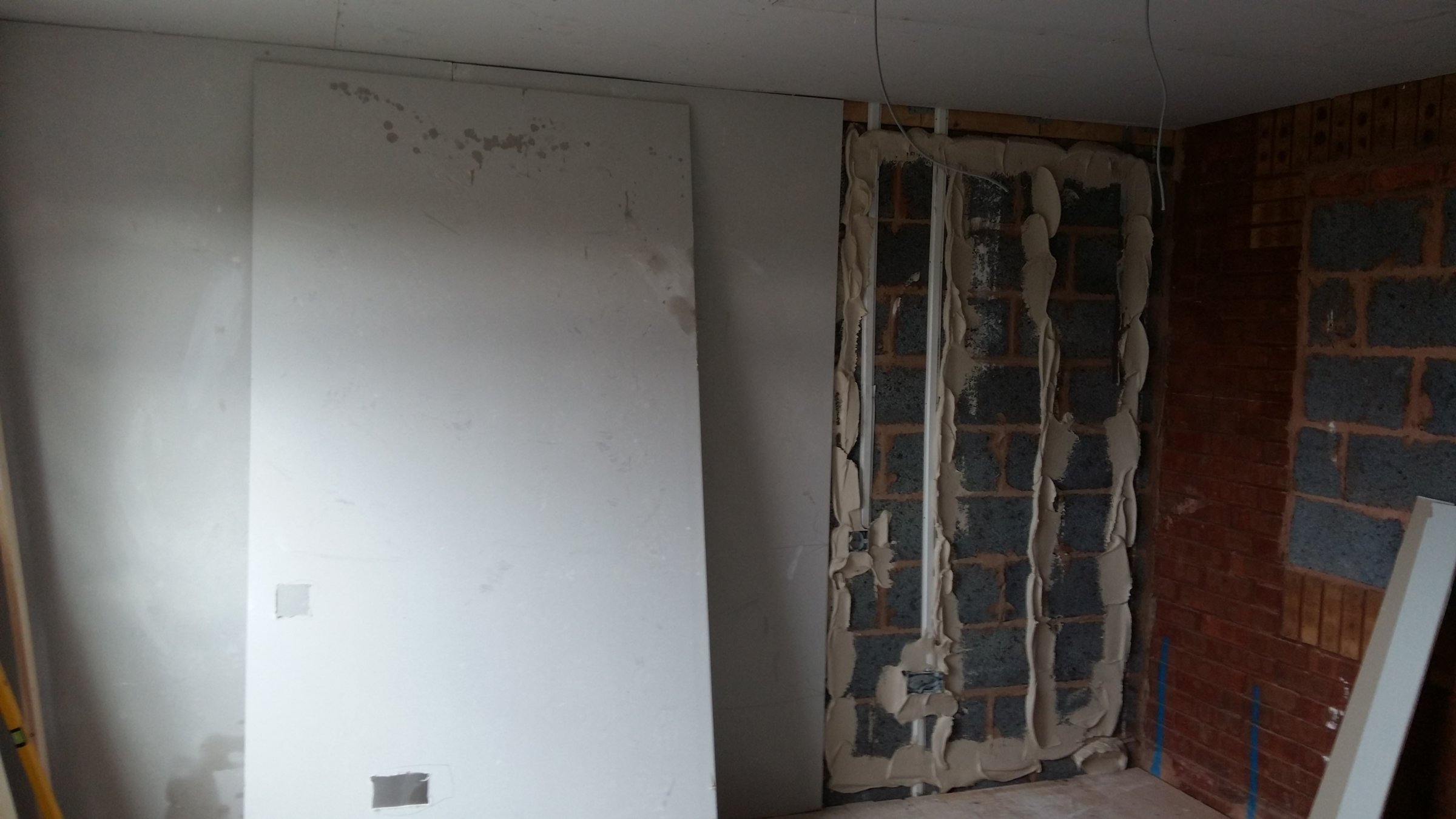

A lot of it is down to misunderstanding how one should go about fixing the boards and preventing air movement. Here is how we do ours, solid bead around the perimeter plus solid dabs around switches etc......
Hi, thanks for the pics. I agree that this method is much better than the way mine has been done! Any idea how I can fix mine or if I even need to? I could seal around the holes and live with the switches being a bit cooler as not much air gets through them. However, could this potentially cause inefficiency in keeping the room warm in winter if the walls are cold? I guess there is also the potential issue of damp but the rooms have trickle vents and VELUX Windows that open the vents a few times a day so should be pretty good for ventilation.

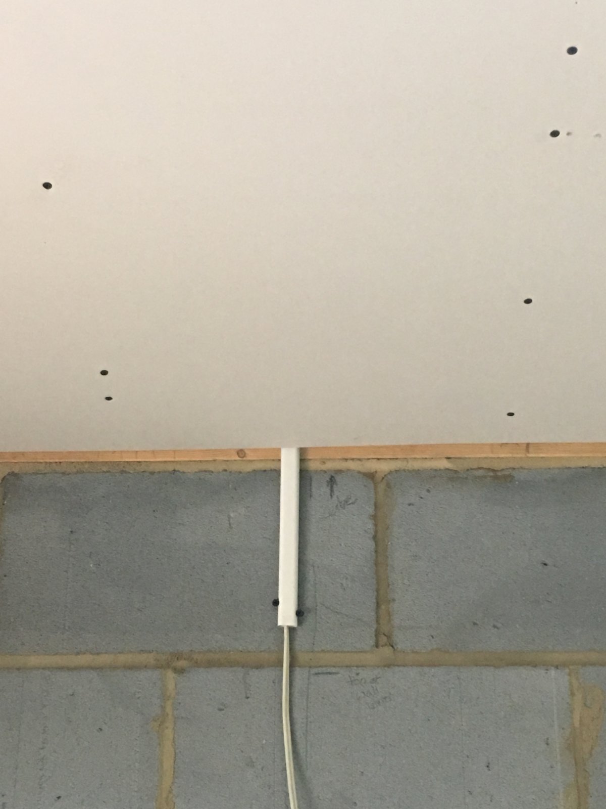

You could try drilling a 10mm hole every 100mm around the top of the walls and inject expanding foam.

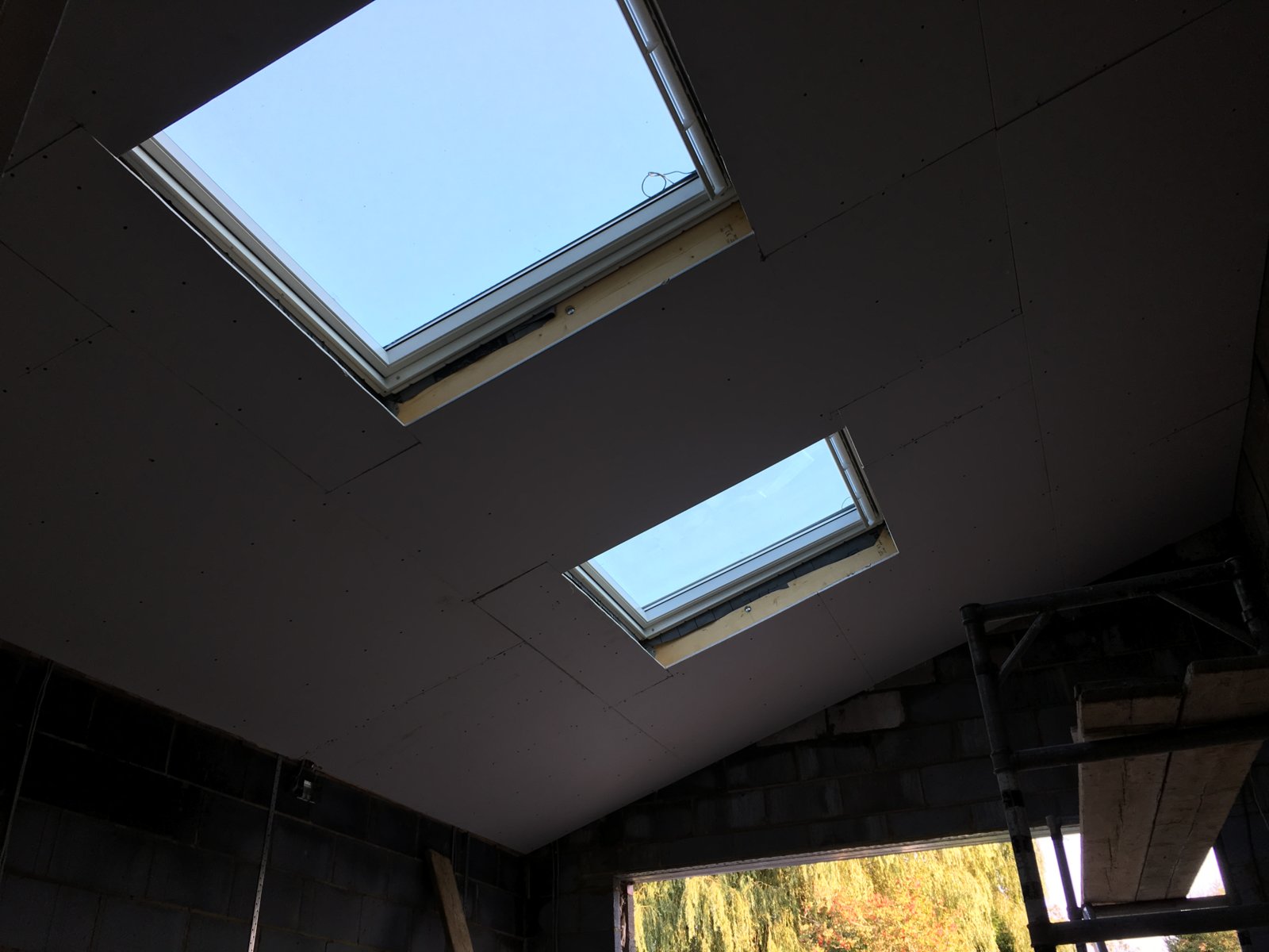

The air barrier should be more or less continuous and there should be minimal air movement between it and the insulation layer to prevent thermal bypass.
You can block the holes in the plasterboard but the plasterboard isn't the air barrier, as the insulation is no use floating in the wind. Google plasterboard tent.

Thanks for the tip. Useful information and brings up a lot more on the issue. I think I will try to seal the holes behind the plasterboard that I know about (waste pipe through wall, cables coming through insulation at edge of wall/sealing) and see how that goes. If it’s still petty drafts in the wind then I may try the expanding foam through holes near the top of the walls as I know that the ceiling insulation doesn’t go right up to the wall and is probably an issue. If the draft is reduced to almost nothing then I guess that would be acceptable and I could then seal up the holes in the plasterboard. I assume that it’s unrealistic to expect a dot and dab wall to be 100% draft free unless it’s properly sealed at all sides. That’s not really possible now. Wish I knew about this before they boarded so I could spot it! :(

Added a couple of images to show the boarding on the ceiling before the walls were done. Could have foamed up the edges if I had known about the draft issues
