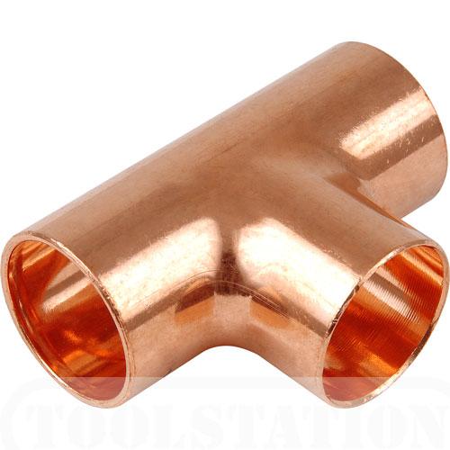

morning chaps. i'm trying to source one of those central heating drain cocks that is plumbed into the middle of a 15mm pipe. have looked but can't find one (b&q, screwfix etc). don't want to fit a self-tapping one or valve with drain cock. anybody help please.
one of these
View media item 14822
and one of these :idea:
Honda,
Use one of these then, the drain off Kev showed can also be soldered in, just take the rubber washer out first.
Rico
thanks for replies, looks like i'll be using a soldered T plus valve as suggested.
Yeah most diyers have a blow lamp, flux, solder and a heat mat
