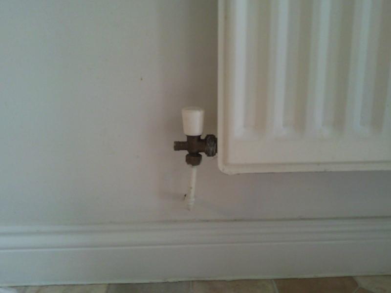

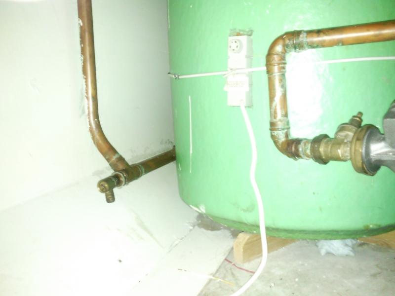

Thanks for that, I appear to have hit a new problem. I cant find a drain cock on the downstairs rads. There is on on the hot water cylinder
Below shows 2 of the 3 downstairs rads and the hot water cylinder (with its drain cock).
Any suggestions oh now to drain this down? Thanks in anticipation.
Bumping back up.
Any advice please as this has got me stuck and I reckon I might me missing something obvious
If I cant find the drain tap is it possible to fit one to the rad nearest the back door (and so easiest to drain from)? Its the middle of the 3 photos above
